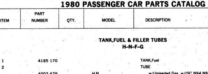

I looked in my ’80 parts manual. The fuel tank is the same for all ’80 F-body (H and N carlines) and M-body (F and G carlines) – no matter of engine size or doors on car.

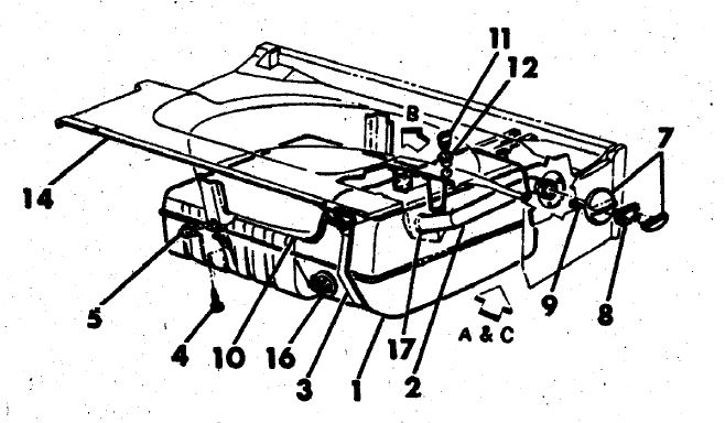

The picture shows the hump style tank - so guess they were too lazy to change the picture?

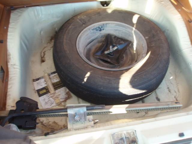

The Hump style tanks will only fit cars with round spare tire trunks (like my ’77 wagon, which was built November ’76).

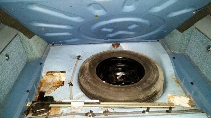

This is a picture of Ole Yellows '78 Aspen wagon (typical of all FMJ's built after mid-year '77)
A lot more trunk space! This vehicle will have the flat fuel tank in it.
