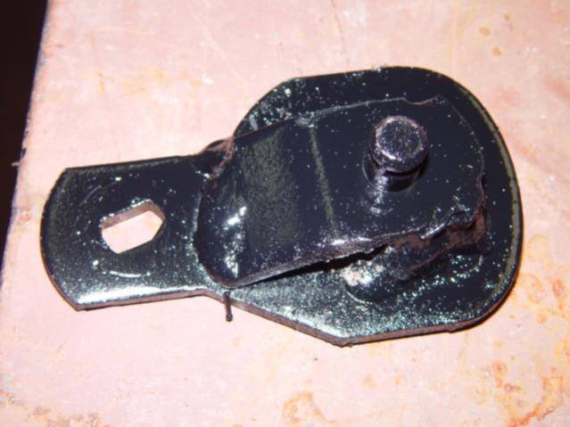

The best way to repair these systems is to remove the plastic bushing. Get the arm from a pre-intermittent wipers motor, cut it and weld to the intermittent arm with the large hole. Presto! Better than new.

Mr C -- what am I looking at here? I'm a little confused!

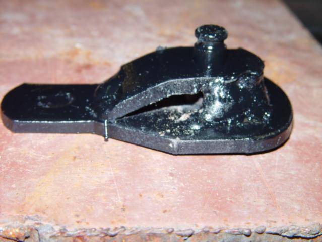

What you are seeing is an older 2 or 3 speed link cut and welded to the "large hole" link used on intermittent wiper cars. Eliminates the plastic link that eventually fails. You cannot just use the older link because it does not have the right offset and will bind with the intermittent motor, and it is not keyed properly to fit the intermittent motor, so it needs to be trimmed to simulate the profile of the plastic piece.
Below is a pick of the 2 or 3 speed link before cutting as well as the "large Hole" link still on a wiper motor with the plastic link attached.
The link as shown works perfectly on the 78 C body, I've never done this on a B, R, F, M, or J, body so other mods may be needed.
