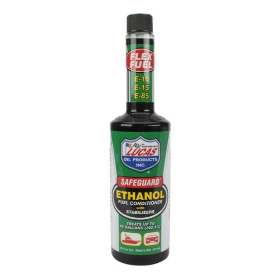

I had three bad instances with the ethanol they add to the gas. Seems if you let your old ride sit for a while the gas evaporates and leaves behind a sticky corn mess. My Shebly Dakota died twice on me. My Aspen wouldn't start because the needle valve underneath the shooter got stuck closed. And just lately I could not start the Gran Fury. Stuck float valve was the culprit. All issues have been resolved now and won't return. I use Lucas Oil Product's Safeguard Ethanol Fuel Conditioner. One 16oz bottle treats up to 80 gallons of gas.

Visit www.pure-gas.org to find out what stations in your area have non ethanol gasoline. I am fortunate to live close to a station that has 89 octane non-eth. I fill my 5 gal with it for all of my OPE and mini bikes. As soon as I fix the fuel sender in my Mirada, she will get her first tank from there. In a pinch, the Lucas product mentioned at the beginning of the thread is supposed to work good. I usually just use a bottle of SeaFoam myself. In my spare time, I'm a small engine builder, and have made a lot of $$$ repairing ethanol damage.
