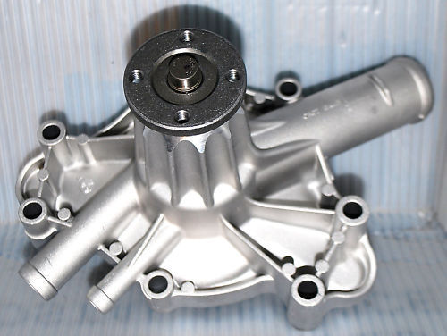

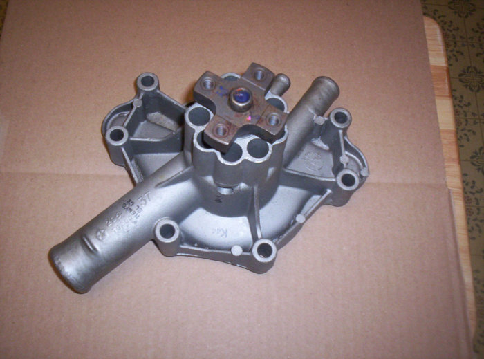

I do recommend getting a pump that does not have the several holes in the front snout.
The version that looks like the holes were cut off somewhat, actually have larger bearings in them. At one time, they were considered to be a “police/taxi” unit, but later in the years all went to the newer style.
The police style is a much preferred piece.
