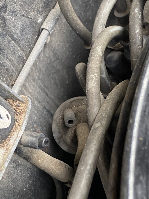

I’ve got these two missing towards the back right on the firewall and the air pump doesn’t have a belt on its pulley

3,787
1,151
Greaseball --
Not to be sarcastic, but the search button/link in the upper right corner is your friend here as well.
Here is one example of several I found when I searched "vacuum diagram"
Rough idle...
I'm sure there is (back through the forum history) a vacuum diagram in the forums for each of the cars (volare, aspen, new yorker, fifth avenue, diplomat, etc) and no doubt many of the years.
But the best way to go is the service manual. I bought one before I started rehab on my mother-in-laws car and its been very helpful.
