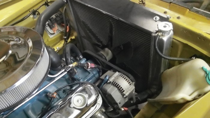

    I'm running a fan of unknown origin with a thermostatic viscous clutch. Probably doesn't really answer your question. Why is, it's the fan blade I've had on the car since 1989 and is most likely the one that came with the engine(?). Clutch is a new aftermarket unit.
    This is a pic from when I was building the car showing the fan I'm using.

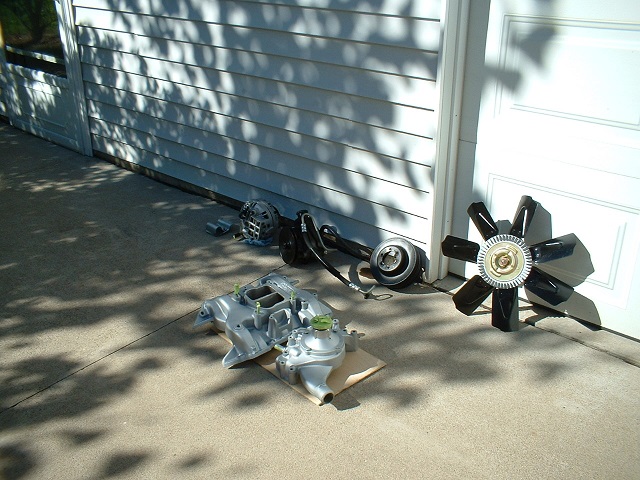

    7 Blade fan and clutch for AAR Cuda. This looks identical to the 440

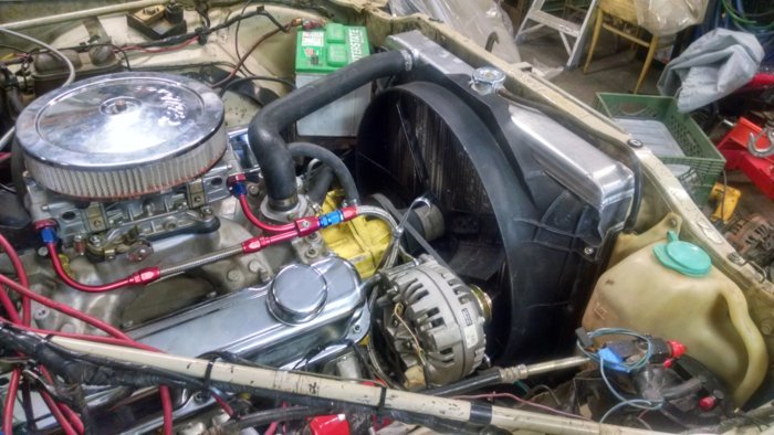

    mopar factory steel flex... works for me on both 360's.
    surprisingly the demon doesnt need a shroud to run cool, even on a 110* day in traffic.

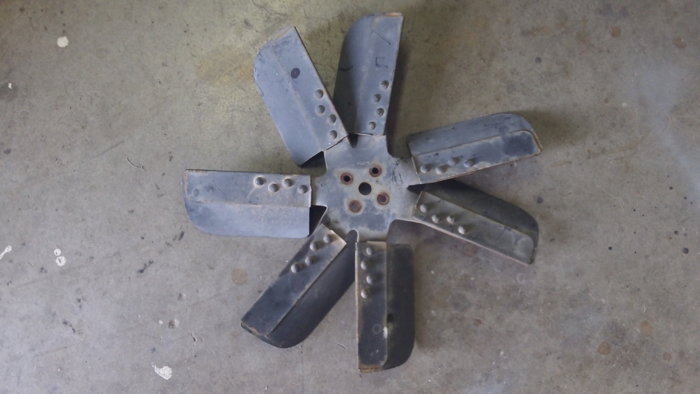

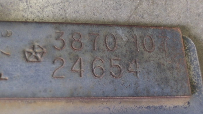

    77 parts book 3462190 5 blade flex blade 20 inch V8
    3462186 7 blade flex blade 20 inch V8
    3870107 is a 18 inch slant six blade in 77
    my question does the 20 incher fit the factory fan shroud on the smaller radiators?? I guess not?

    No, it does not.

    Take a good look; I think I see a thermostatic spring on the front there. That's the best set-up.
    A hot-rodder might not need the best , it depends on the combo, the use, the rest of the powertrain, But if you want or need the best this is it; 7 blades, all steel, and the T-clutch

    Yes, that is a thermostatic spring on the clutch. Pretty sure I got the clutch from Rock Auto (or it could have been Summit) to replace the OEM one I had on the car previously. It was shot and loose. Basically was free wheeling all the time.
    Must work, the only time the temp gauge ever gets to half scale (stock gauge) is if it's 90 degrees, the A/C is on MAX and I'm going up the VERY steep hill (35 mph speed limit) on Foxglove Road, on the way home from work.
