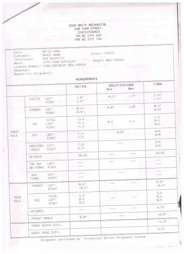

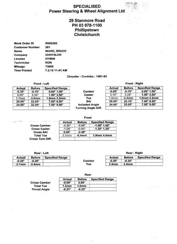

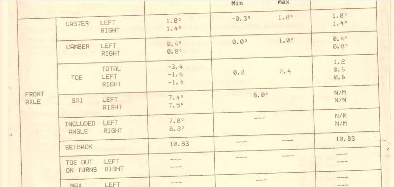

Hi Guys,
I have been talking in another discussion about my wheel alignment, the SAI on my car is at 25 degrees, spec is 8 degrees, I am unsure if my car is really out or it is just the way the machines measure SAI on our cars, anyone had a wheel alignment done lately and would like to post the print out of their alignment?
Thanks
Bruce
