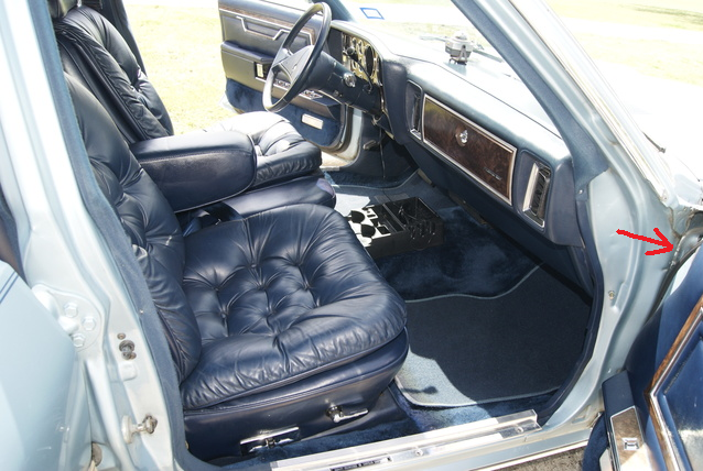

Do you have the factory seam filler tape over the A-pillar/cowl/firewall in the front door jams like the F and M bodies do? Sometimes that stuff dries out, cracks, and the water slips in to the footwell. I've had to chip it all out and replaced it with a good RTV before.

I will go investigate, and see what the condition of the present filler is. I have been avoiding getting it wet in the desire to have the interior dry out.. but once it is dry, maybe a trip to the car wash will be informative?

Could be. Just remember the water moves differently when you're driving down the road vs sitting still. Trying to simulate the right angles and pressures is sometimes rough.
