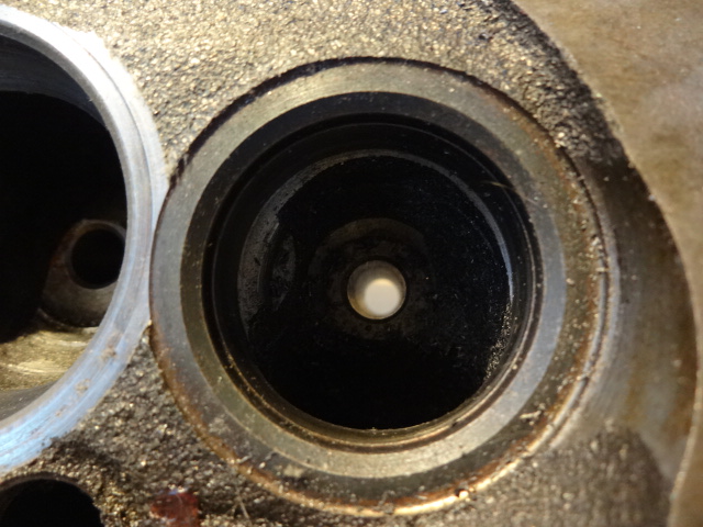

See the factory insert here.
So back to my original question, Did the passenger car roller cam heads have hardened seat inserts in them? Id guess not at this point and also why the truck head is not approved for NHRA stock.

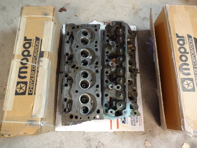

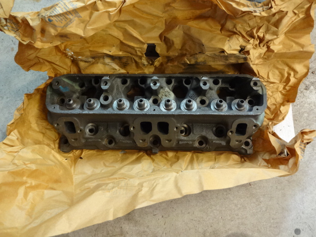

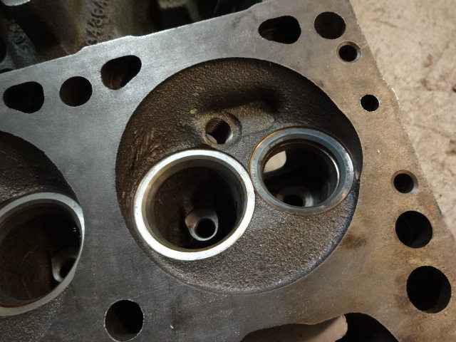

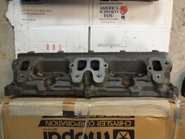

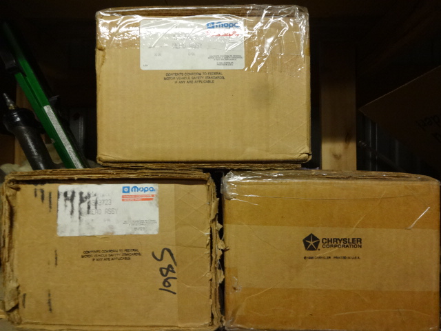

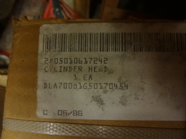

Ok, to clear the insert issue up and try not to sound like a smartass , these are from the box mopar heads with the seat inserts, they are HD truck heads. Mostly used by the army. So I know what mine are, I just wondered if the 85 pass cars had the inserts but if id of thought ahead id of known they had the induction hardened type. Ive still another 3 sets of these sealed in the boxes.

I was wondering, can you get me the part numbers on those boxes, please?

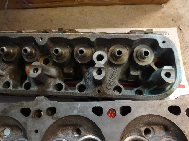

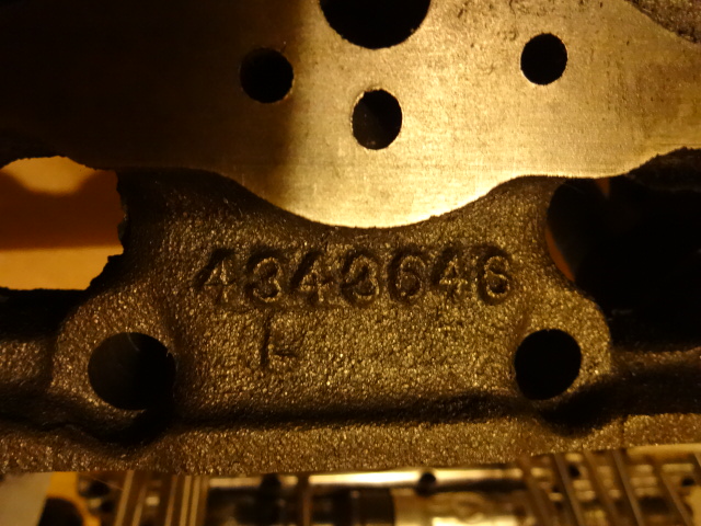

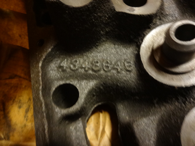

I will get the pn Bud, but you can see the casting number, they are HD 318 truck heads that have the same port config as a 302 head and come in both std or roller cam version for the larger diameter pushrod hole RC pushrod angle with the rasied lifter.
4343723 85-91 318

Im gonna do some actual chamber work but I just put a set of 1.88 intakes and left the 1.50 exhaust and filled them with costly stainless steel valves. (hard to find 1.88 stainless 3/8 stem intakes and hard to find the 1.50 ex because of low demand) I was able to machine cut the bowls and then finish them off by hand to mimic a 1.88 J head bowl/throat and used the pinch area to get the csa I was shooting for and to control the velocity there vs the throat.

I recall seeing them in the Army with the inserts and never thought different because most HD and industrial heads that pull a load have inserts for longevity.

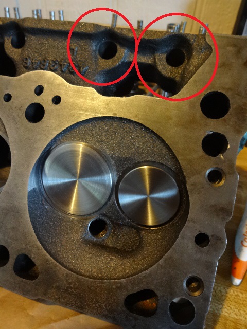

You can see in the pics above the larger diameter pushrod holes vs the set in my pic below with the smaller std oem size. And still both heads with the same PN and casting number, one early military use, one later.

The military tag below is the first pic, also showing more pics of same casting with diff pushrod hole diameters.

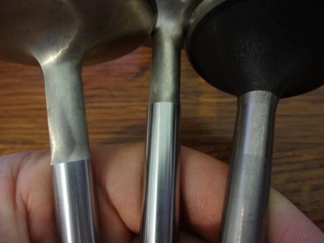

Pardon me for my small block ignorance here but. why didn't you use a valve with a standard stem that is reduced between the head and guide.
I'm not aware of the difference in friction generated between the two diameters or weight but if cheap is what your after you could cut down the larger size also?

You mean like the two on the left vs the oem full 3/8 stem on the right?
I had thought about cutting some down but not sure if you knew or not, im losing the ability to stand/walk so when I can stand and walk I need to use my time wisely. I cant sit at my lathe I got to stand to do things.
All in all over weight of the SS intake and exhaust is 5 grams less then if I kept the oem1.77/1.50 in the picture and 5 grams heavier with the oem 1.88 and 1.50 combo.
Like I mentioned in the PM the other night if I really wanted to go big I would of pressed in 3/32 or 8mm guides and used cheaper valves. But im only willing to go so far on this deal here.
