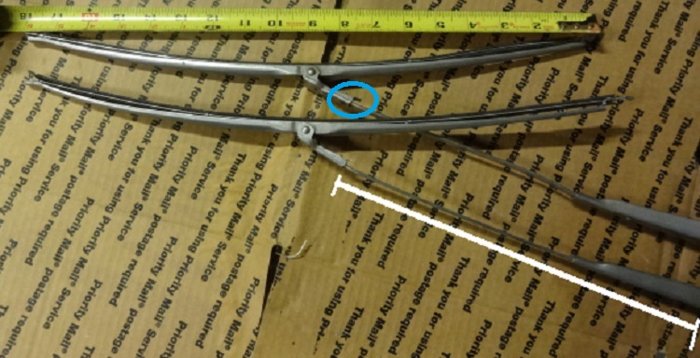

XbodyX, any luck on getting the wipers blades out? If not i will buy the blades and arms you have in the pic.
I liiked more at the ones in the pics I posted, I need to match some up. If you look close, although they both say trico, they are a bit different.
To clear up confusion.
Part A is the wiper arm (white line) which is the part that attaches to wiper pivot to the wiper blade.
Part B is the wiper blade (the metal and the rubber parts combined – part where tape measure is measuring). The blade pivots on the wiper arm and normally there is a "quick disconnect" (blue circle) to the arm (which may or might not be "quick").
Part C is the rubber refill for the wiper blade (part B).

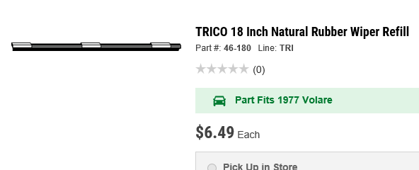

If you currently have nice and complete set wiper arms and blades, it is best to only replace the wiper refills when needed. Most part stores will want you to purchase the more expensive wiper blades – which might be OK for the newer cars or might be OK for winter blades (for those who drive during the winter time) – but even then, just replacing the wiper refills take almost as long (as blade replacement) and are so much cheaper.
The only down side is one will need to look at part stores web site to get the (correct) part numbers first.
9 times (out of 10) the parts counter person will want you to upgrade to wiper blades – don’t fall for it (unless you have lots of extra cash on you). The above part number came from O'reilly Auto parts website, and is part number 46-180 (Trico)
All FMJ vehicles use 18” long blades. A person can get wider blades to fit – but the 18’s have a hard-enough time working with the curvature of the windshield.

Ok, I will be at that shop this weekend and will grab them, is the PM on the item in your pic, I recall #s but not sure what they were.
The numbers on the blade don`t have to match as long as it looks similar. The number stamped on mine is 3056160 CAN 63

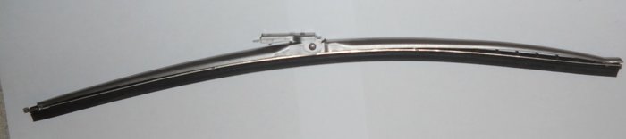

OK, I got a good used blade off ebay for $15 shipped that matches the NOS one exactly. I believe this blade fits some Ford and GM too. The part number(not a mopar #) on the blade is 3056160 CAN 63. The NOS blade can be expensive too since they are a one or two year only corvette wiper blade. PS. If you do try and get some make sure the blade is 18" since some seem to be the smaller blade with some of the same part numbers.
