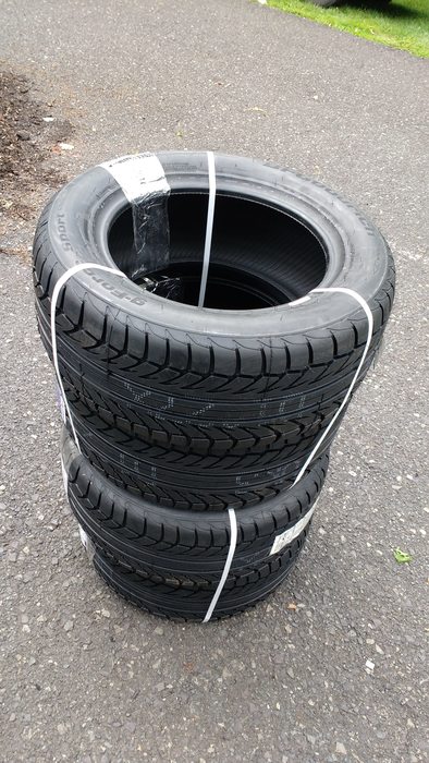

It looks by the sidewall of that stack of tires they are 15s, right?

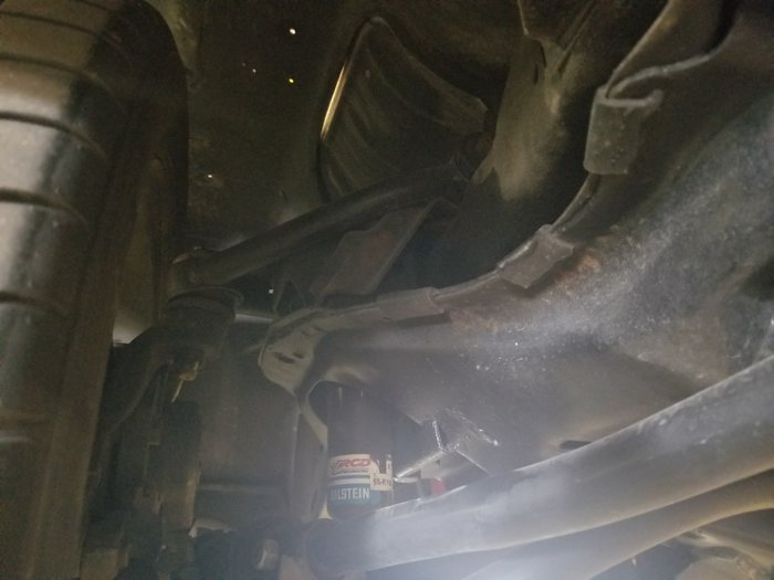

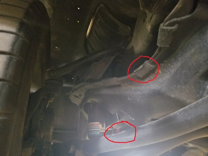

Is this the clearance on your 255 up front? ...
I see that Firmfeel upper control arm. But it doesn't look like a requirement for fit. Even at a tighter 16"diameter... but I might go that route just for the additional caster.

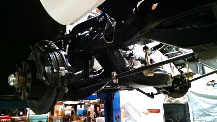

Yeah, these are the two areas. I know you don't want to with a $6k front suspension conversion, but if running wider tires is that important a conversion would get ride of these obstructions.
Front rim is a VN515 18x8 with 4.5" of backspace and the rear is a VN515 18x9 with 5" of backspace.

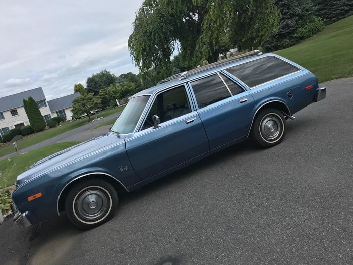

back in post #1 when you first posed the question, and also posted the pic of the Volare wagon,and then said "I promise I'll post pictures when I get these weapons under the wagon on some deep steelies"; I guess I was wrong to assume the question pertained to the Volare?

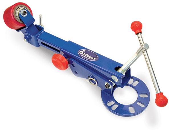

Aha. So with 4" backspacing it sounds like my biggest concern up front will be not with suspension contact (maybe even giving me the room I need for that more aggressive camber) but out at the fender lip to the tune of 1/2 inch or more. Maybe this calls for a different strategy...

That is correct. My current victi.. er.. project is the Volare wagon.

I don't know about rolling the fender lip....might work. I wonder if you could get fender flares that would both fit and look cool. That would give you plenty of room and even Mad Max kind of look. I think it would be bad ass.

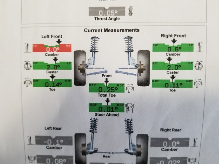

Here are the specs I just had my front end aligned to.

Good stuff. Did you run out of slot for further camber adjustment or chose not to run any more?
1,834
1,040
Could put more caster into it if I wanted. The FF upper arms are longer than factory to give even more adjustment if wanted. My primary concern right now was for it not to eat tires. I'm not doing any autox with or the like at this time. Still need to do something with the factory brakes before I start thrashing up parking lots.
