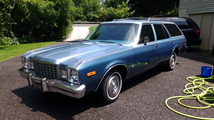

That is correct. My current victi.. er.. project is the Volare wagon.

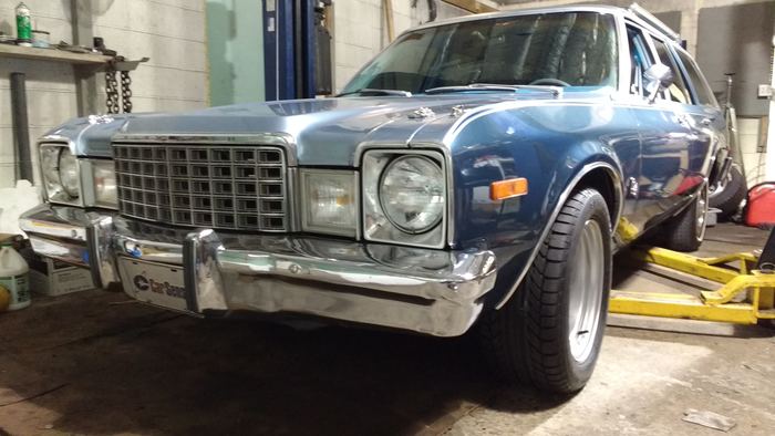

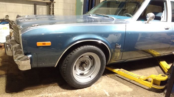

TEST FIT TIME!

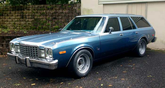

Stock stance for reference...
New Hotness

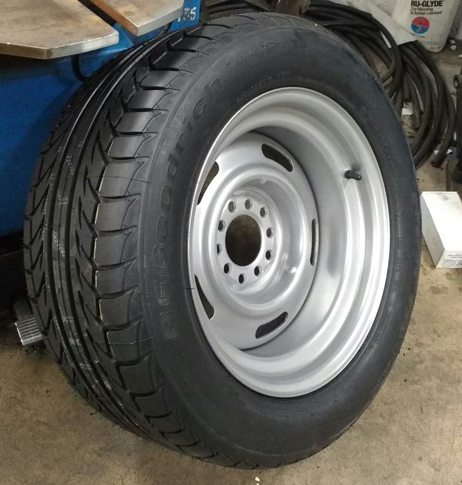

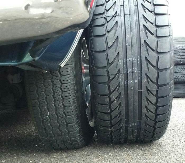

255/50R16 BFG Gforce Sport Comp2 (2% larger diameter than stock)
Note: Stockton Wheel Service will custom build you a set of 16x8s Mopar 6 slot cop wheels in my spec for $280ea. But I went with the $115 in-stock option.
16x8 Wheel Vintiques Chevy Rallys with 4" Backspacing...
VS the stock 195/75R14 pizza cutters...

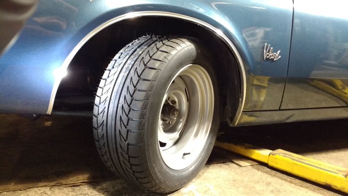

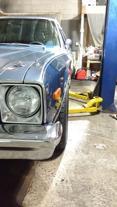

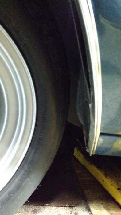

Closest clearance point at full lock anywhere around the wheel...
Inside clearance...
With bigboy (300lbs) jumping on the corner of the bumper you can just about make the inside edge of the chrome trim kiss the tire shoulder at full lock. I'll probably roll it for safety. Especially if I go lower (even on stronger bars).

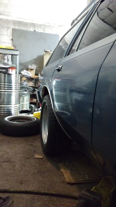

Flush fitment. I win at wheel maths. Again...
And the same wheel/tire size on the rear...
Results of my initial maths...

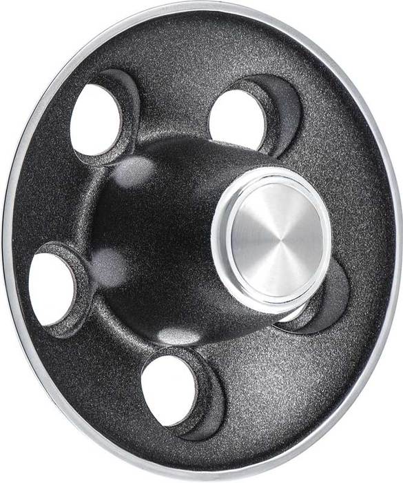

Still waiting for the rest of the wheels (only ordered 2 in that backspacing in case I had to go staggered). Center cap could be either...
1) a 5x4.5" pattern Mopar Rally centercap fastened to the extra holes in the unilug pattern. It appears the overall diameter is about right but I'm unsure if the depth it close enough to mesh with the GM rally design. I like this idea because it's a known Mopar element and shows the lugs nuts.
or 2) A moparized GM derby cap. Starting with a blank base...
Still unsure about rings and level of chrome content. Gotta feel it out as I reduce the level of brightwork on the car.

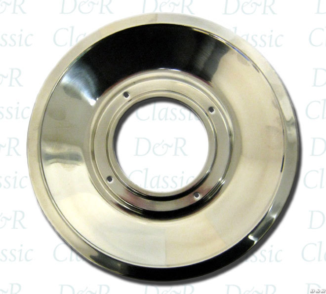

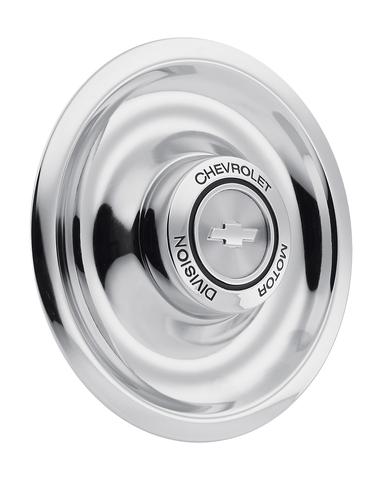

BTW, I currently have 15" chromed "Chevy" rallye wheels with the last cap you you pictured. I haven't yet figured out what the 4 holes are for... they look like a place for an emblem, but I haven't found anything to fit. If you can make the Mopar centers work I'd be most grateful for a picture or two. I think that'd be a good look.

Those blank Chevy caps are from the late 50s from what I can tell. They had interchangeable medallions to bolt on that made them look like this...
Not sure what I'd make for a Mopar one but I'd probably find some old Plymouth spear emblems to adapt to it.
