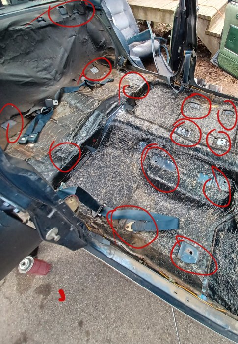

Make sure you grab all of the seat bolt/washers off the new seats. The hardest ones to undo will be on the passenger side by the exhaust. Driver's side is easy.
And take pictures so you know where to look for the seat holes on your car.

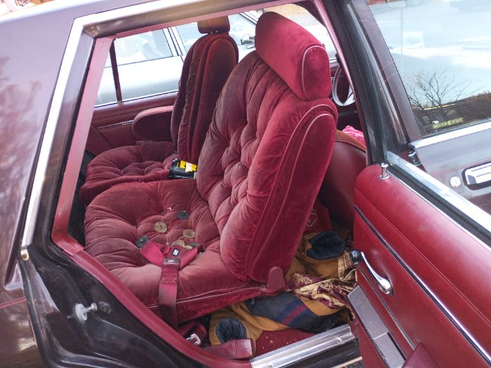

As far as room, yes, remove rear seat and seat back. Place new rear seat in place, put new front seat halves upside down on top of that. Should fit. Or place one half upside down on front passenger side.
