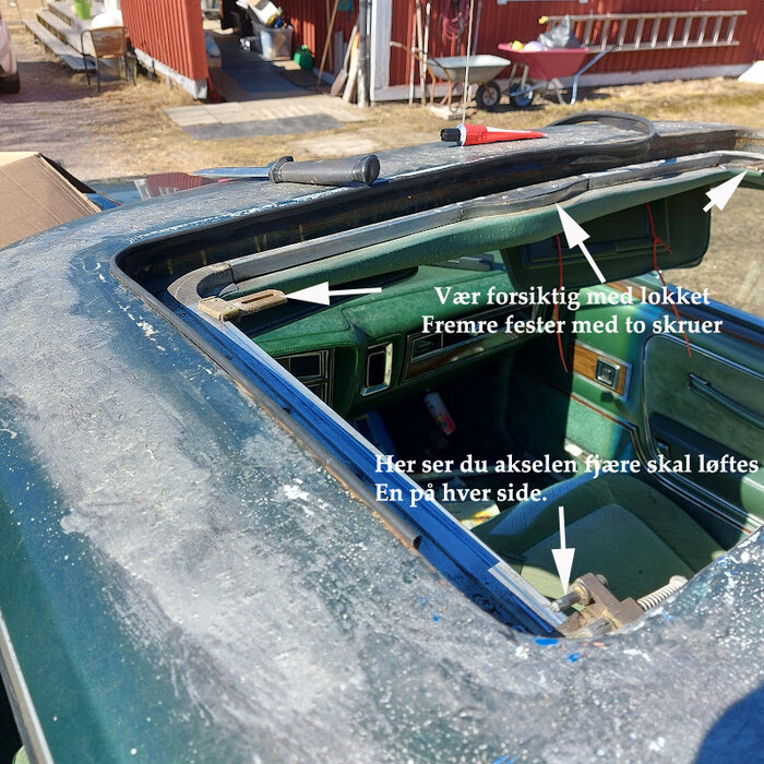

A P-shaped rubber list suits fine if you find it on E-bay 6.8 diameter on the top and around 20 mm flat. It is not a difficult job. Trouble may be to remove the roof but once you know how it not difficult
