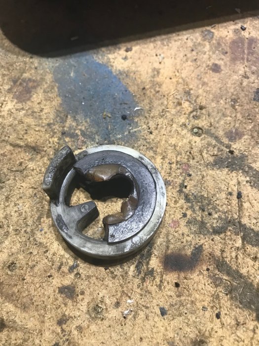

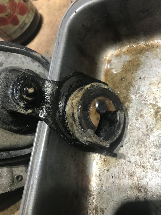

It is the bushing on the arm of the wiper motor. Attaches to the main link arm. Doesn't look like the link bushings. And the FSM doesn't even mention or show this bushing anywhere.

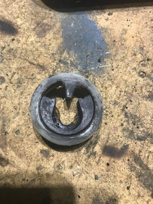

Here's better pics of the cleaned up parts. The little torsion spring that fits over the shaft is intact, just not shown.

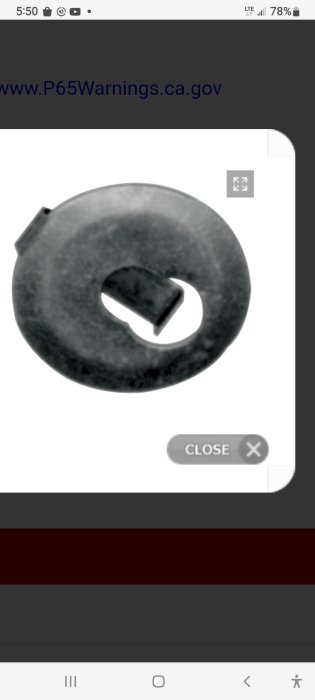

Well bugger. Just received the bushing from Vans. Doesn’t work. There’s nothing to hold it onto the wiper drive arm. It just falls off the bushing.

This was my mistake. The wipers for the 80-83 Cordoba are hidden, not exposed like Volares and Diplomats. It has a wiping cycle, and then has to park itself below the cowl.

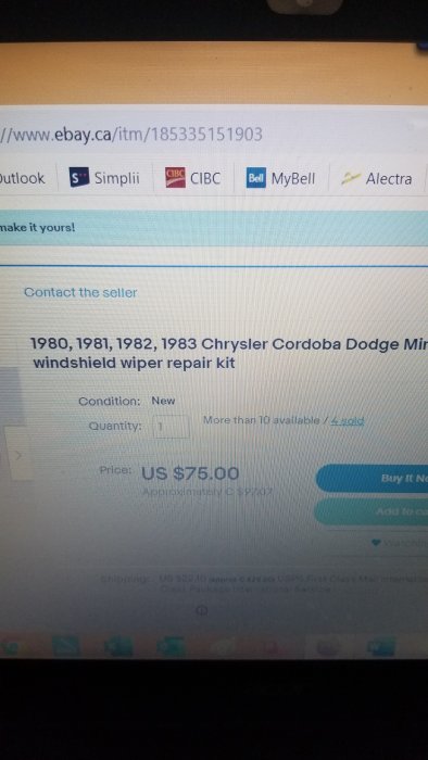

(Ebay links deleted, they keep redirecting to a scam website)
Or
AMS Obsolete Webstore
Edit: @toolmanmike when I try to put ebay links in here, they redirect to some scam website. I tried dumping my browser and it still happens
