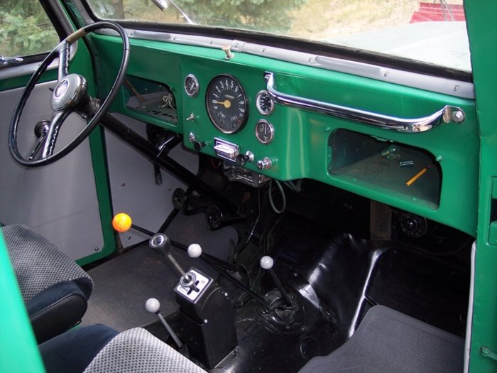

But how many shifter levers do you have?
Some day I will have to share the saga of the 63 Willys pickup ...
this is not mine, but what mine is supposed to look like.
Its been sitting for over a year now waiting for me to get educated enough to begin the restoration process...
That looks like fun in stop and go rush hour traffic.

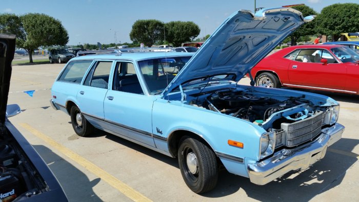

Matter of fact, I need to change the bushings in my ’77 Volare wagon, soon. I might have to take a lot of pictures of how that is done.

I might have what you need for engine A/C bracket(s). I will need to see picture(s) of what you currently have, and what looks "off", so I can look at what I have.
My '77 wagon is a factory no-A/C car, so it is a great reference.
