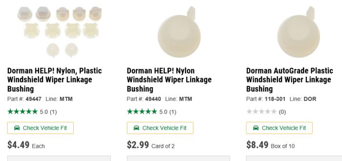

At O’Reilly Auto Parts (a parts chain close to me)
The first item is an assortment – so only 2 to 4 will fit your car. The rest fit other cars (so not really a good deal).
If nothing else, once you have the part number, you can search on eBay (or other places) to find a better deal.
There is a total of 4 wiper bushings. 3 of which are the one shown above. The 4th bushing attaches to the wiper motor and that bushing is not available (that I know of).

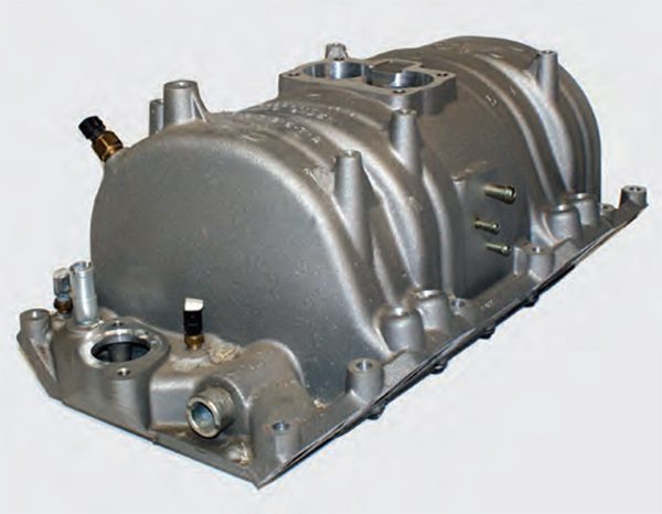

- The magnum intake bolts onto engine differently (bolts go straight down instead of 45’ angle on older engines - see pictures, below) – so a person would either need to use the fuel injection system off original engine OR purchase a new intake manifold (as well as carburetor).

The port fuel injection is what comes with the Magnums and it uses a “beer keg” design aluminum intake
If you notice, you can see the difference in intake mounting bolts (bolt direction)
