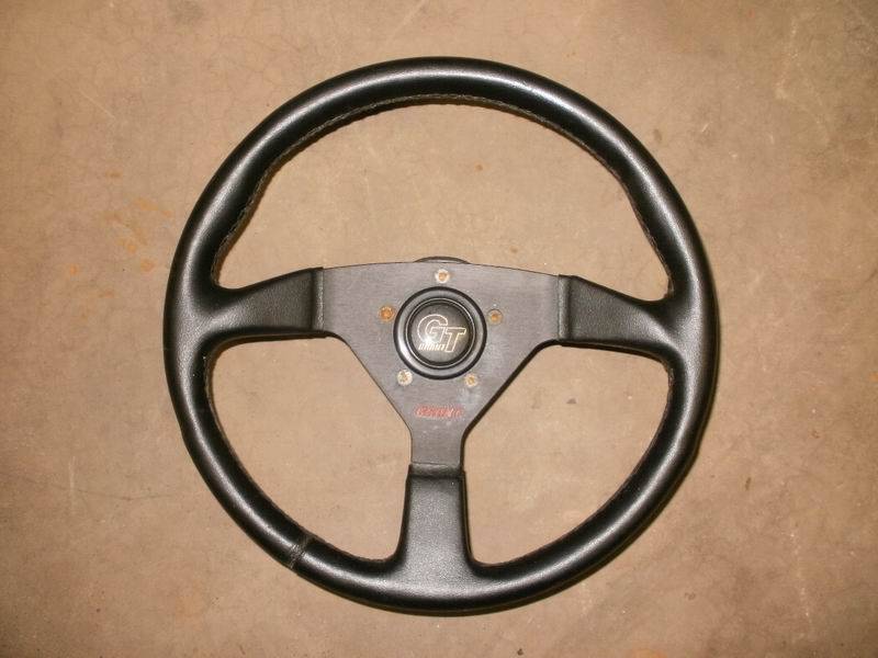

I have a Grant GT wheel in black if you're interested. You'd have to get the adapter kit, though, as this one came out of a Conquest. It's virtually new other than needing a little touchup on the allen-head screws:

Yeah, ..... I need to figure out for sure if I can use an aftermarket wheel with my tilt column, but looking at the factory service manual, it appears that maybe these cars were all tilt column? I don't see anything in the manual about regular column, so... it looks like a different wheel would bolt on.
Grant make a specific adapter kit for Mopars with tilt steering wheels. For the J bodies, I seem to recall a Grank Kit number 3196 for the regular Grant Challenger, Classic, and Signature series steering wheels. This is for the standard Grant 3 bolt attachment set up. They also show a kit for non-tilt steering wheels as kit 3314.

The tilt columns are different because they're made by GM. I used to upset my GM-lovin' buddies by using a Chrysler key to start my Trans Am; the lock cylinder from a '77 Cordoba fit like it was born there.
The tilt column uses the 3196 Grant kit, the non-tilt uses the 3314. Either way, it's a $20 kit to install the steering wheel I posted.

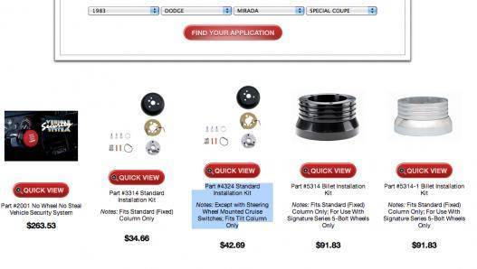

Thanks guys. Actually I already ordered a Grant Challenger GT wheel and have it, I just didn't post about it. The Grant site told me to get the installation kit #4324 for this particular car with tilt, so that's what I got. I hope it's right. The Grant site did not direct me to the 3196 kit at all. ?!
On the Summit site, if I go through the applications chart, it shows 3196 for Mirada 1980-1981, and kit 4324 for Mirada 1982-1983 (with tilt). So, I'm pretty sure I have the right one with both Grant and Summit telling me that it's 4324. I don't have access to the car right now, so can't check either way.

It makes sense. I looked it up for an '81. For some reason, when I think about J-cars I always default to '81.
1,965
420
I looked up a 1980 Cordoba, thinking they were all the same from 1980-1983. My bad. They must have changed over the tilt wheels only, the 3314 kit is still being called out for a non-tilt column in 1982. Maybe Chrysler started building their own tilt columns, or just went to a different supplier.
