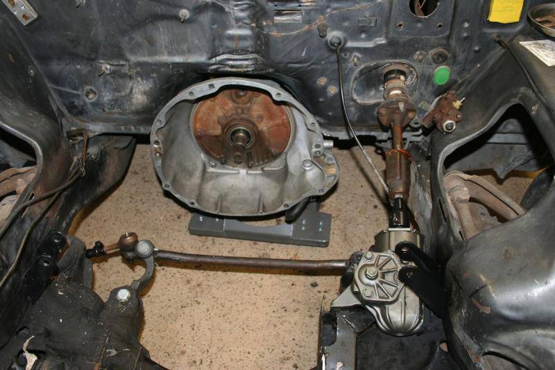

OK, it still doesn't look like much, but the steering is done, and the transmission is solidly in place now. The brakes are done except the front plumbing/master (just realized today I'm missing a short piece, need to pick up some tube). I finished prepping the engine too, so the next step, probably this weekend, is to nestle the engine home. After that, the real fun stuff begins! I really wanted to paint the engine bay this year, but with my limited time I have to spend in the garage, I decided I better skip it, at least for now. Not being painted shouldn't affect the fun at all.

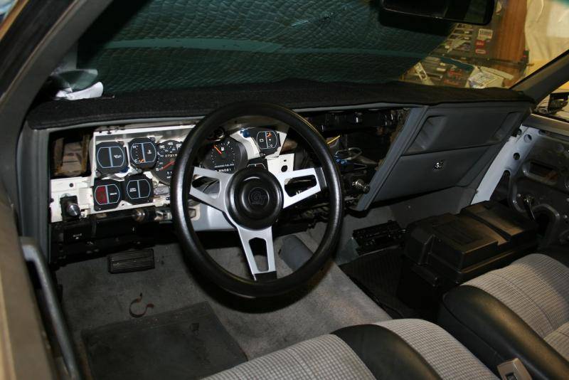

Got some other non-photo-op-worthy work done today, but had to stop doing that particular stuff due to rain (working in a cramped and stuffed-full garage sucks), so even though the interior is the least of my worries right now, I took the time to replace the STINKY steering wheel with the new Grant one. Between that and carpet dash pad (not flattened yet), makes a world of difference. I truly couldn't believe how horrible the old wheel STANK. It was like, well, I won't describe how I envision it got that way...
