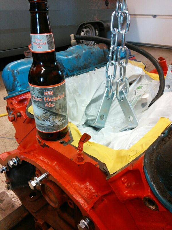

finally, a little warmth!
It's finally warm enough to be out in the garage for a more extended period of time. Going to give the engine a quick respray tomorrow (should be over 60° in the garage) since it's been sitting around for awhile waiting for a car. It's good to be working in the garage again after this long, cruel winter.
