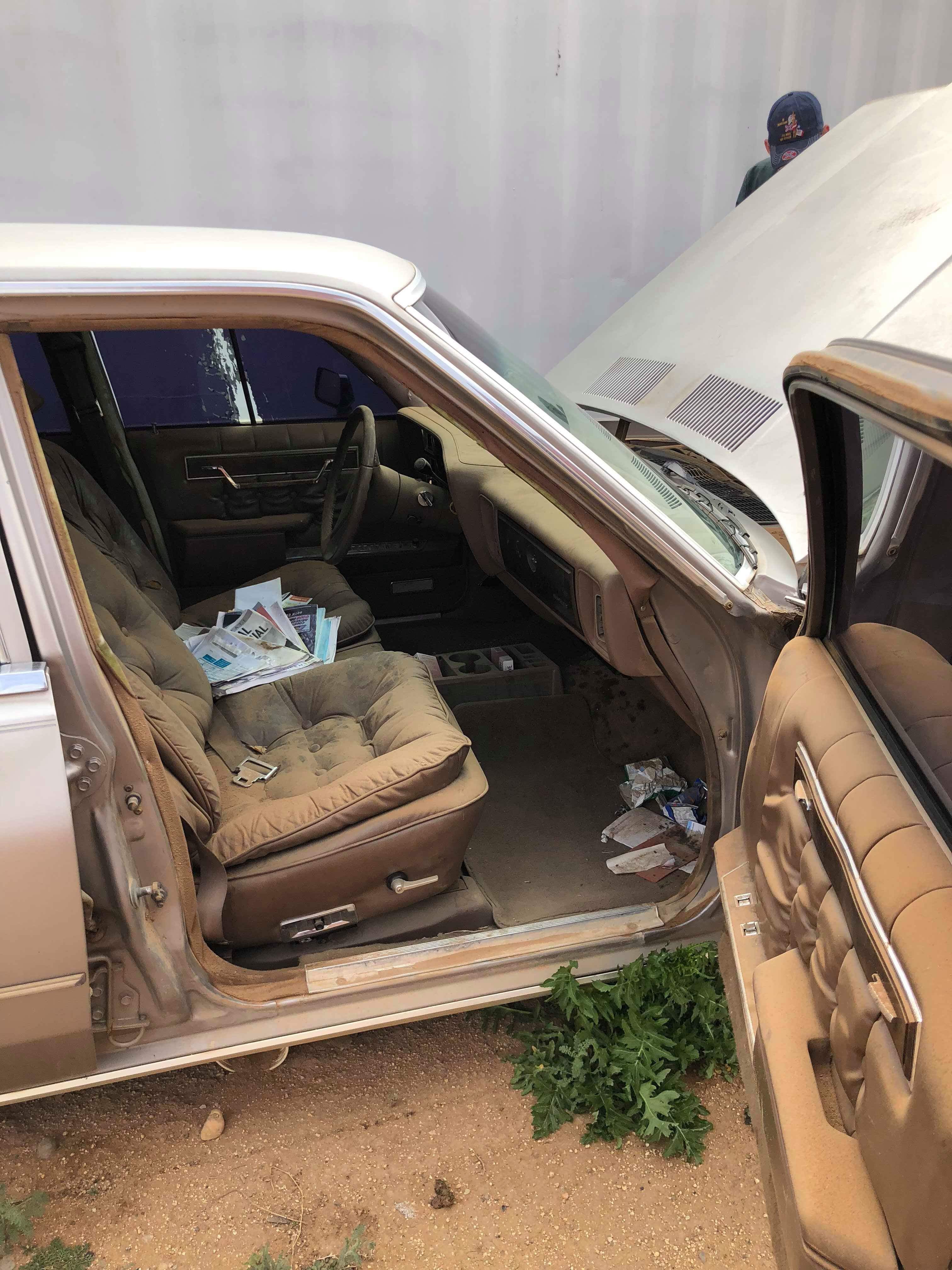

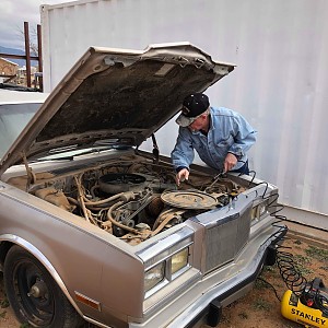

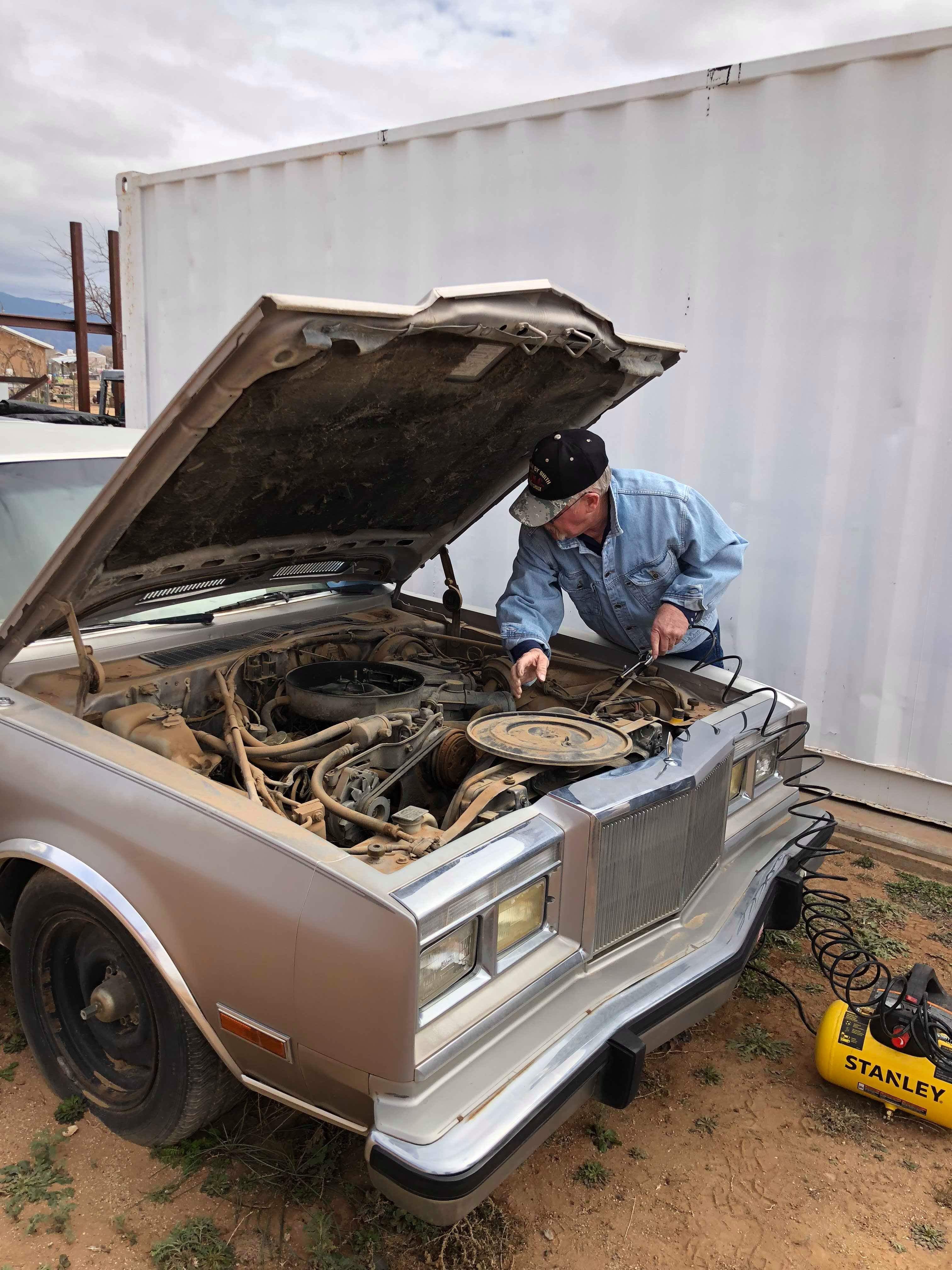

Day 1-3 - New Fuel Filter, Battery, Air Filter, and Distributor Cap
Day 1 - After sitting for ten years, it was time to get her running again. First thing, was to put fuel and an additive in her. Using an anti-varnish booster, (Used the entire bottle - overdosing was not harmful as per the bottle) and 4 gallons of fresh fuel mixed with roughly 2-4 gallons of old gas, and a jump, she started. Would not run for longer than a few seconds, however it is better than nothing.
Day 2 - Replaced the battery, fuel filter and air filter. Started quicker but still would not run.
Day 3 - Found the distributor cap was heavily corroded. Replaced, and it ran a little longer but not enough to do anything. Disconnected fuel filter (already dark red fuel in it) and cranked a little, getting really dark and gritty fuel coming out of the tank. Decision made to drop the tank and clean it out. Planning ahead for a possible carb rebuild, etc. VIDEO UP SOON!

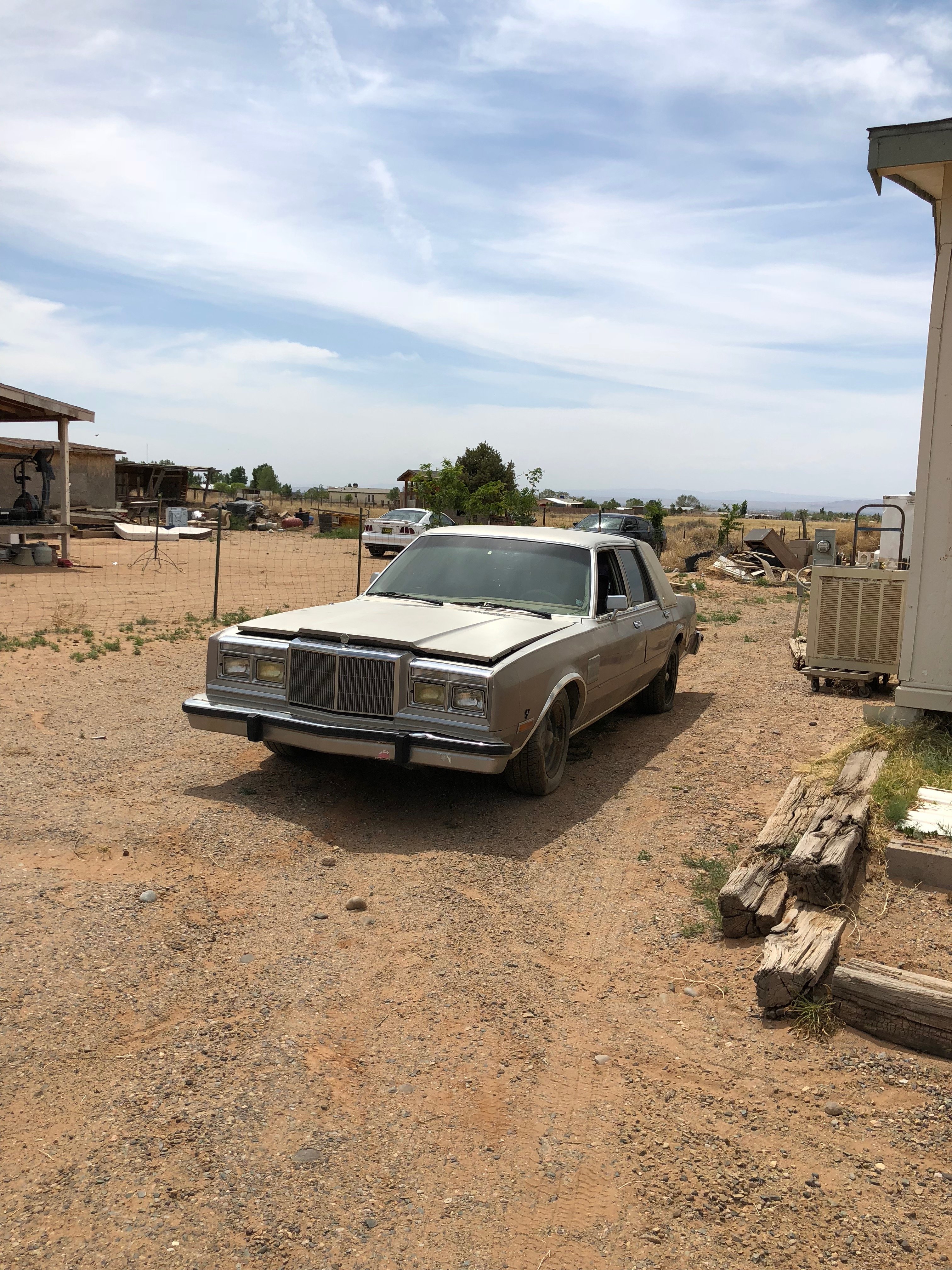

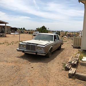

Day 4 -

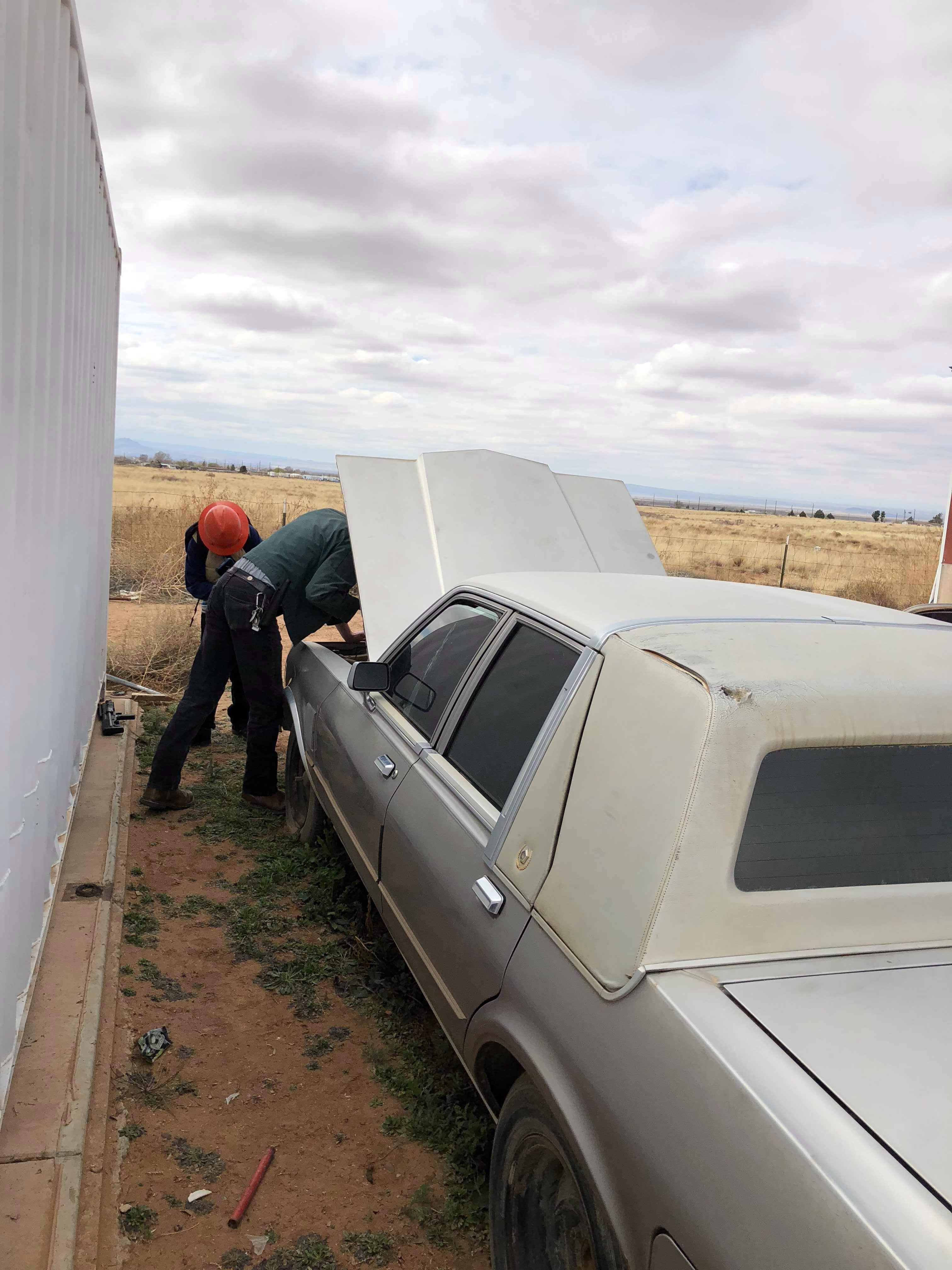

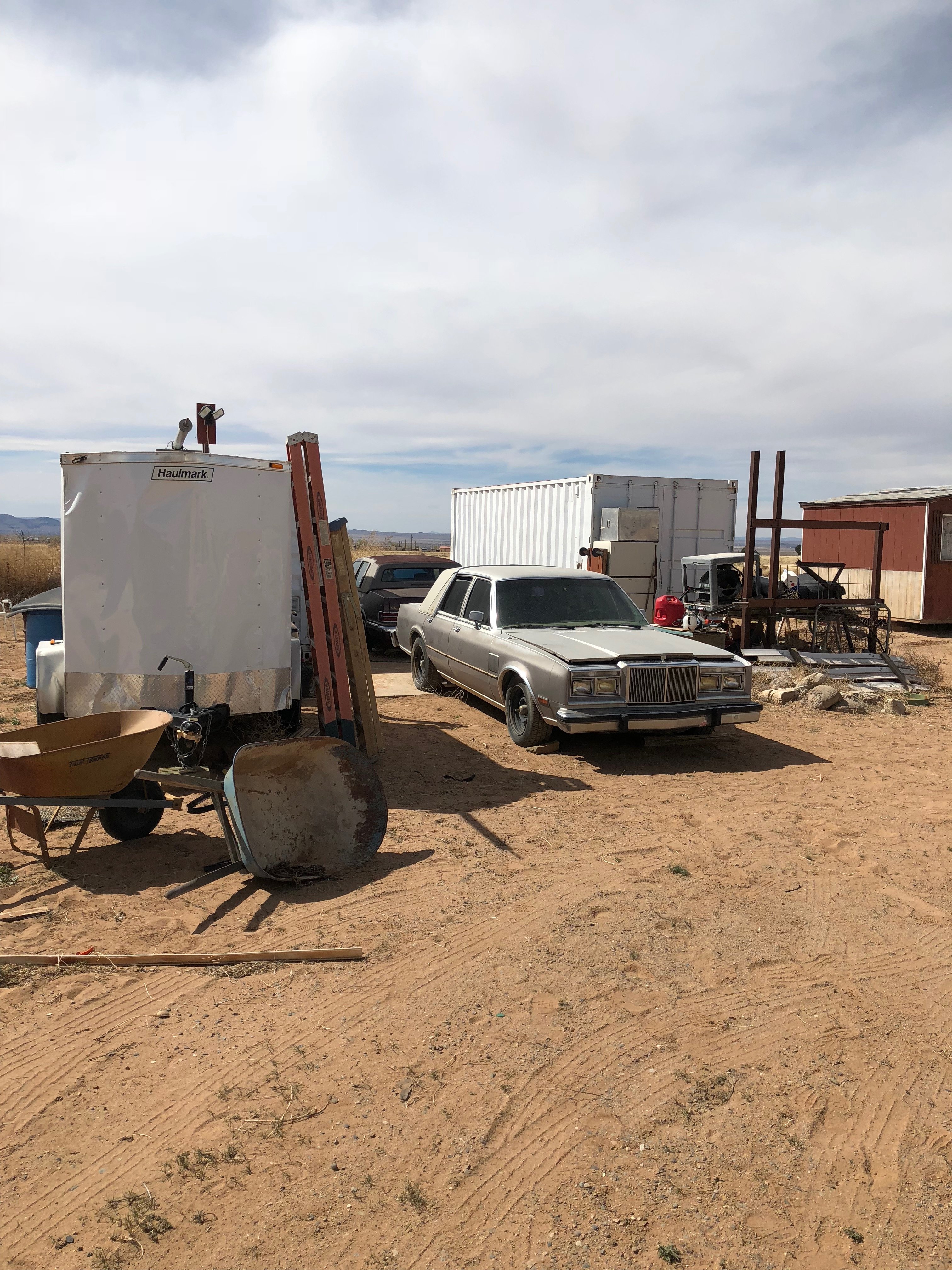

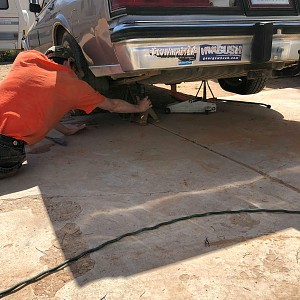

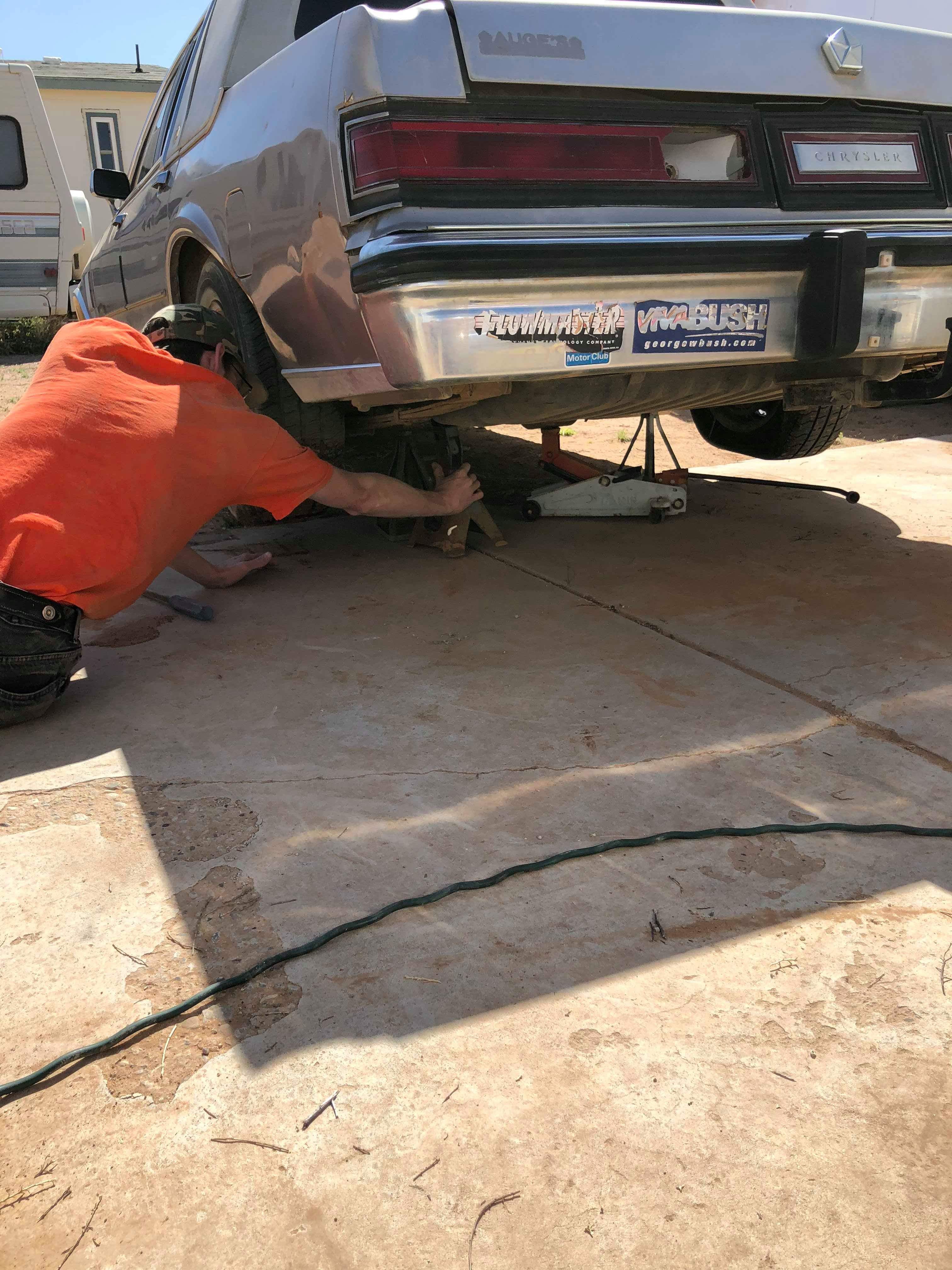

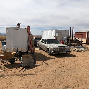

Cleaned out behind the '91 Imperial in background, and moved The Pearl onto concrete slab. Next task is drop the fuel tank and clean out gunk and varnish left behind. During the small tow-and-push across the yard, the engine was cranked to turn the power steering pump enough for the steering to work better and less stress on the system. It ran for about 4 minutes without the intention of even starting it. Not bad for this small amount of effort so far. VIDEO UP SOON!
On a side note, all but one of these tires holds air perfectly. The forth only loses a little over time. Tread is perfect, although I know they wont last very long once shes moving again.

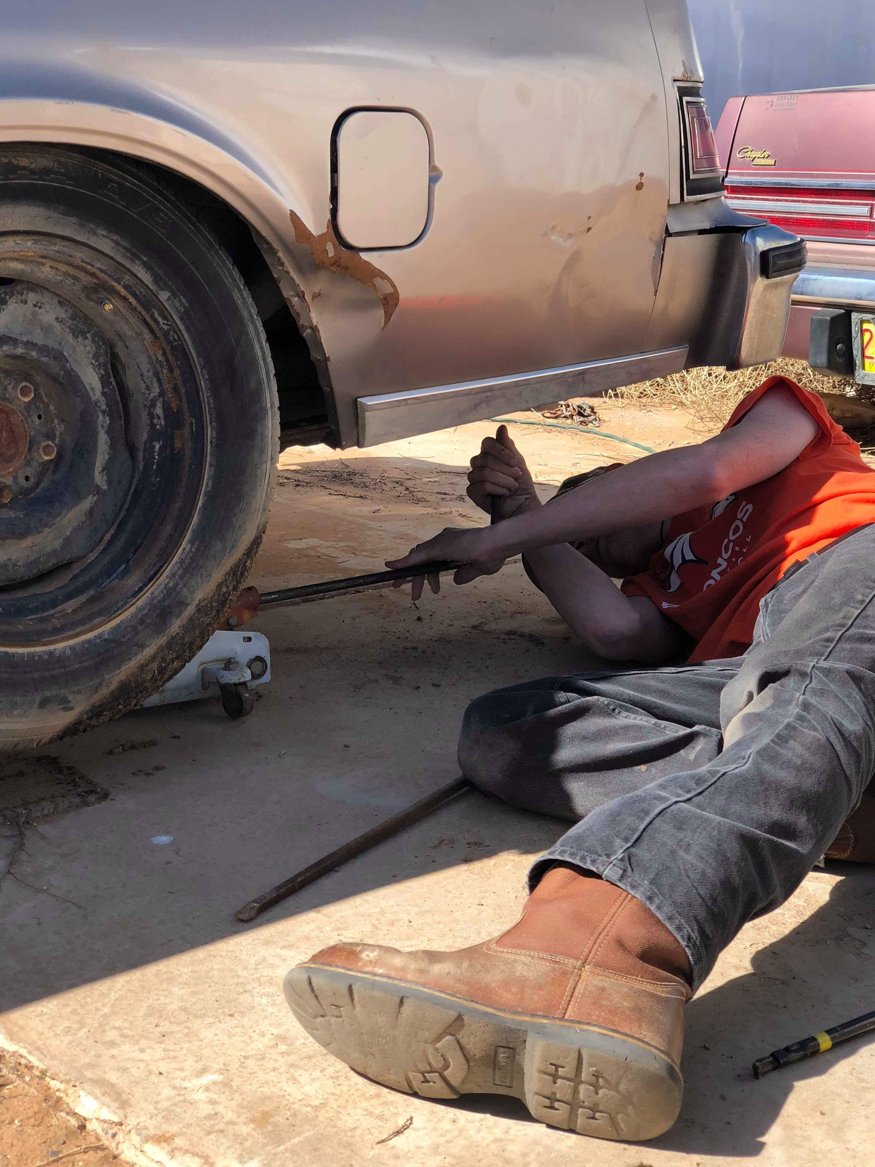

Day 5-8 -

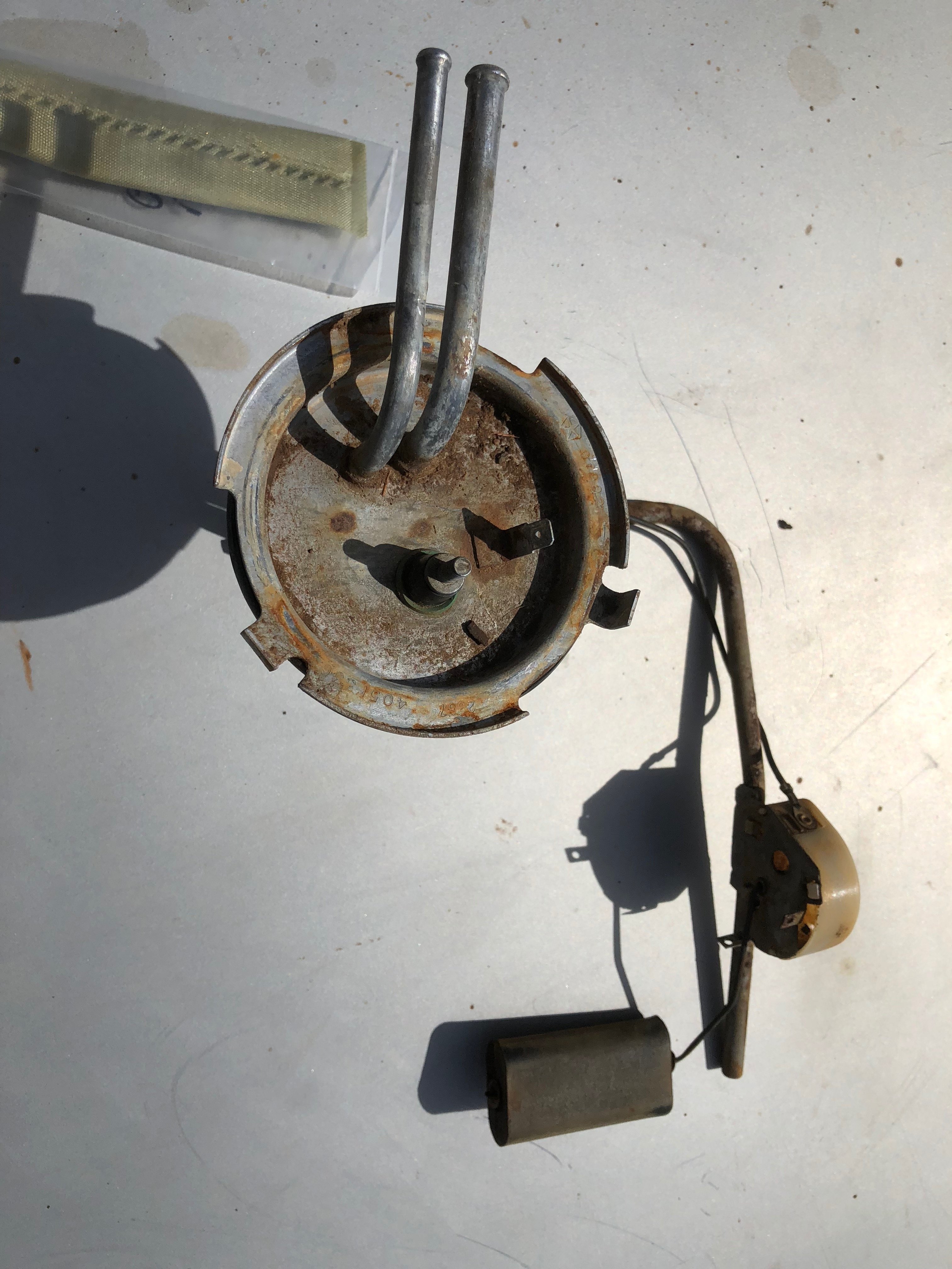

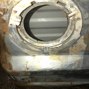

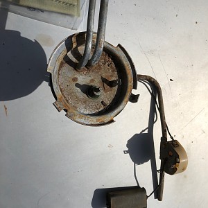

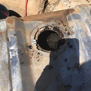

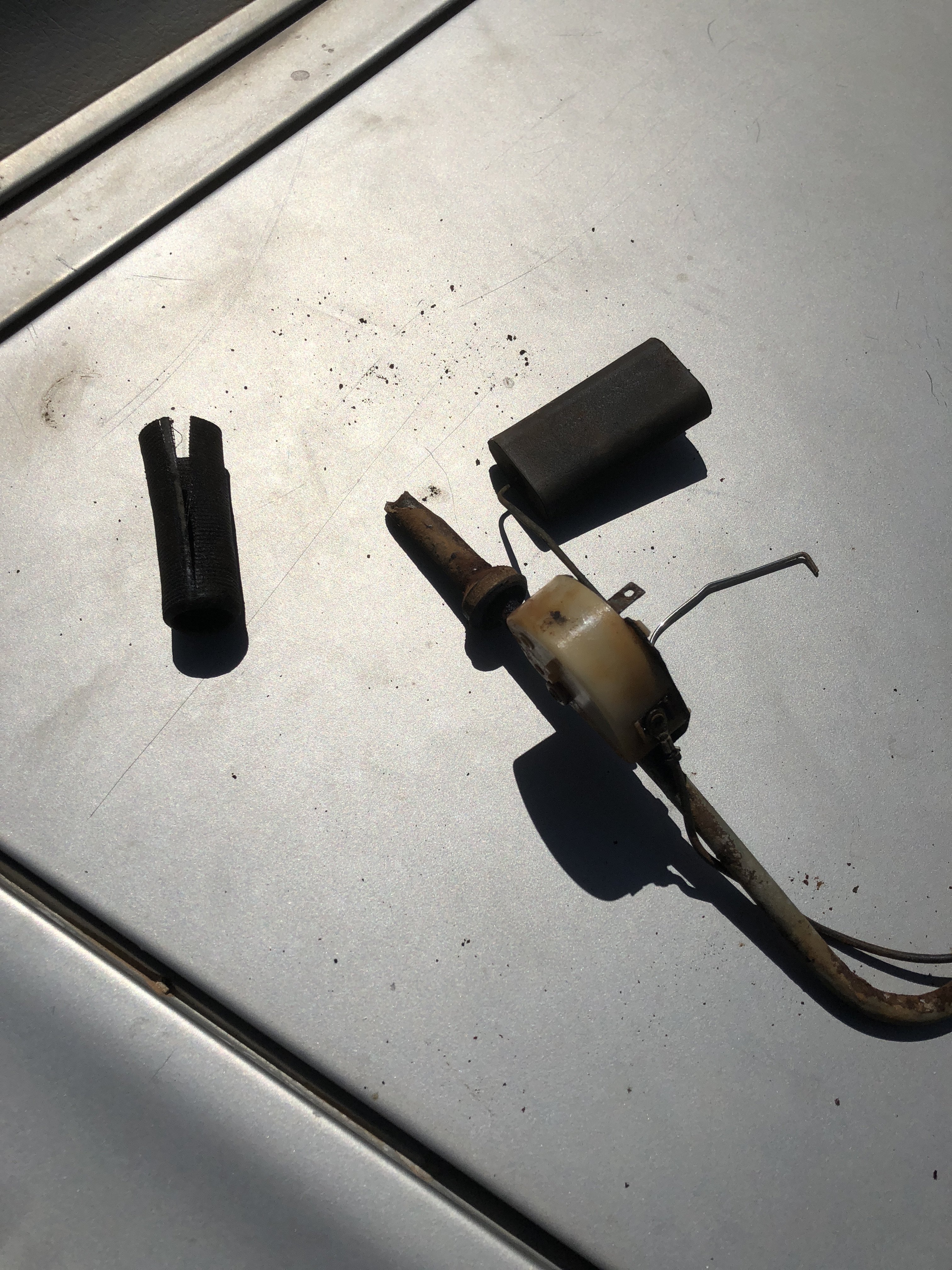

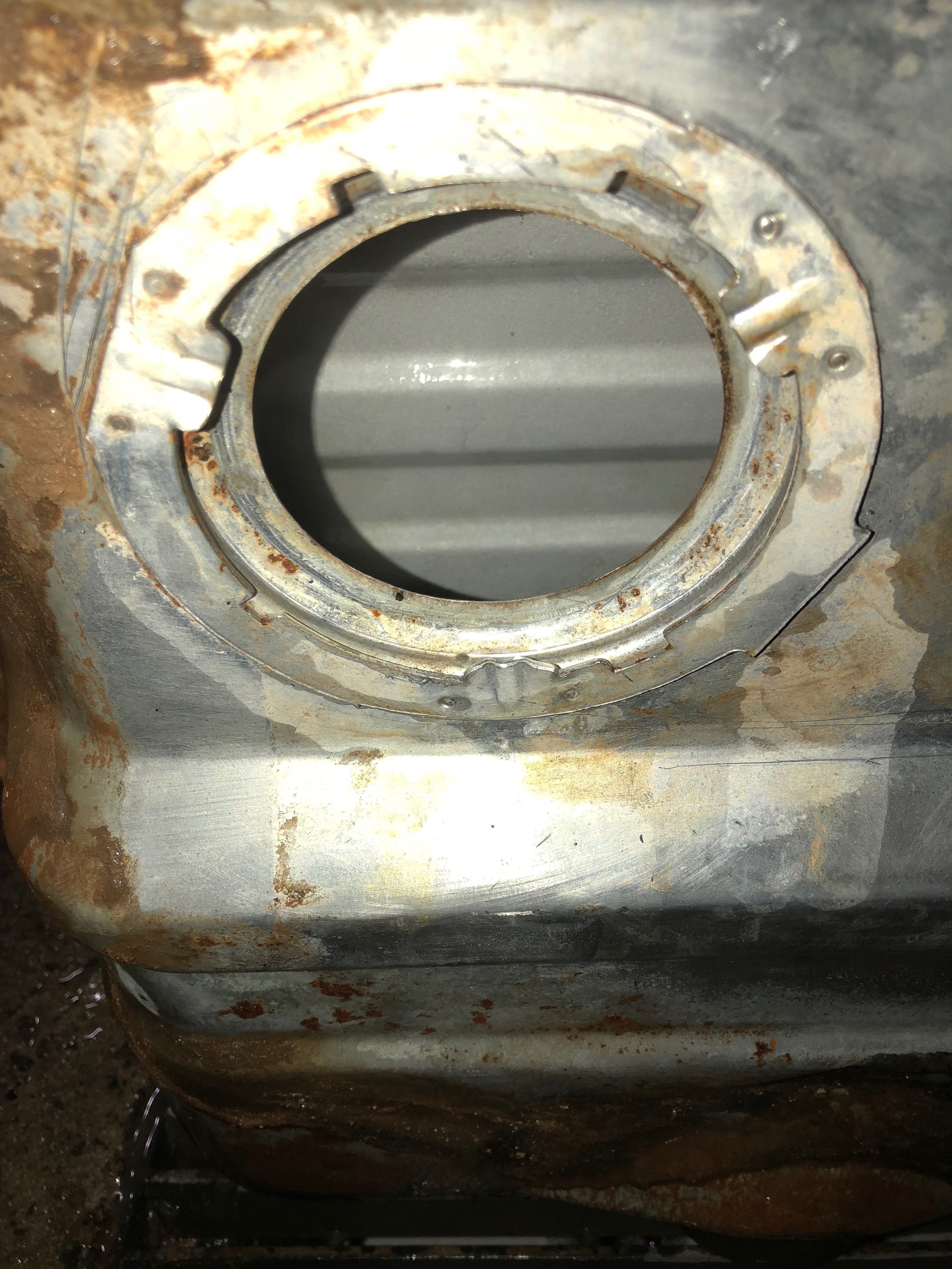

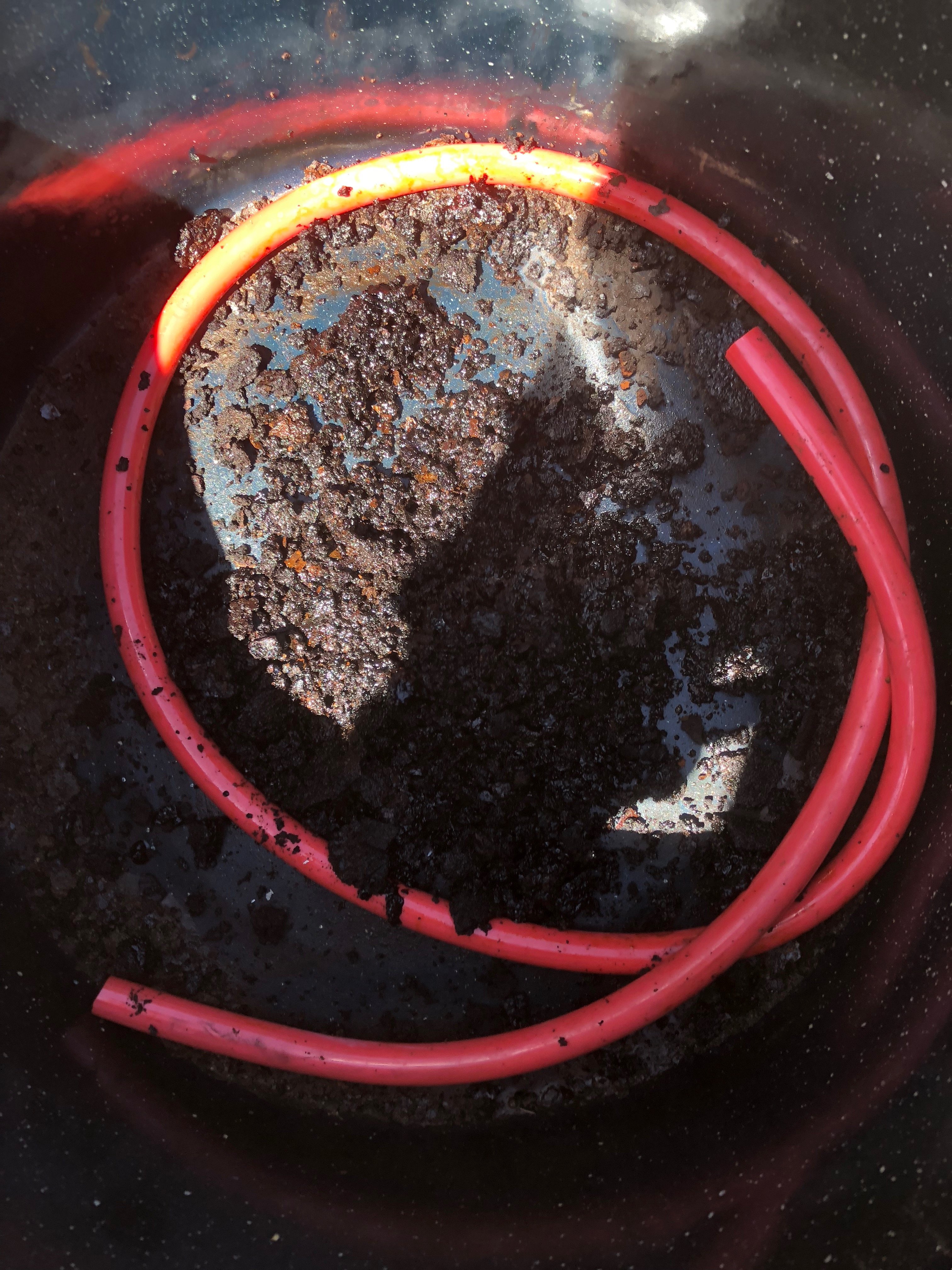

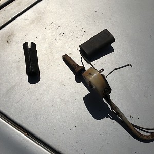

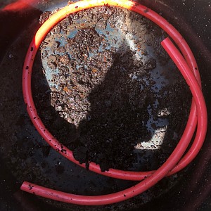

Dropped the gas tank over the course of a couple of days. This revealed about a half inch or more of black goo and sludge. Fuel sending unit send tube was also full of this disgusting goo, and upon inspection the in tank fuel filter crumbled. Cleaned our the sending unit and ordered a new sock/filter.
Let 1 gallon of Mean Green Super Degreaser, diluted with 1 gallon of water sit in the tank for about 48 hours. No evident leaks from anything, and thankfully little to no rust anywhere on or in the tank.
Took tank to a car wash, and pressure washed out the gunk and Mean Green mixture - and was pleasantly surprised. IMG_4087.JPG
Took the tank home and let it sit overnight. Next morning there were traces of rust on the inside, so I figured I needed to get the tank hooked up and gas in it. So, the little bit of stuff left in the tank was dry, and easily shop vac'd out. Installed the fuel sending unit and new sock, (had to scrub the sending unit, fuel level float, and all parts of the unit as well) and reattached the tank.

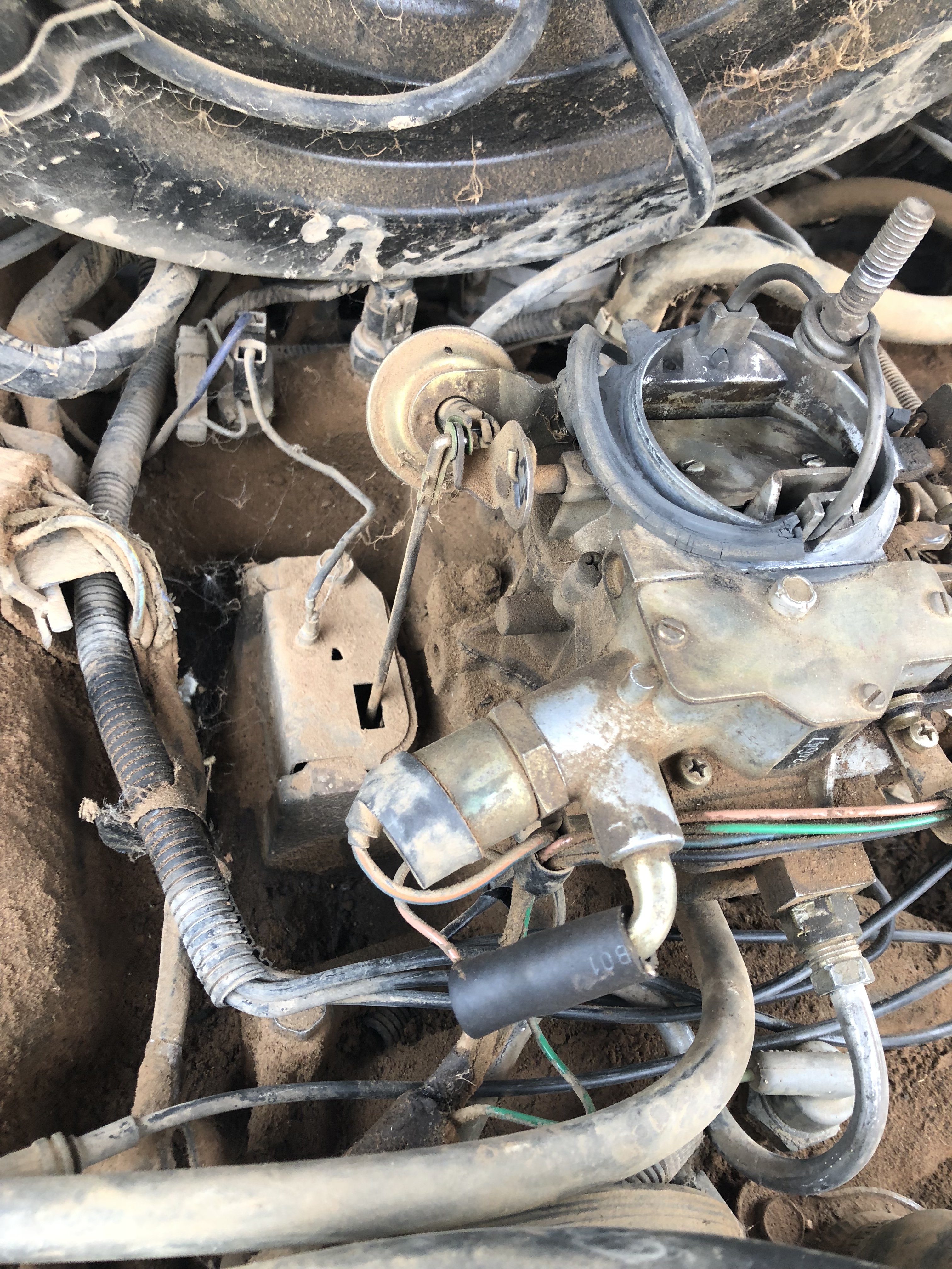

In the process of figuring out why it would no longer run, I discovered a leak from the carburetor and very low trans fluid. So off to troubleshoot some more.

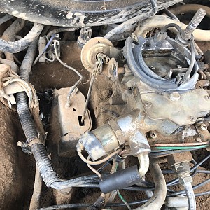

Leak amazingly fixed itself after I replaced the PCV valve... yes - the PCV valve... gaskets must have been dry and the bad PCV valve wouldn’t let the car run.

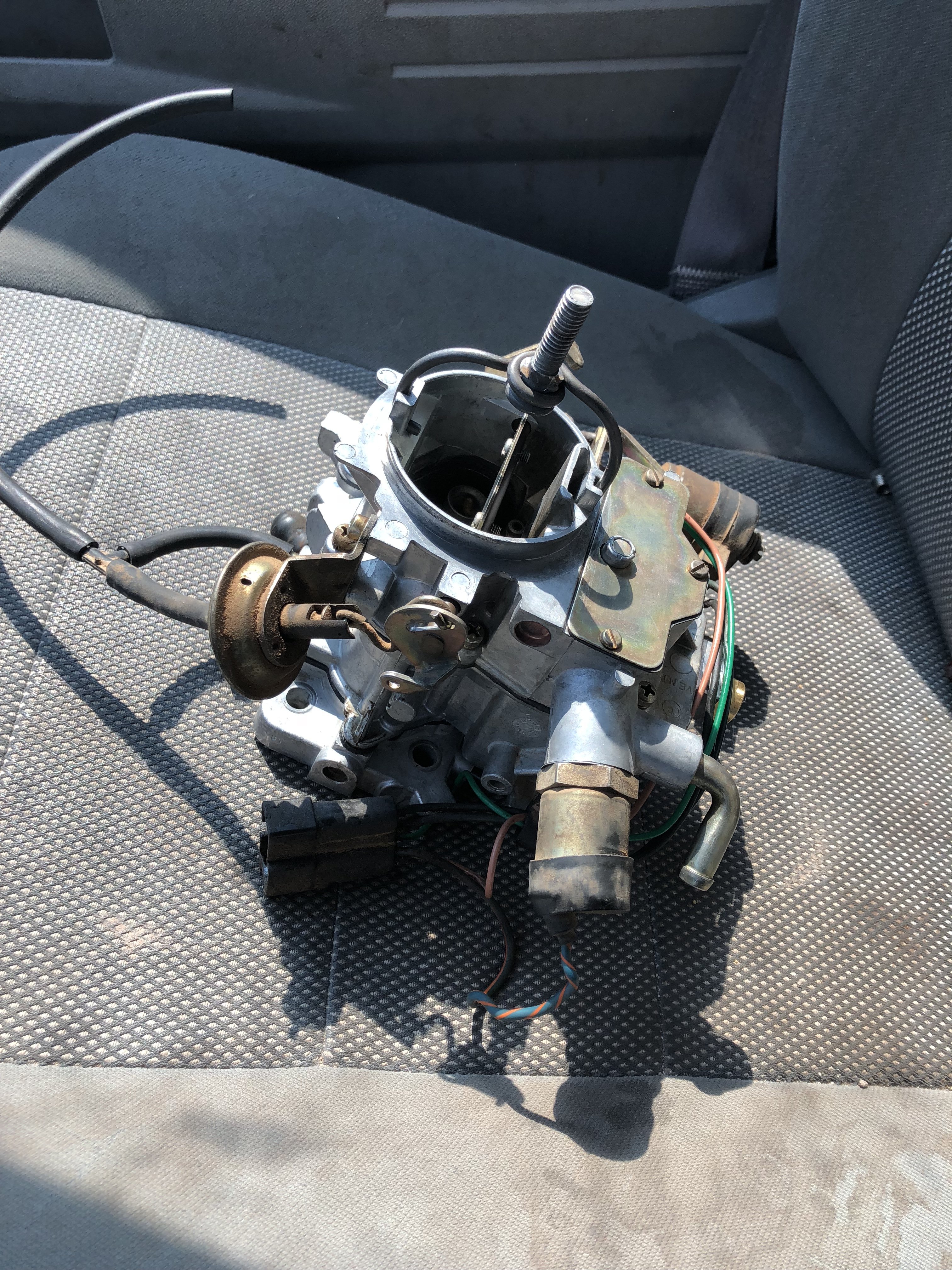

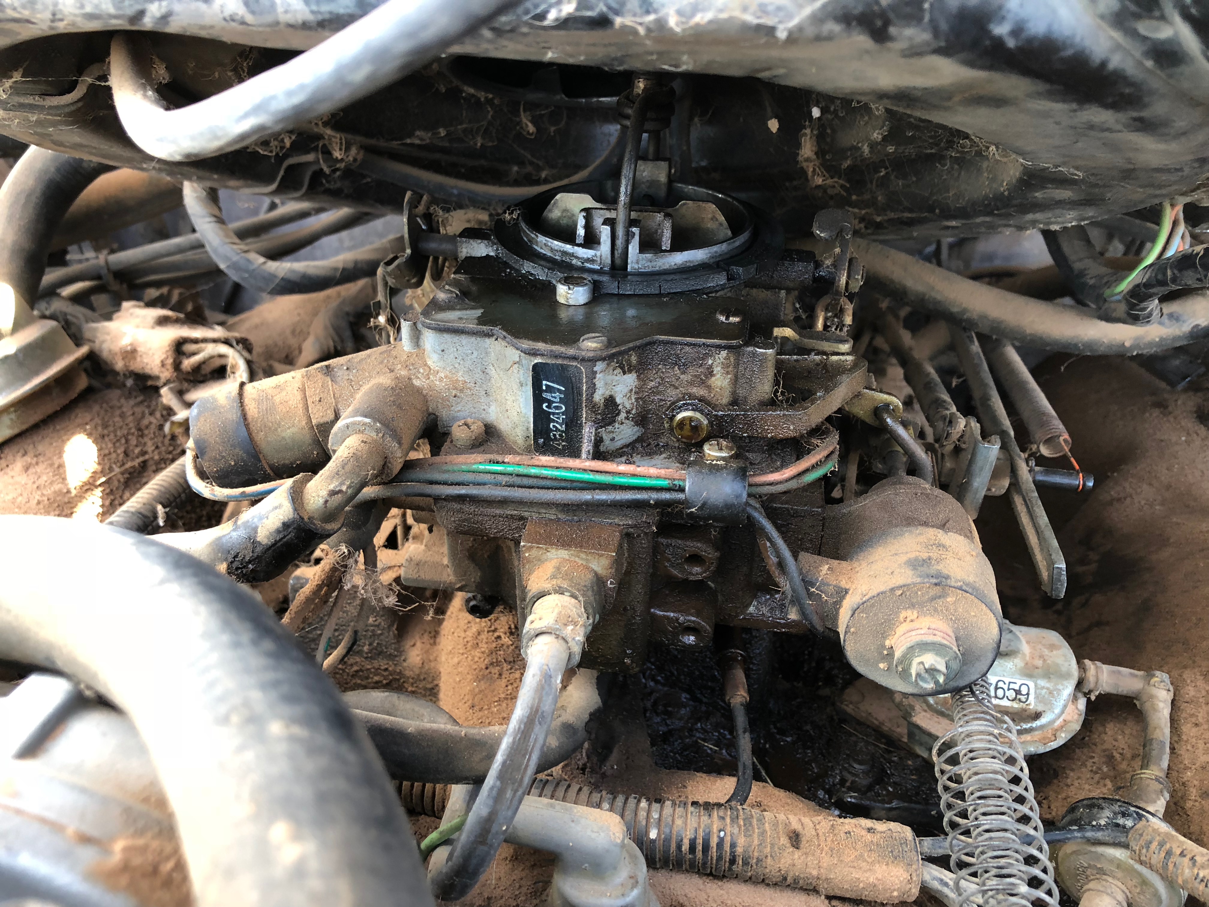

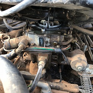

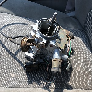

Car was hesitating and bogging down while driving... Hills? HA - nope. After looking and tinkering, found out the carburetor was flooding - so off to rebuild.
Now that it is finished , this is how it looks now..
So far - pre-test drive, it appears to be running better, no flooding and all around more responsive.
