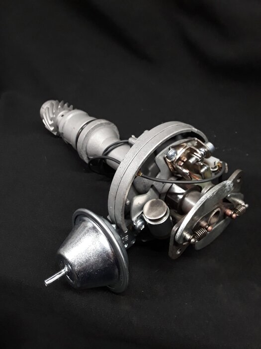

FINALLY got the engine back a couple weeks ago. The original block is .040" over, has 2 sleeves, but was saved. Heads also needed a fair amount of work, but they're good now too. Being the Olds 400 G blocks are not well liked, we actually went with SBM pistons/rings for it. The rods were reconditioned, and the wrist pin hole on the rod was bored out to fit the Mopar style pin (floating .984 vs pressed .980 IIRC). Picked up a custom Erson cam for it, and am just waiting on the assembly shop to call saying they're ready for it. They're going to assemble and dyno. I sent the original distributor off to be restored/recurved for the setup, Coan is building a converter for it, I need to make sure the intake/exhaust manifolds can be saved, and am hoping the Qjet that came with it can be reused/restored as well. I'm trying hard to get this as original as I can, aside from big cam/high converter.

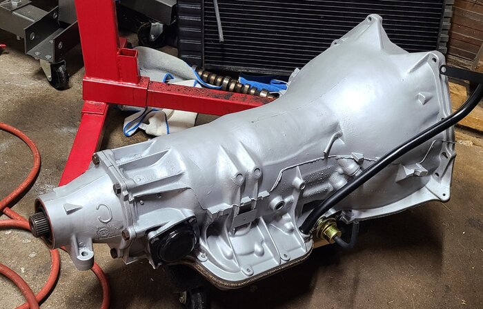

The transmission was rebuilt in the fall, with a Transgo shift kit installed. He said about 80% of the internals were junk due to being stored outside with the dipstick out for who knows how long. The rear end wasn't in bad shape, but I went ahead and sent it off to JD Race to have it restored/add a posi unit as well. Just finished installing it, along with poly bushings out back, and putting the new wheels and tires on.

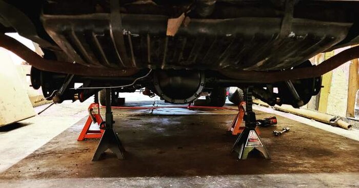

Finally found an issue where being a GM A body paid off. Most everything on this car is "Olds specific" it seems and a lot of things are hard to find parts for. Initially, I had figured being the same chassis as a Chevelle and GTO, parts should be plenty and cheap..I was wrong.
Today though..we tore the front end apart with the hopes of having it back together in about 6 hours. I had all the tools, all the parts, etc..just needed to get the control arms out.
After 3 hours of fighting with a balljoint, realizing we forgot to unhook a brake line and subsequently broke it, and being stuck at getting the upper control arm sleeve off..I said screw it and went on the hunt for control arms.
Sure enough, OE style arms with joints and bushings are available at a good price. I bought a dang parts car for upper control arms for my AHB. Definitely glad I didn't have to do that

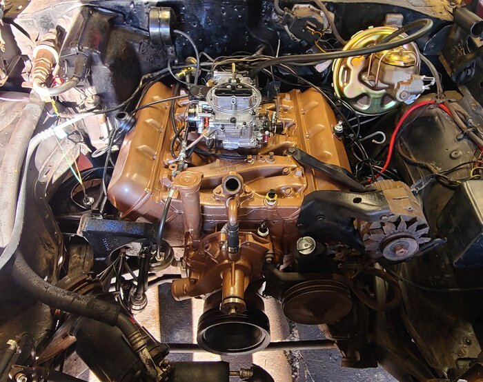

Haven't updated in a while, so here's a couple pictures.
Also, it finally fired up today. Not bad for 318 pistons..

...if anyone has paid attention to my luck over the last 12 years on these pages (here and farleys) this will not come as a surprise...
The first week of September, we went on vacation to FL while Dad was housesitting and had planned on getting the exhaust done on the car as well as the alignment. Super long story with that, but exhaust is still not done, and the trip to get an alignment turned into about a 3 week long debacle due to a freeze plug falling out, things on the suspension not being tight, and a wheel falling off while the mechanic was driving from one shop to another.
once I got it back, I spent probably 2 weeks trying to get it to fire up only to realize the spark plugs were being hit by the pistons. Another week plus headache sorting that one, but it looks like its been rectified (block was milled yet assembly shop used longer plugs instead of shorter ones)
finally got to drive it today (all of 1/4 mile round trip) and while it still has a few gremlins, it was nice to get it going after it'd sat in a barn for 15 years and now a garage for a year and a half.
