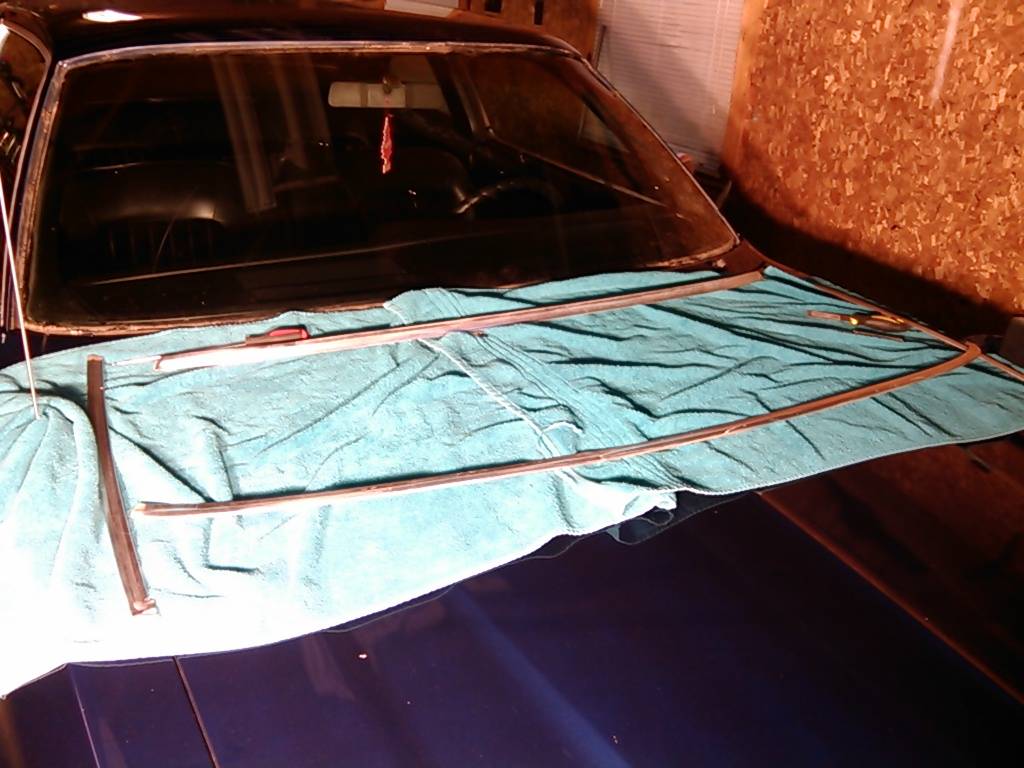

Replacing The Windshield

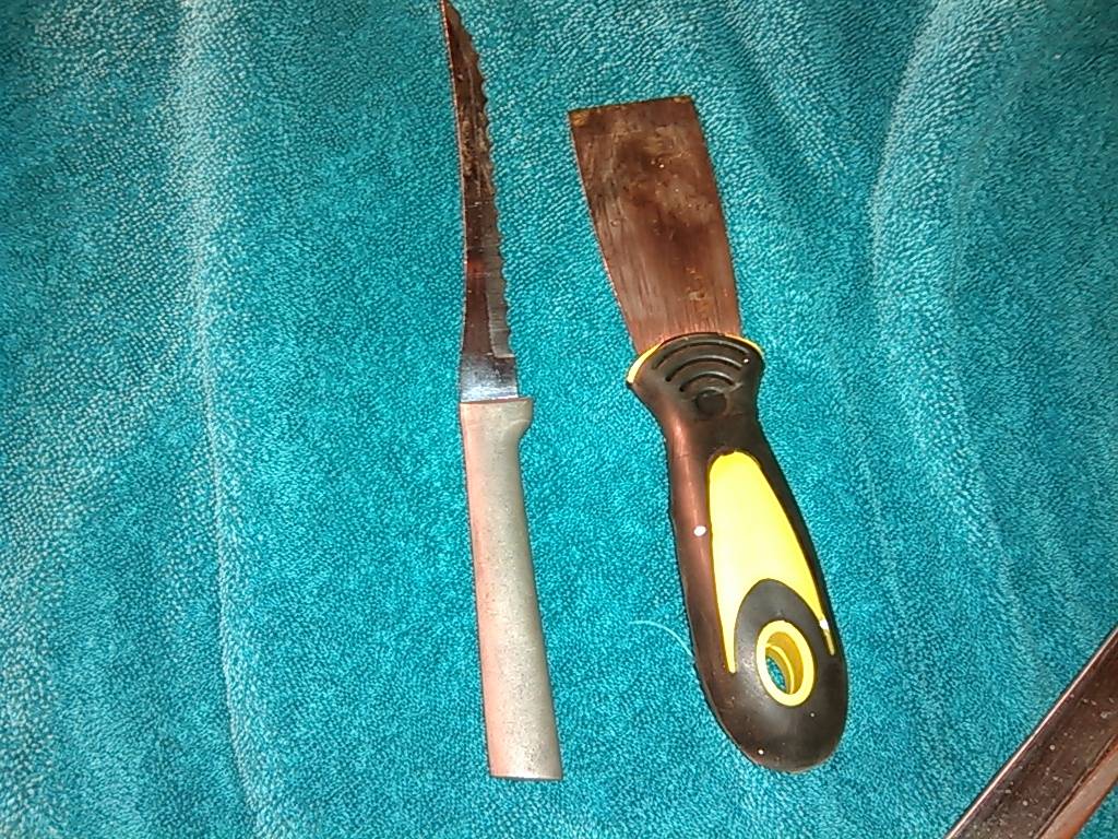

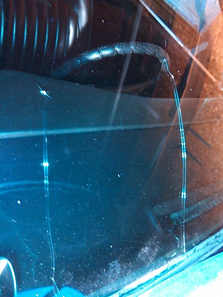

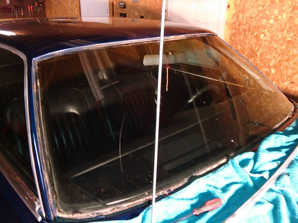

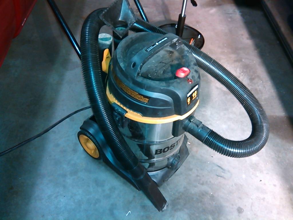

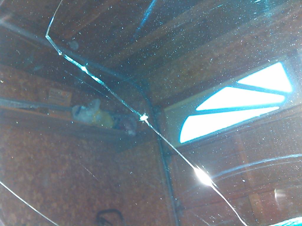

There were to places that looked pretty bad right in the center of the lower windshield. I removed the trim and used a flexible knife and putty knife and was careful not to damage the trim. Take your time so you do not damage your trim. Can be done without the proper tool you can buy. A cigarette break helped me.
As for the window itself doesn't matter it is coming out so don't care if I scratch it. I did notice I am able to use all old clips still but one. I then took a shop vac and cleaned all dirt and trash out of the window channel.
Will half to wait to install the new window there is no room in my garage and it is raining like crazy here right now. Here's a few pictures. Thank You

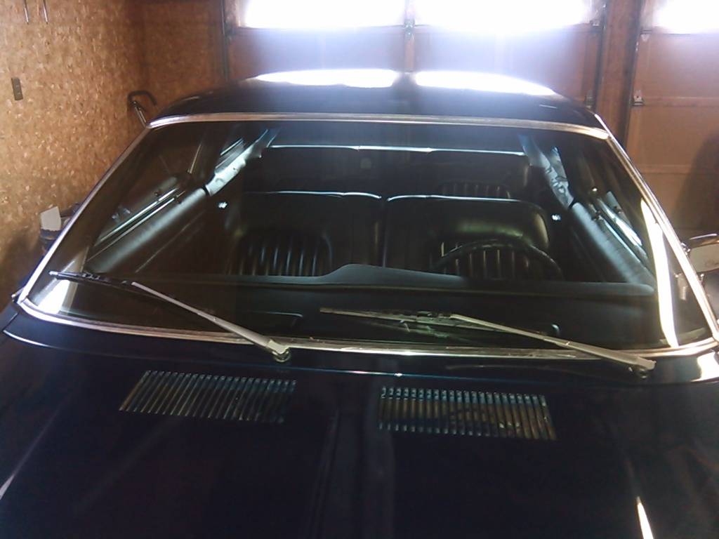

Well better late then never. Between the storms and snow and having to deal with fallen trees clean up on my property finally got the new windshield installed. Seems like there is never enough time in the to get all chores done. Here are a few pictures. Thank You

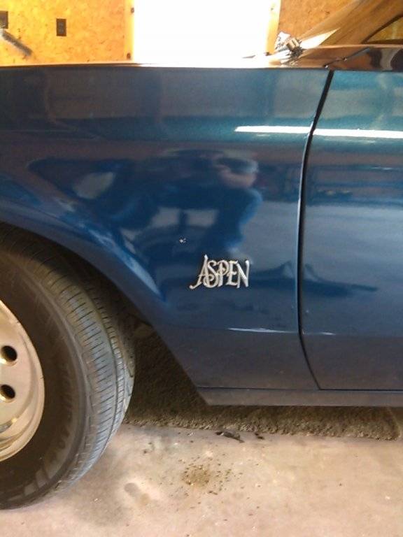

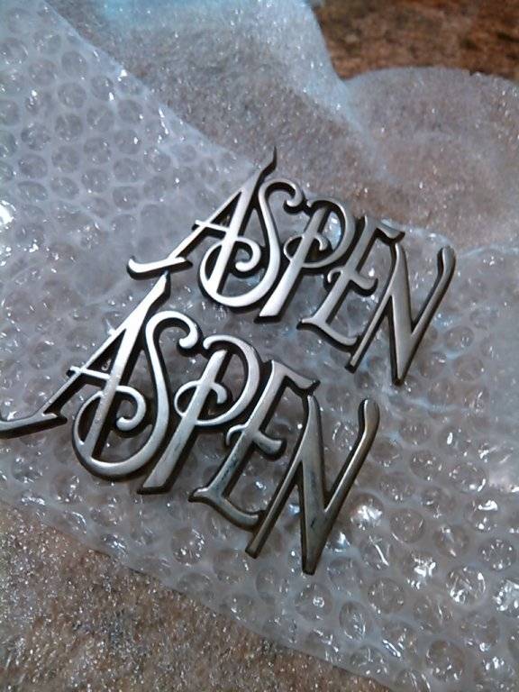

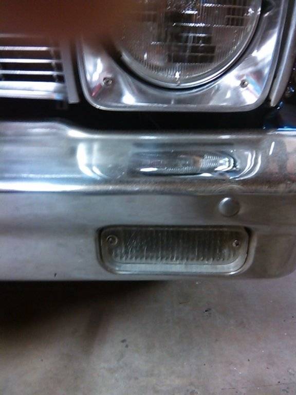

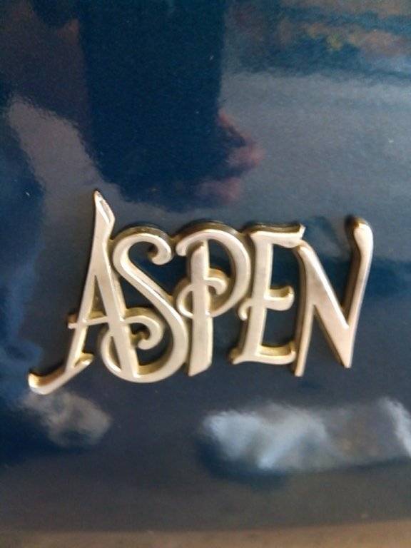

Well yesterday was my birthday very thankful for another year above ground. Got those Aspen fender name plate emblems Jim sent me they are beautiful and close to mint his stuff is top notch.
Here are a few pictures of the install. Now when someone rolls up on me at a light they wont say hey is that a charger?. I'll say No it is a Aspen do you have one he he. :D Thank You

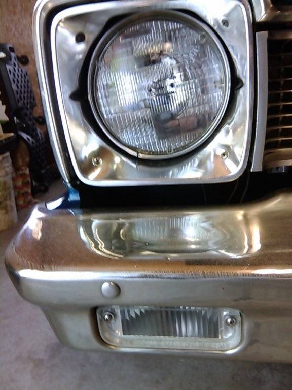

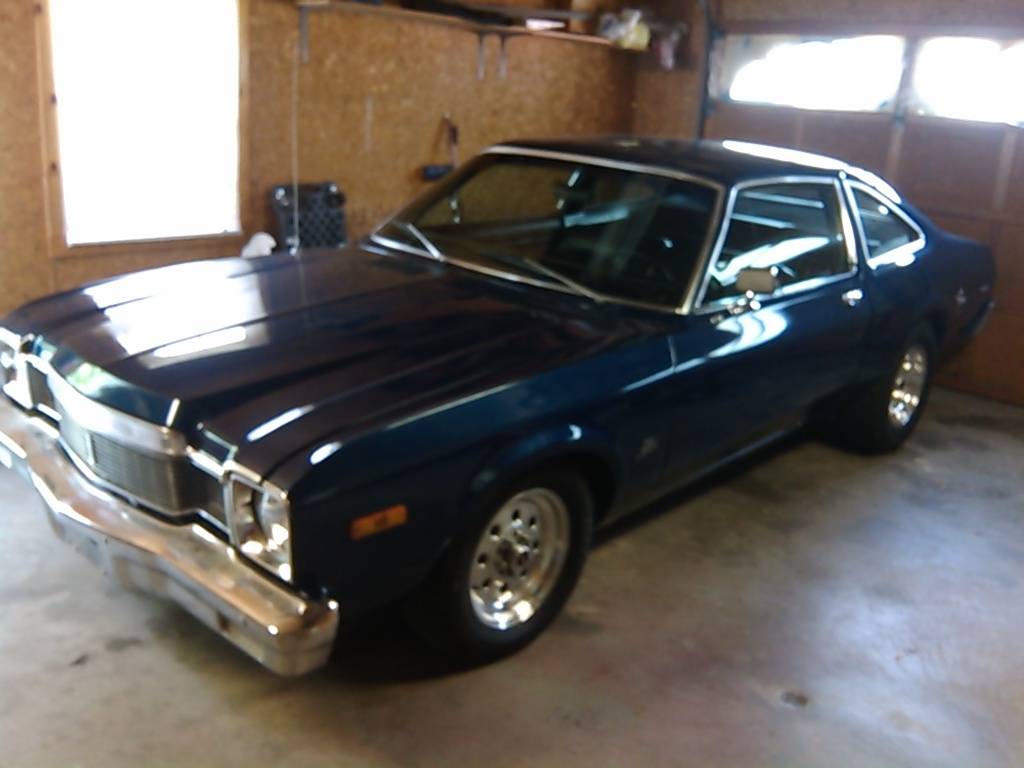

I take a lot of pride in my Aspen she is all cleaned up just a few new pics and parking lights found finally. Thank You
