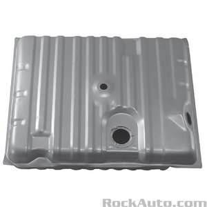

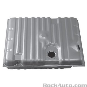

Can I bolt up an 88 5th Ave fuel tank into a 79 LeBaron coupe?
Rock auto shows a split in 79 with the newer tank being the sane up to 89. It looks like the tanks are the same except for the added hole so it should fit
2,991
That is the only difference. "Up to" has a vent hose nipple (rollover valve is behind the rocker in the cowl area), "after" takes a grommet and valve. Direct bolt in for your 5th Ave.
