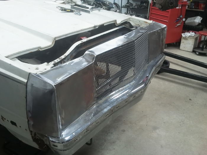

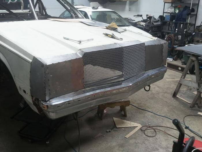

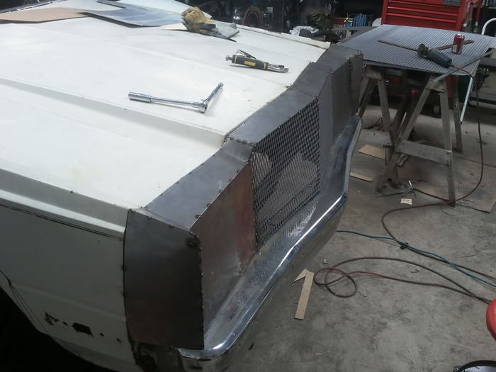

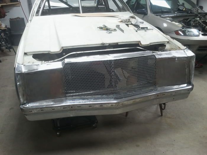

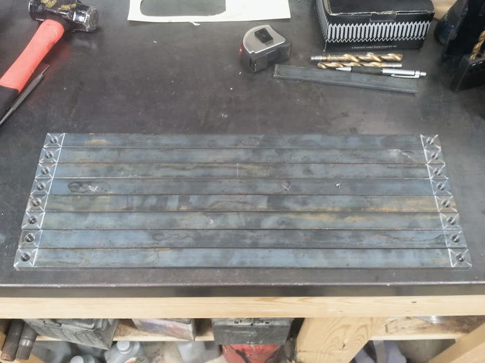

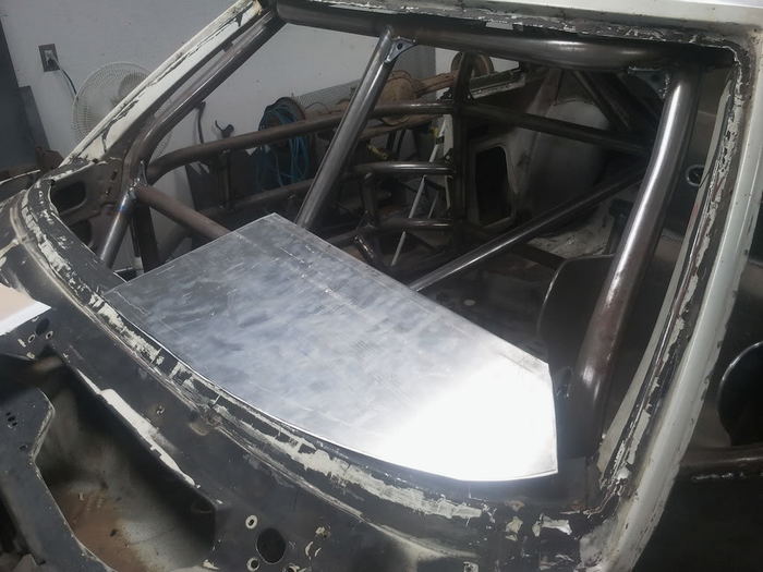

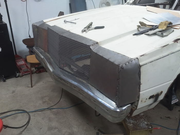

Got the sheeting all mocked up for my header panel, believe it or not but I can hardly tell the difference in weight between this steel one and the factory piece.
Just have to weld and finish it.

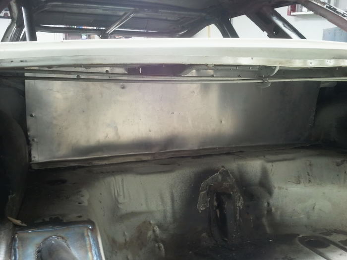

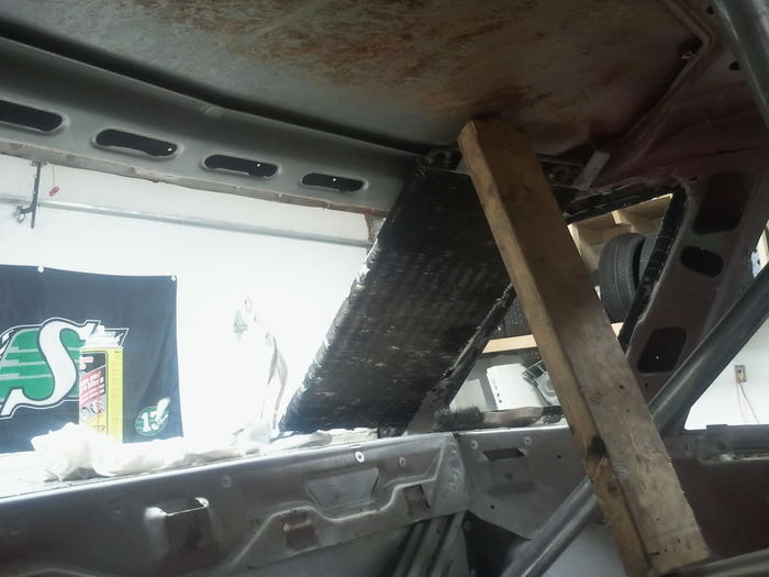

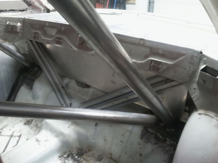

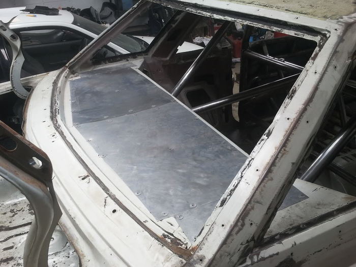

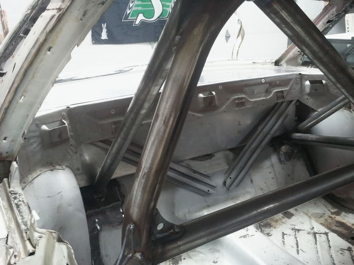

I also finished up the rear firewall. Nice light aluminum sheeting. I also absolutely LOVE my new air riveter.
So I got around to weighing those two header panels.
The old gutted fiberglass one weighs 19lbs with no brackets or stretch metal.
The new steel one complete minus paint weighs 21lbs.
Damn.... :D

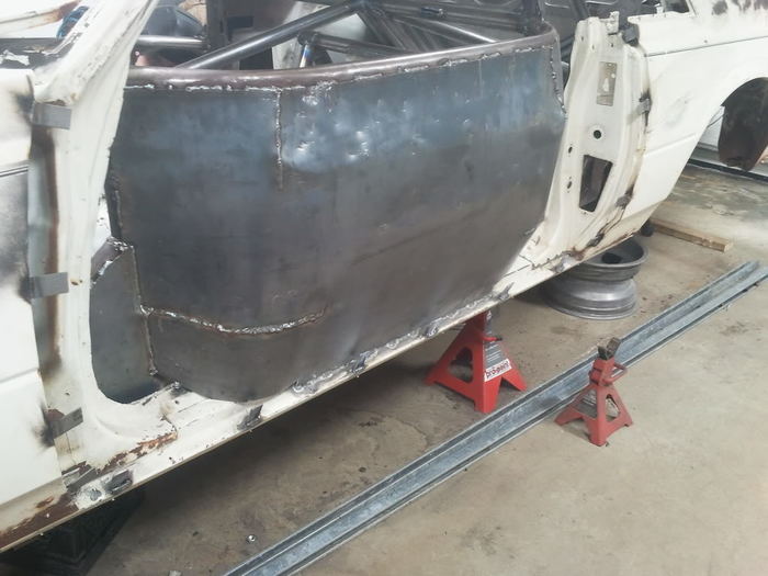

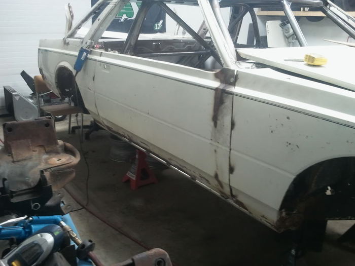

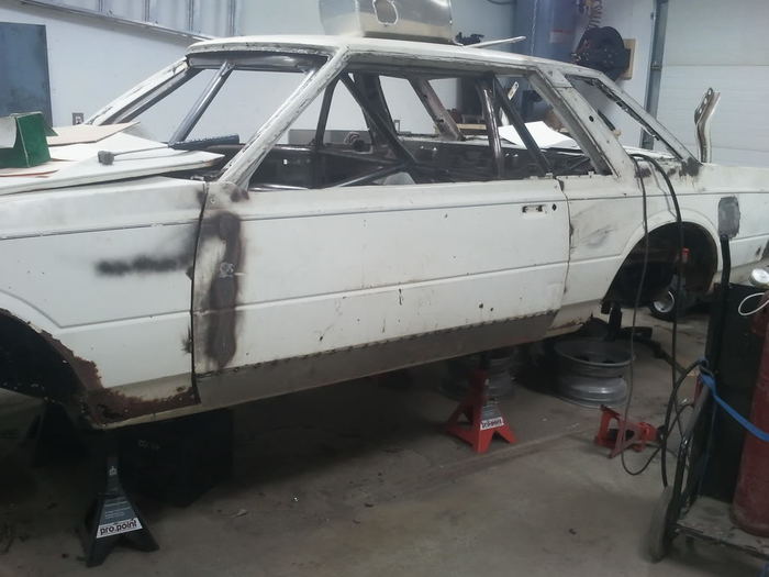

Got the door skin tabs mounted.
Fixed the drivers door skin and mocked it up into place. Going to drill holes and rivet it to the tabs.
Passenger side.

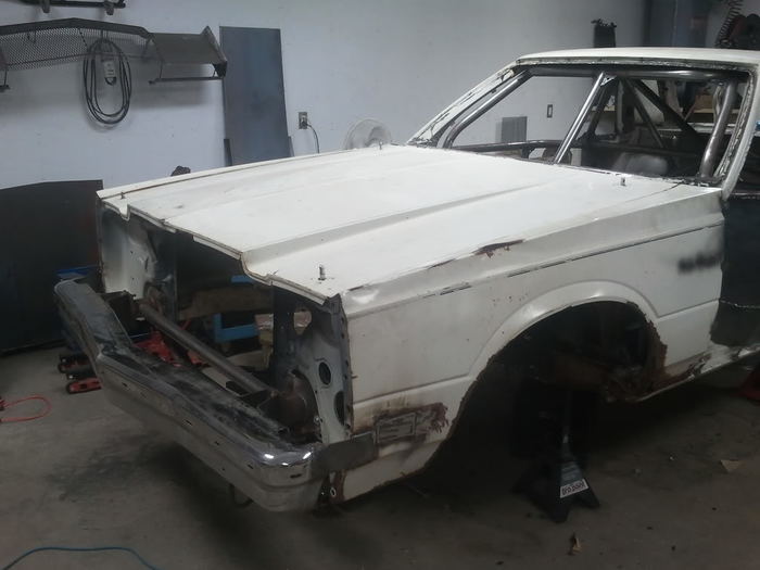

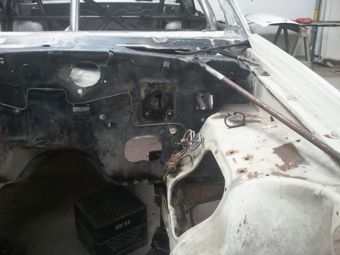

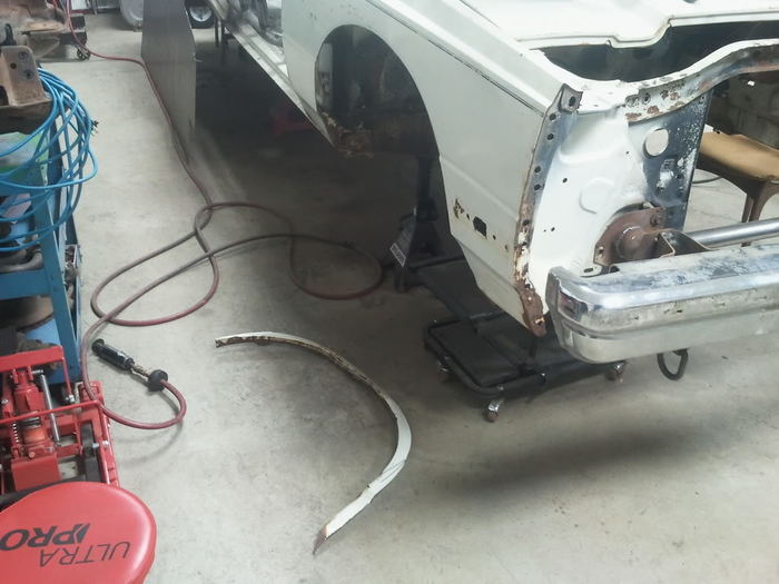

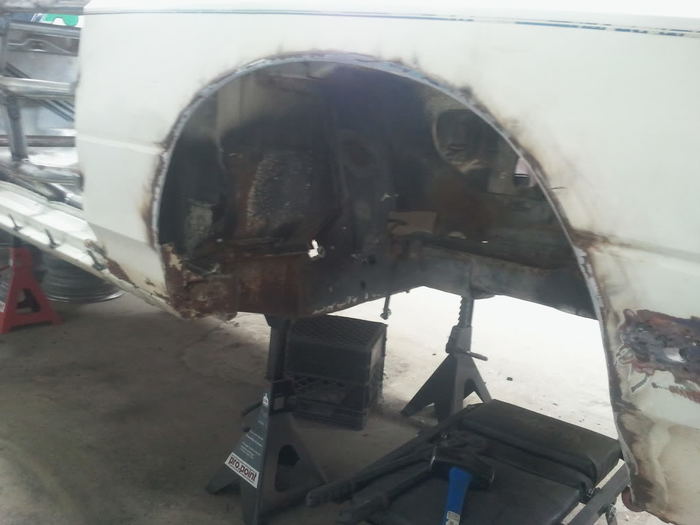

Cut out the right front fender opening, will be running a piece of 1/4" round bar on the inside of the opening.
Filled in the gas door. I'm thinking I might fill in the door handle/lock holes as well.

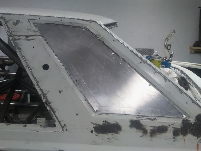

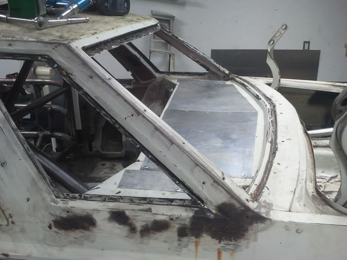

Worked with aluminum most of yesterday.
Can you believe that there is about 1/2" difference between these two 1/4 window openings?

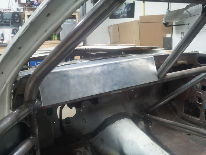

Made up my dashboard.

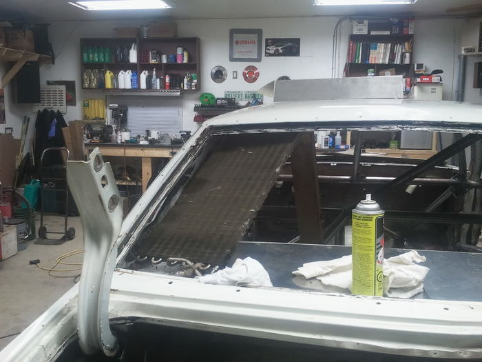

I think I also figured out where to put my factory '78 D-200 transmission cooler. What do you think?

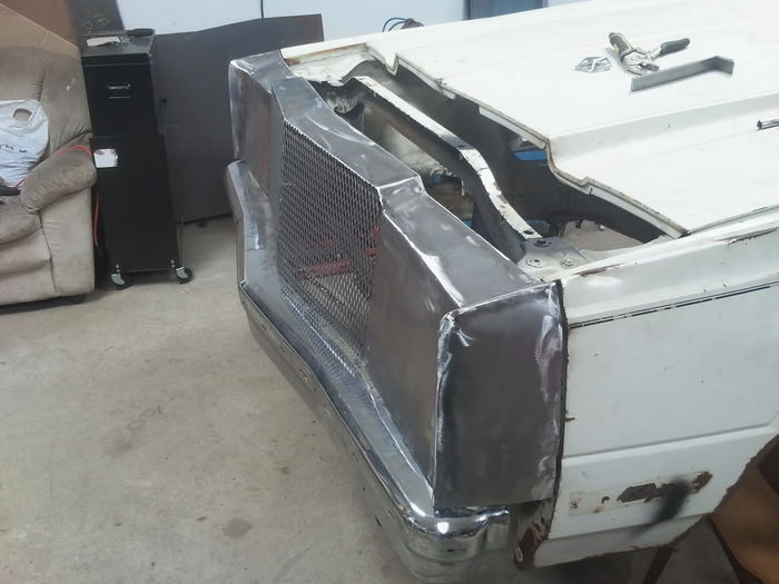

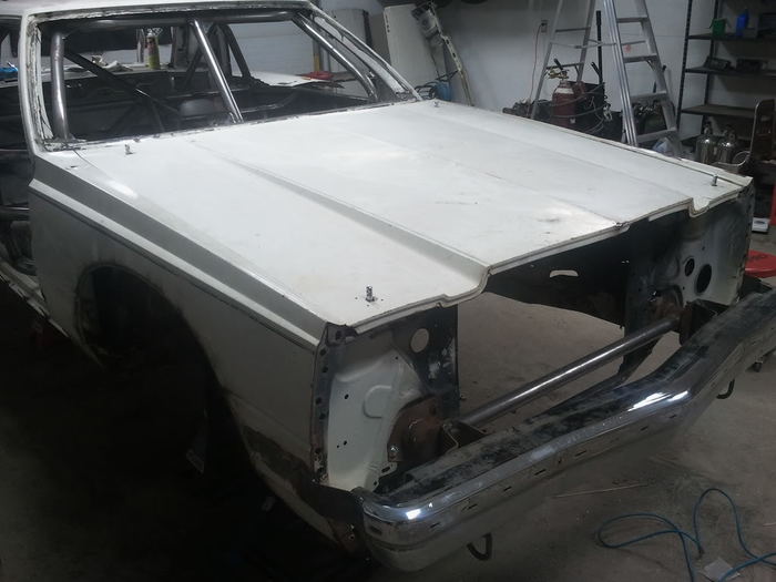

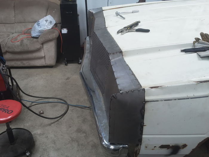

Got the front gap guards finished, the fender holes filled in and the hood pins mocked up.
I also fitted a piece of 1/4" rod just inside the edge of the fender to give it back some rigidity and to make that edge a little friendlier if it does happen to contact the tire.

Making good progress. With the tranny cooler back there, are you going to have enuf pressure to keep everything circulating so the tranny doesn't get too hot?
After I teak the valve body in the transmission there will be pressure to spare.

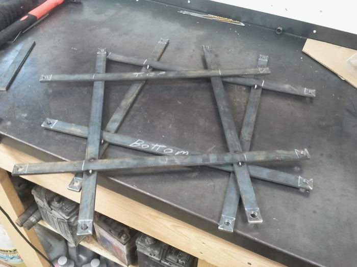

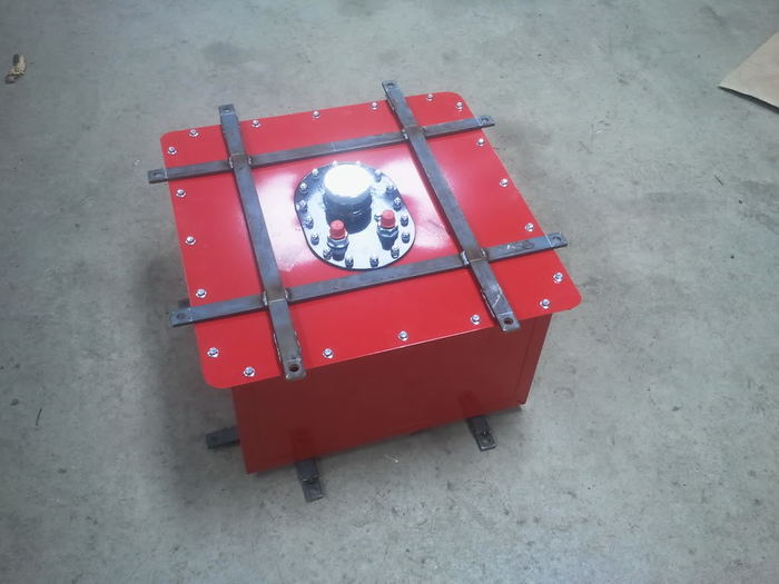

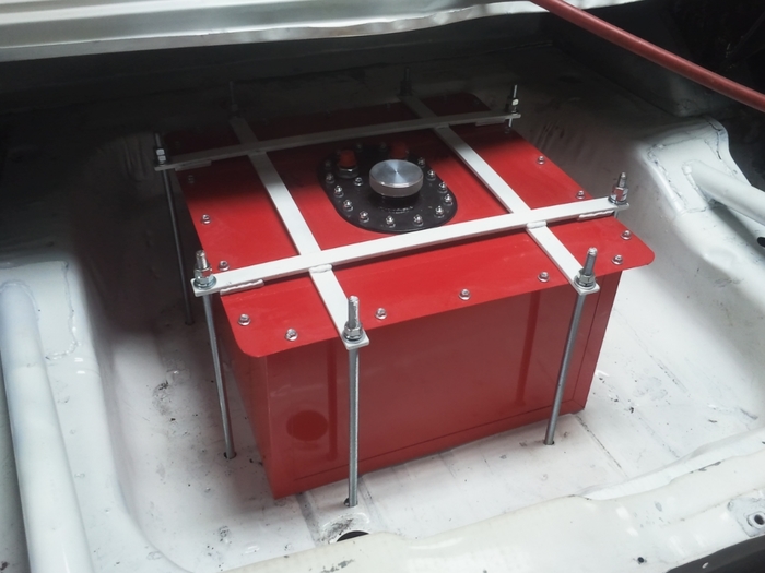

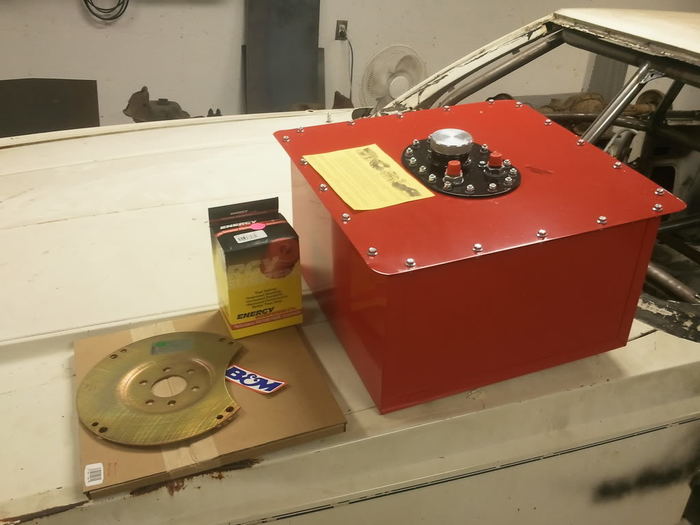

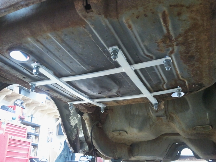

Made mounting brackets for the fuel cell today.

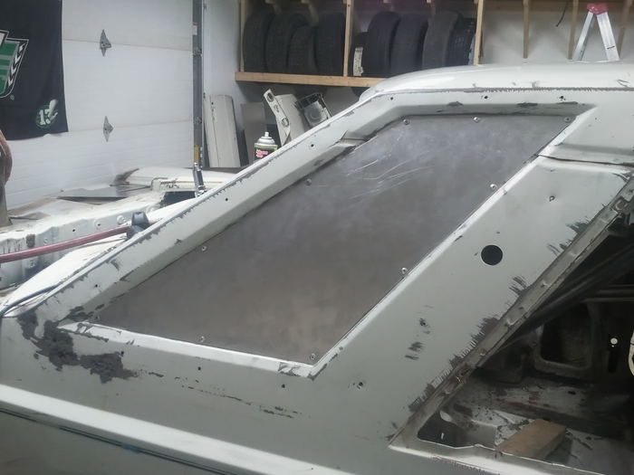

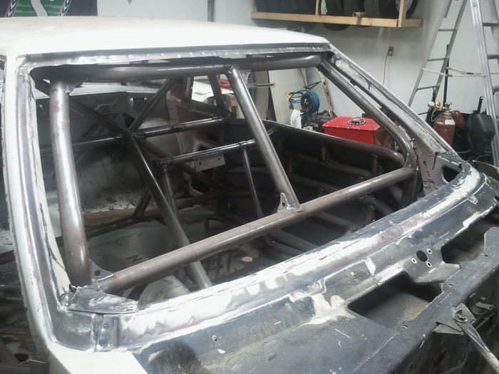

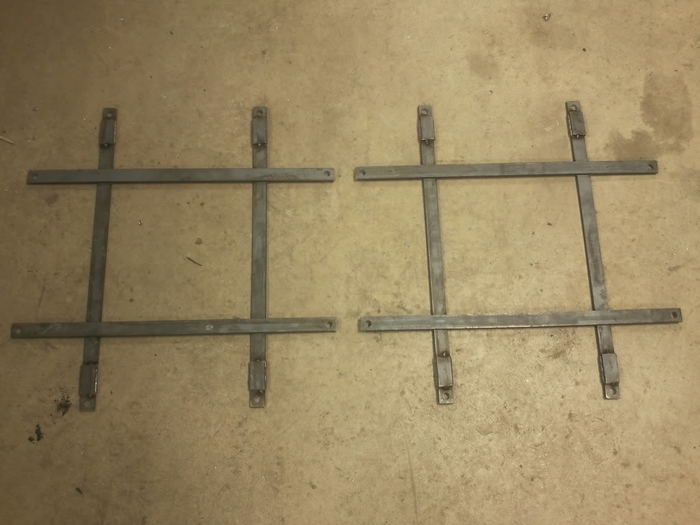

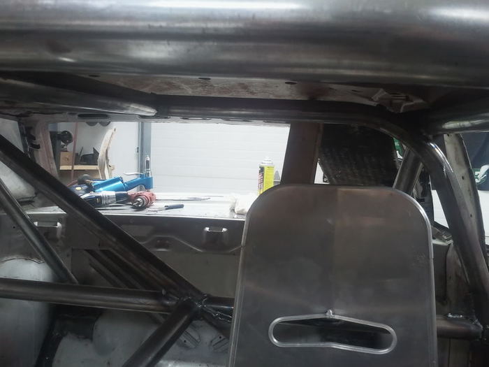

Cleaned the windshield frame and started making up my window screen. That was LOTS of fun let me tell you.

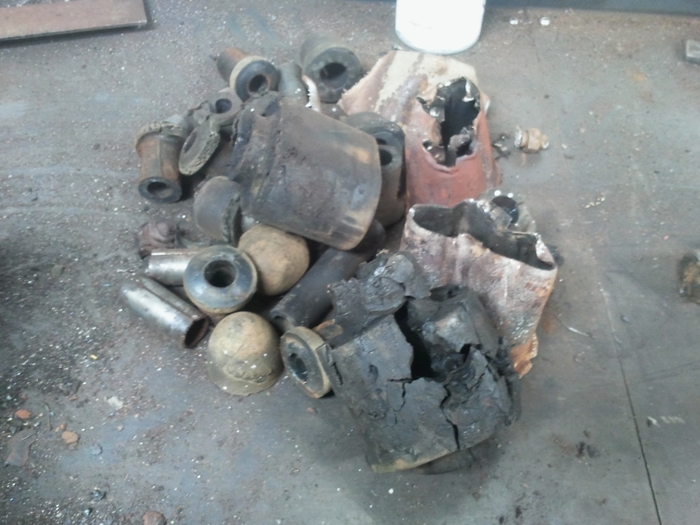

Pulled the old booster and master out as I will be going with manual brakes.

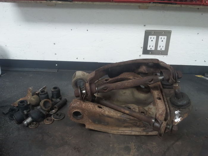

I had a whole bunch of fun with some old rubber bushings, my vise, some sockets and a heat gun.
Thanks man! :)

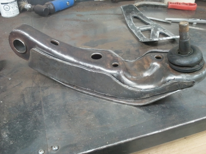

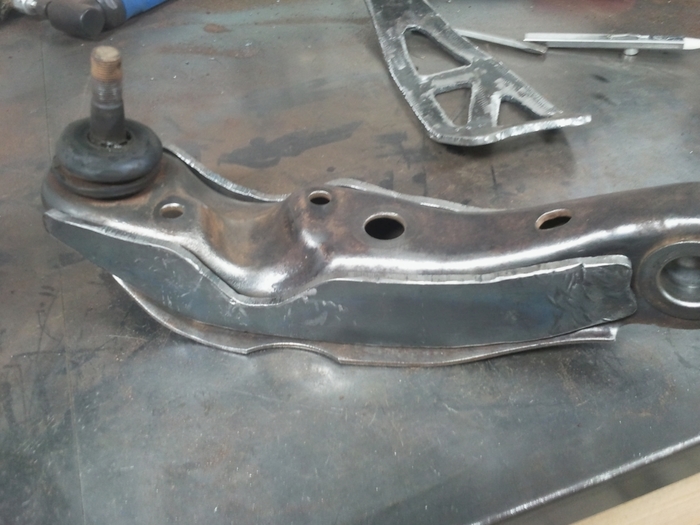

Finished up the most fun I've had in a long time.

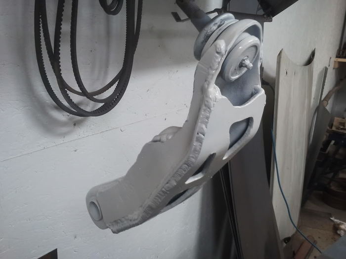

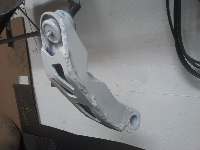

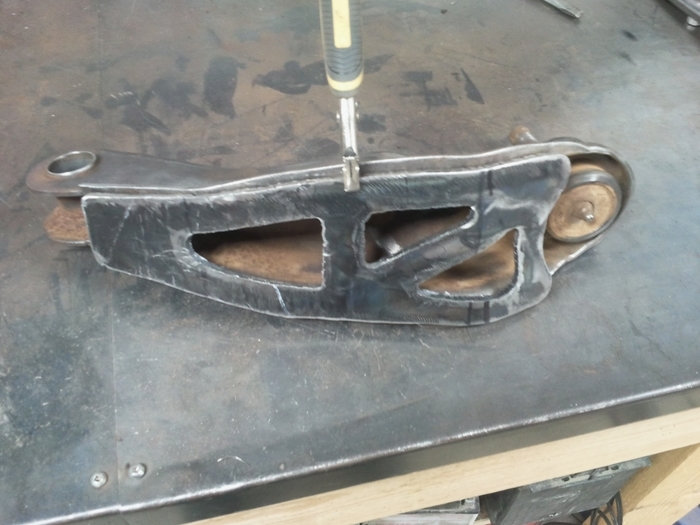

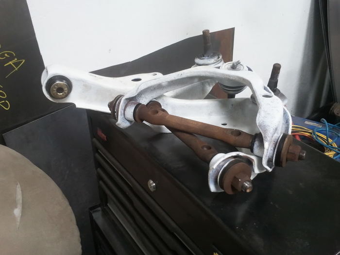

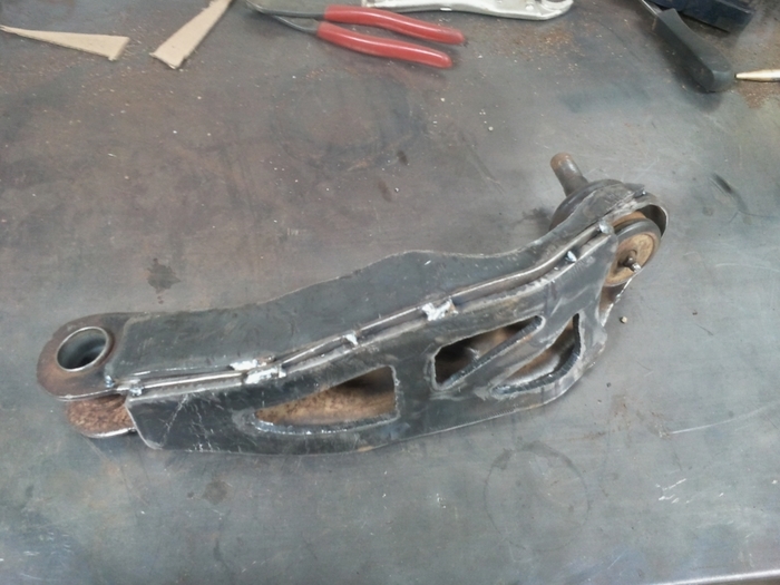

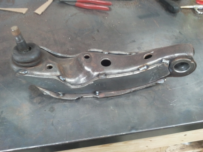

Finished the control arms.
Finished making the indestructible one.

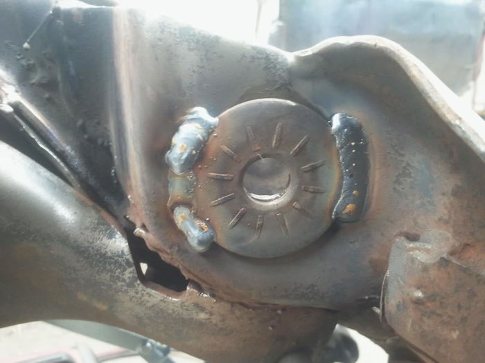

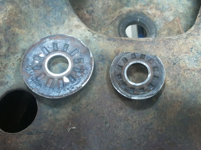

Used the old LCA washers as reinforcement for the LCA mounting location.

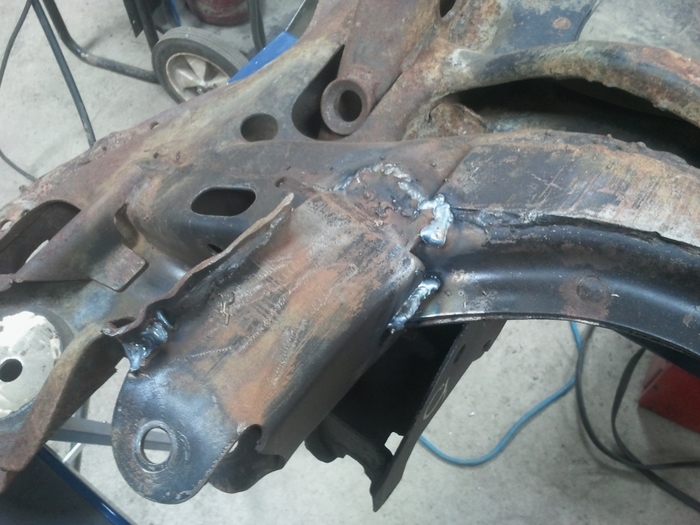

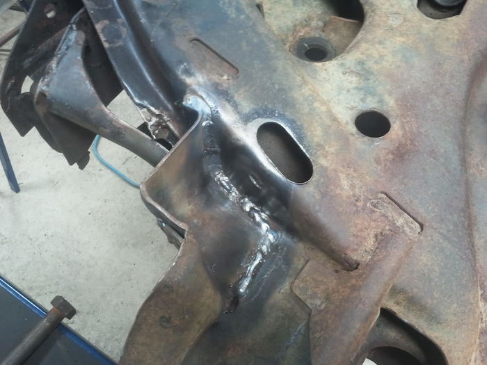

Started welding up the K-frame where it needed some more, um...... welding?
This thing is pretty sketchy looking.

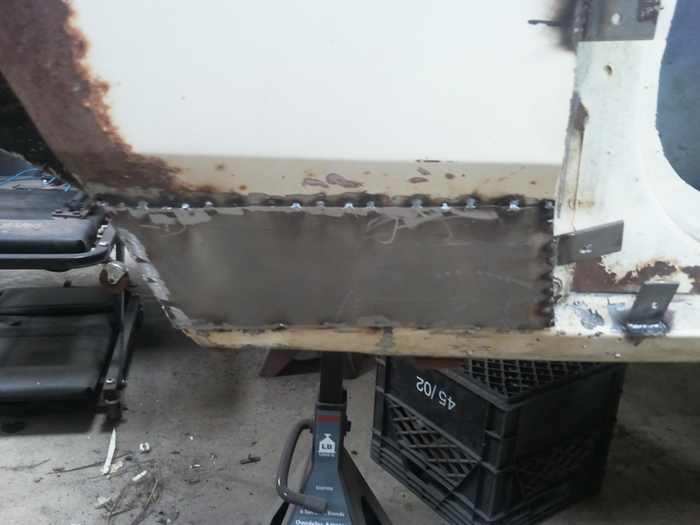

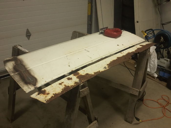

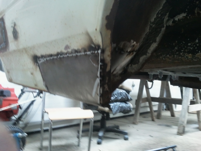

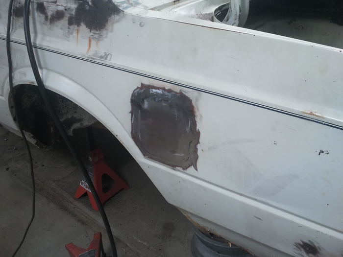

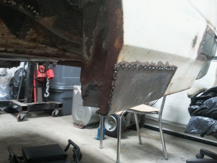

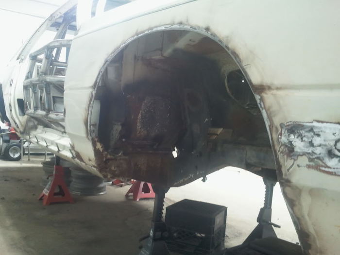

The father-in-law did up some rust patching for me.
and I got my fuel cell installed.
