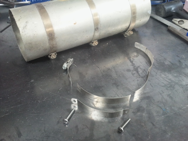

Well got some more work done on the car tonight.

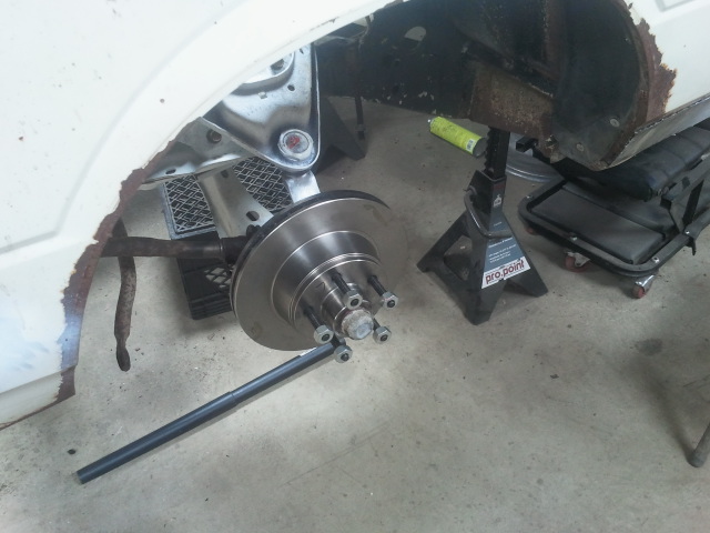

Finished prepping the 11.75" rotors, packed the bearings and installed them on the car.

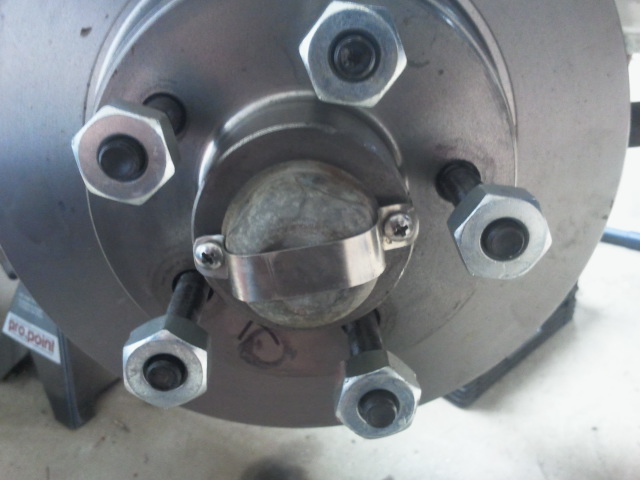

I also made some minor modifications to them, I drilled and tapped two small holes into the face of the rotor hub about 1/2" deep.
Then using pieces of hose clamp I salvaged from some old radiant heater couplers the neighbors at work threw away in our metal bin I made some straps.
Then using two stainless steel #10 machine screws I fastened the straps to the rotor.
I'm hoping this will keep the bearing caps from popping off, we just tack welded them on the shop's stock car but I was hoping to devise a way that is easy to remove and reinstall without welder.

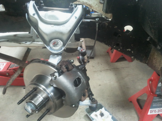

Finally after having some minor difficulty with sourcing parts I finally was able to get the front brakes assembled.
Calipers, pads and stainless hoses.

The caliper brackets I'm using are from a '75-'77 Cordoba and the pads and calipers are for a '72-'74 Challenger. All direct bolt on readily available parts store parts.
I wanted simple, durable and easy to replace and readily available. :)

You mentioned all the parts are readily available at the parts store. Does that include the caliper brackets? I thought since those aren't a wear item, they wouldn't be available and a wrecking yard was the only option. If they are still available, is there any chance you could let me know where and maybe a part number? Thanks.
kkritsilas
Jun 21, 2012
2,009
450
Calgary, Alberta, Canada
Steve2961:
The slider caliper adapter brackets are P/N 3880839. The 11.75" rotors are P/N 4126545. Both were standard on big block 75-78 Cordobas, Chargers, and Magnums. They were also standard on the 79-81 R body cars (Dodge St. Regis, Chrysler Newport & New Yorker, Plymouth Gran Fury). The calipers and pads from our J-Bodies are the same, and will bolt up to the caliper adapters. I have been trying to find a pair of these caliper adapter brackets for a while, with no success. As far as I have been able to determine, the caliper adapter brackets are not available new anywhere (either factory or third party), so junk yard or vintage parts dealers (I was quoted $150/pair, plus $80 in shipping (I live in Calgary, Alberta, Canada)) are the only sources. Rotors are available anywhere; pads are, too.

I've gotten all of mine from junk yards out here. They are cheap when I bought them, like $20 a set.
The ones on my stock car came from a '76 Cordoba with a 360 2bbl.

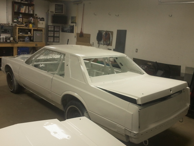

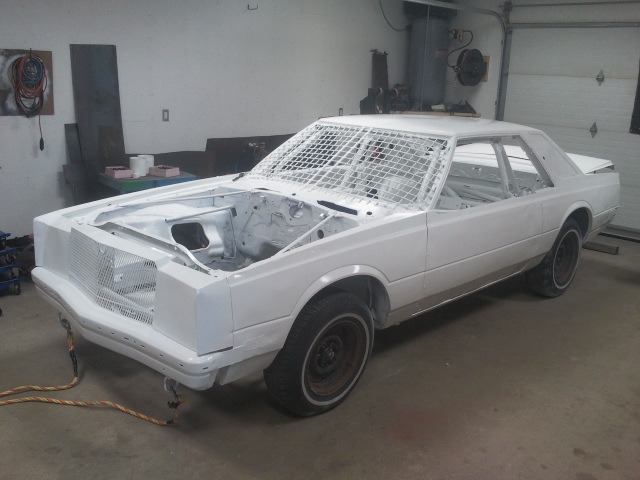

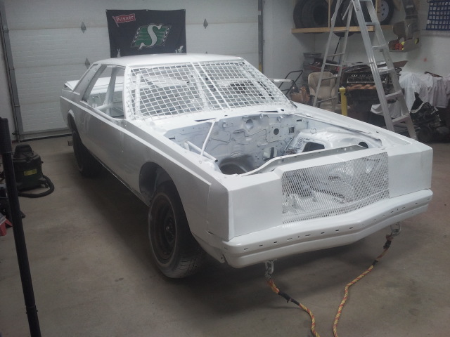

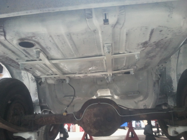

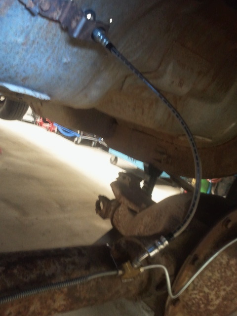

Finished up the rear brake line.
Going to paint the car and then set to wiring and plumbing it.
Got the bottom, engine bay and wheel wells painted today.

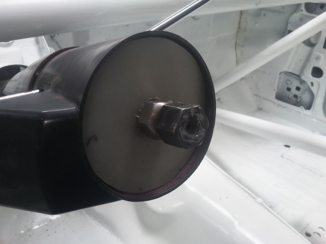

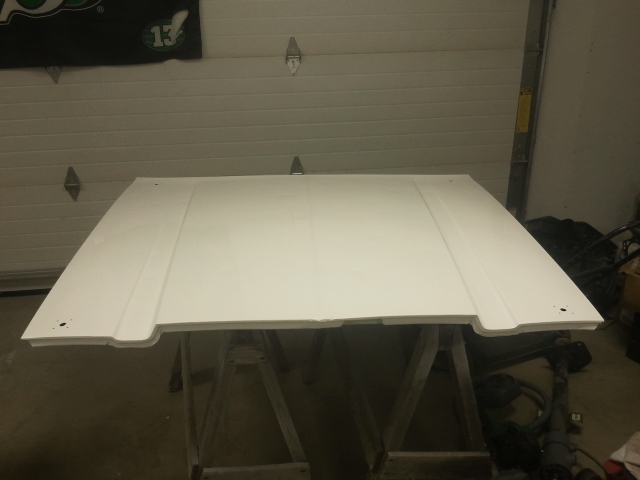

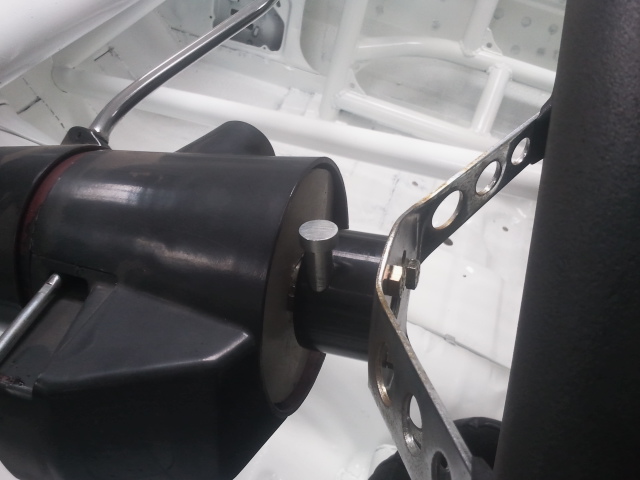

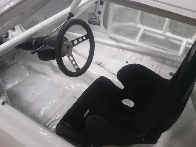

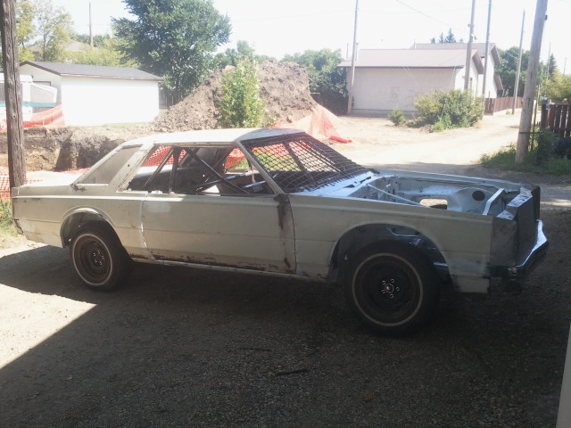

Did some more work today.
In the middle of rebuilding the engine for my Geo Metro to have it ready for when I got to school so progress has been slow.

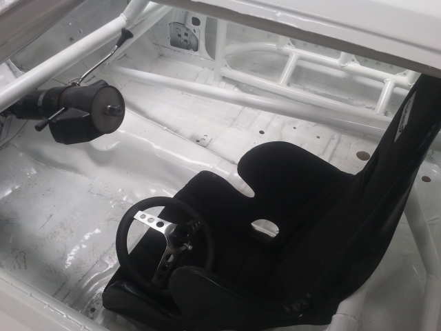

Got the seat and steering column installed.
With quick detach wheel.
The plastic dust shield is the lid that held the hardener on a can of Bondo. :D

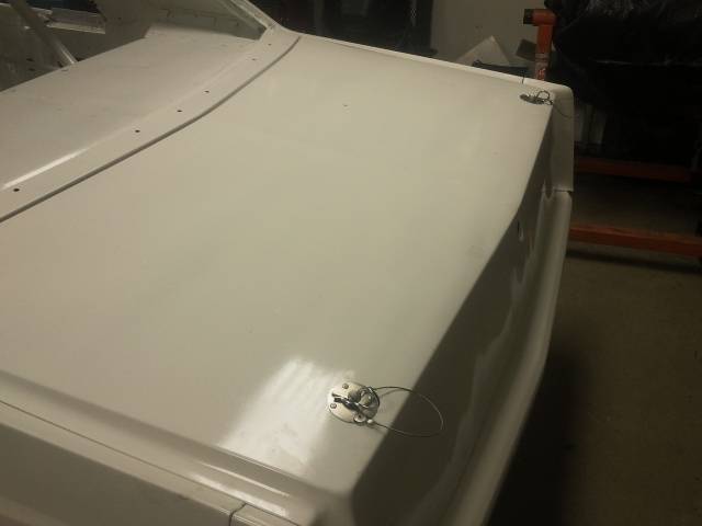

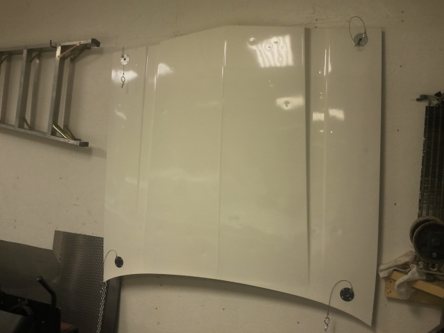

Put the pins and scuff plates on the hood and the trunk.

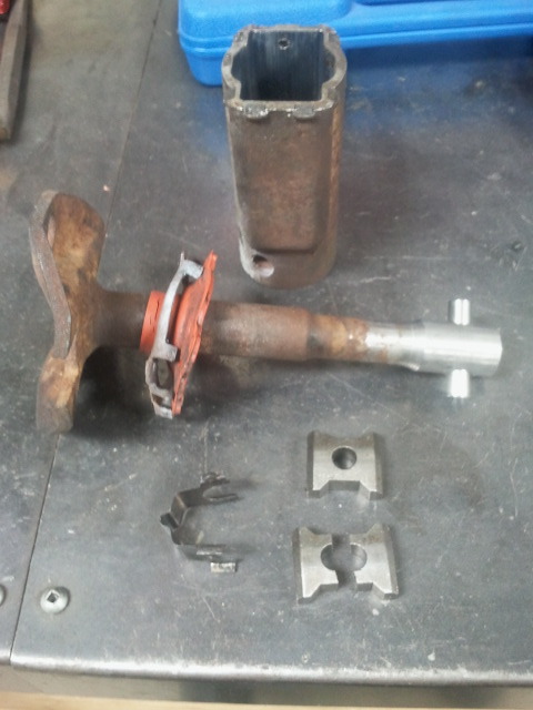

I would have finished the steering column install but my intermediate shaft is kinda screwed and it's the only one I have here in town, so off to the farm I go.
