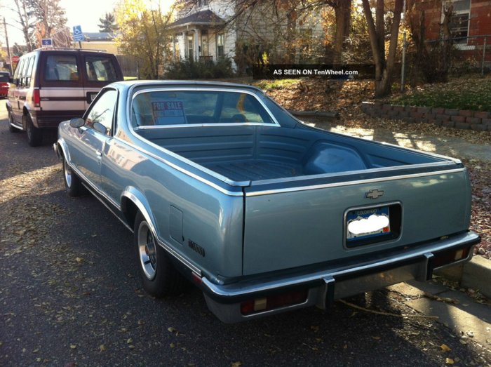

There's one thing that's always been in my mind about doing one is but never checked. I wonder if the dimensions of a '78 and newer actual El Camino are similar. Reason is, a person could use the back of the "cab", rear window and also the bright trim around the bed rails and maybe even the bed floor and walls. Yeah I know, Chevy parts on a Mopar is just wrong but sometime's you have to use what fits and works. If track width is an indicator, the El Camino is a hair less than 58" and an Aspen is 58 1/2".............Might even be able to integrate some of the rear interior trim also. Man, i wish I had the time, space and money to do something like this. I think it would be fun!
Sorry about the Chevy picture, lol.

You'd have to use a "B" body.

My main idea on grafting sheetmetal and rear glass from an actual El Camino was then you'd have ready made trim to make it look more "factory".

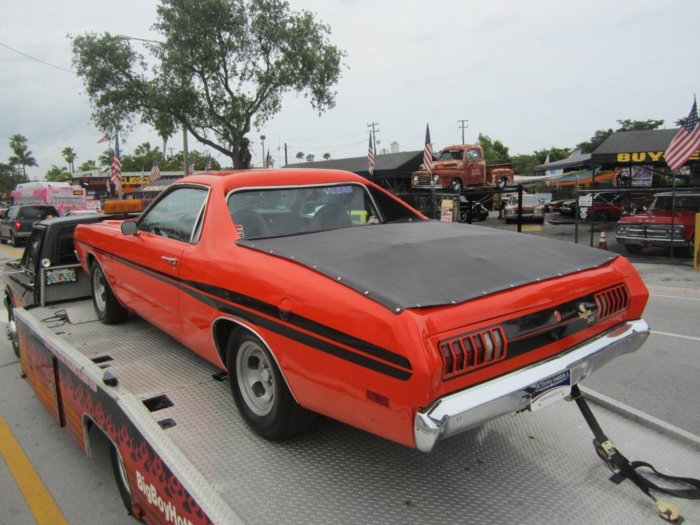

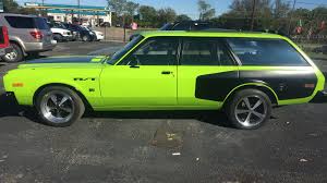

Ya it would be nice to see a 2 door wagon or car/truck done RIGHT, I think it may have to be made out of a coupe or maybe combine a coupe and a wagon lol Would be quite an undertaking thats for sure, would need a lot of ambition to create it. I've only seen a pic of a 2 door wagon once and it was a bit of a hack job made out of a 4 door wagon. Its too bad Chrysler didn't produce them from the factory along the lines of the Pinto sport wagon..the Pinto was a bit smaller than an F body, but you can see they designed and created the 2 door wagon with the panel sides instead of windows and it was a cool 70's creation (wow never thought I would use the words Pinto and cool in the same sentence).
I'm sure many have seen this 4 door that is a psuedo-2 door wagon, going for the 2 door wagon idea...anyone on here own this green car? Also the pic of the Dodge Demon A Body creation of a car/truck ...DemonCamino i guess lol
