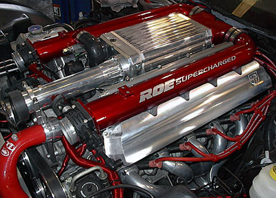

Can a 2003 Dodge Ram 2500 V10 & Tranny be stuffed under the Hood of a 78 Chrysler New Yorker ? The information I have states the V10 is only 4 inches longer than the 318/360 block now height and width I do not know. I am going to toss it around with local Mopar junkies tomorrow. It would have lower HP but mega torque and might be faster considering the New Yorker weighs in at 4500LBs and the Ram close to 7000LBs. I have access to a totaled 2003 Ram 2500. Just a thought probably not possible though. My first thought was to envision it in a 1977 LeBaron !

You need to start with something that has a long fan shroud. That's going to give you the addition space for the v10.
89.Fifth
Sep 5, 2015
444
110
New York, NY
Yeah it'll fit. The /6 is longer than the V10 so it's doable, but damn that's going to be a nose heavy car. My dream is a Viper V10.
I'm sure you can expect a lot of fabrication.
1,494
If an automatic (which V-10 transmission bolt pattern is different from anything else on the market place) it should fit - with some transmission crossmember modification and maybe floorpan modification (because the overdrive transmission will be larger and longer than the 727).
If a 5-speed or 6-speed manual transmission – again, you will need extensive floorpan modification (more than the automatic) and crossmember modification to fit (those are a monster size manual transmission – and it weighs about 750 pounds, by itself).
The engine mounts will need to be modified as well just about everything else.
I think you can spend a ton less money and do something with the 440 – and you know that everything will already fit.
Big block stroker kits are becoming fairly decent price wise, now.
The New Yorker will have a 9¼" differential with 2.71 or 2.94 rear gears (most likely). Getting a 3.21 or 3.55 ratio gear set from a pickup is easy to do and that alone, will wake that New Yorker up.

In agreement with BudW. The 440 has so many more options for additional performance that it is a much smarter engine to max out.
When I was working on my '73 Buick Regal and my '88 5th concurrently, at one point I had considered putting a 440 in the 5th - and it would have worked.. I however decided against it - maxed out the 455 Y block instead and had more than enough fun.
The V10 sounds like more of a novelty idea.. less of a benefit honestly.

I dropped the idea after consulting with the local pro's and contributors in this forum .
1,494
Getting off topic a little - even Dodge dropped the V-10 from their lineup on pickups, a bit after the new Hemi’s came out.
I think, mainly, because of the dismal fuel mileage the V-10’s got.
Ford still has a V-10 (I think . . . ) – but even they get dismal fuel mileage, as well. They are mostly for their big vehicles or multi-passenger vans (18 person or larger) - when a diesel engine is not wanted.
The Viper V-10 is a completely different engine – but same transmission and motor mount bolt pattern. Just about everything else is different. Now dropping a Viper engine into a car, I think, would have a lot more support on – but I think you would still have a LOT less money in modifying the existing 440 and a LOT less stress on getting things to fit in the car.
Please keep up us updated on this project!

As I stated in my initial post it was just a thought I was kicking around under the influence of grain alcohol ! I did toss it around with the Mopar pro's and they like you Bud stated it could be accomplished with major sheetmetal modifications running several grand in labor. And actually the 2003 Ram 2500 carcass was sold lock, stock, an barrel for $4,500.00 . I will stick with that V10 .......... 318 in my 77 LeBaron for now which I am having reconditioned , and lay off posting while drinking my own corn squeezings .
