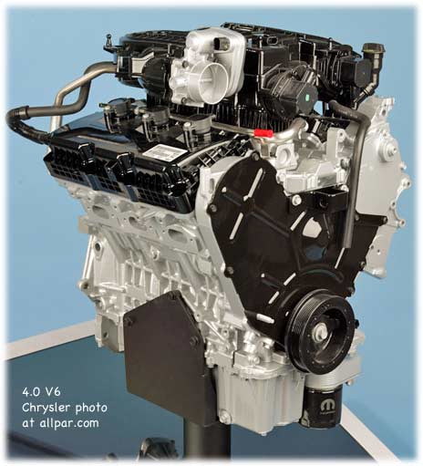

A 3.5L has a lot more power than what a 3.8L/4.0L makes. I've driven a 3.6L - but hadn't done a side by side test on the two (3.5L vs. 3.6L). I would "guess" the 3.5L makes more power - and is the V6 I would use.
The 4.0 wasn't based off the 3.3/3.8, it's just a bored stroked 3.5
Trust me, I used to own an LH car and the 4.0 Pacifica swap was big talk. I used to have very detailed data on the LH program and all the engineering that went into it. The 4.0 was a 32 Valve motor whereas the 3.3/3.8 were 16 Valve. There are some similarities but it's like Comparing a 318 Poly and 318 Magnum
89 Fifth I believe you are wrong on the 4.0 being a bore stroked 3.5L , maybe I read the article wrong though . Jeep 4.0 liter six cylinder engine
There are two totally different 4 liter engines. The inline six Jeep engine and the V6 used in minivans and the Pacifica. The V6 is based on the 3.5 engine from the LH cars. The inline six is based on the AMC Rambler engine.
The inline 6 was never used in the Liberty/Nitro or Pacifica. The 4.0 I'm talking about was the V6

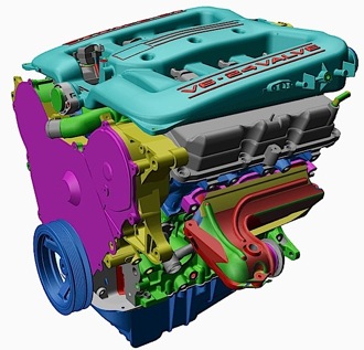

And here is the 3.5 V6 (First Generation with different intake) Notice the valve cover design and timing chain cover design
