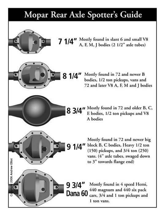

My '79 R/T has the 318/904 combo. Will it have a 8 1/4 with 3:21 ratio? Or did the only 360 cars have the 3:21 raito? If the 318 cars came with 8 1/4 diffs then I'm going for 3:55 upgrade. Thanks!

I've never seen a V-8 F/M/J body with a 7 1/4", that's not to say there weren't any though. On the other side of it, my dad's S6/3-speed manual '74 Gold Duster has an 8 1/4" not the expected 7 1/4", go figure.
alot of 6 cyl only had the 71/4 rear no need for the beefier 81/4 and weight

There should be a metal tag on one of the diff cover bolts with the gear ratio stamped into it.
I've torn down slant six powered F's with 8-1/4 rears and V8 powered F's with 7-1/4's.
I think all wagons and 4 speeds were 8-1/4's. At least all the ones I've had were. (4 wagons and 5 od 4 speeds)
