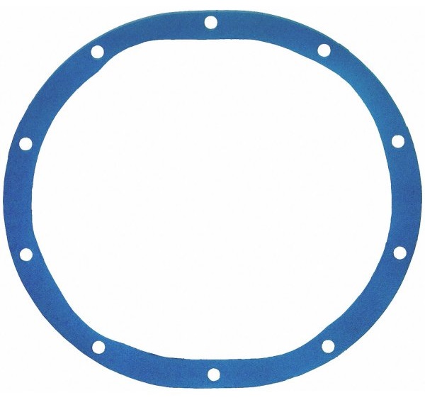

Two tips I have when looking at FMJ differentials.
First all 8¼” ('63 to 96) have an oval inspection cover, using 10-bolts.
And straight (3”) axle tubes

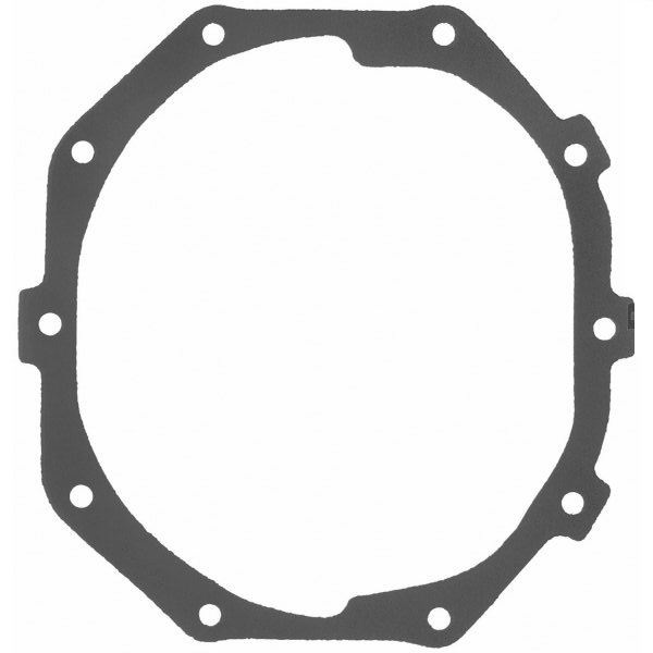

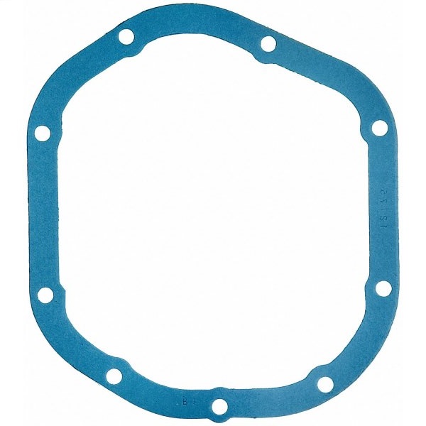

7¼” differentials changed a few things between the years. The differential covers are either (roughly) diamond shaped or (roughly) octagon shaped. The covers either have 9-bolts (earlier) or 10-bolts (later).
'76 to 81
'82-96
The axle tubes are either straight (2½” diameter) tubes (earlier) or 3” tubes that taper down to 2½” just before it goes into the center section (later).
