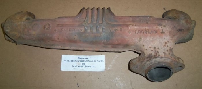

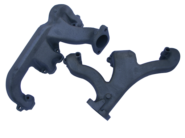

Both sides of the ’68-70 (or ’71) 340 HiPo manifolds (casting number 2863545 and 2863552) will fit any FMJ – but will caution that they will not pass the emission required states (cities, etc.). Note: the ’72-73 (and maybe ’71) 340 Exhaust manifolds look more like a slightly bigger version of 318 manifolds.

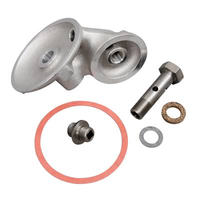

The passenger side will require a 90’ oil filter adaptor to work – but (not sure of exact percentage) most FMJ’s already have one (if car was built with a 3-cat converter system).

With exhaust pipe installed, an oil filter just won't quite go on straight.

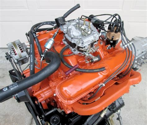

The drivers side exhaust manifold goes up and over the steering gear – which looks out of place in an FMJ vehicle – but fits and works fine.
You can see how the exhaust manifold covers the steering gear, in this photo (which was swiped from internet).

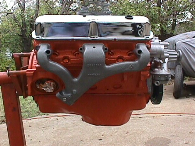

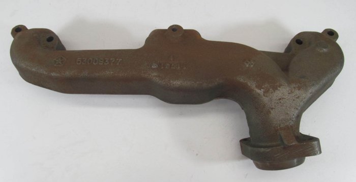

Flow tests show the Magnum exhaust manifolds flow almost as well as the 340 ones do. They also do not look as out of place (speaking about the driver’s side 340) as much in an FMJ – but the only Magnum manifolds that fit are the ’93-98 318/360 Jeep Grand Cherokee ones (casting number 53009376, 530093778 and not sure of the 96-98 Right side).
The Dodge Truck/pickup, Van, Dakota and Durango with 318/360 Magnums (any year Magnum) extend rearward too far, causing the manifold and firewall to want to occupy the same real estate.
A typical Left 318 Manifold
Left '93-98 Jeep GC 318/360 Magnum
left '97-03 pickup (all but GC). Other years are similar.

I have a pair of the before mentioned 340 HiPo exhaust manifolds which I’ve owned sense ’83. The Left one has been braised where it was once cracked and Right one has the exhaust heat riser flap removed (poor weld job on the holes). I also have an ’94 Grand Cherokee Left side manifold (cast number 53009477) so if I ever decide to something for small block (FMJ), will use the Left side Magnum and Right side 340.
FYI: the 340 manifolds mentioned in first paragraph, have 2-1/4” (57 mm) exits.

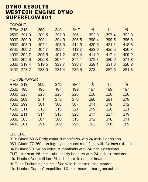

Here are the results of that first link. All small block manifolds flow enough to support right around 300 HP. Don't go on an epic journey to find a specific set. If you want manifolds then the ones that are most easily sourced and cheapest are your best bet.

As far as the Magnum exhaust manifolds go, the 318 and 360 uses the same manifold (unlike the versions pre-Magnum). If you find a Magnum manifold, it will not matter if a 318 or a 360.

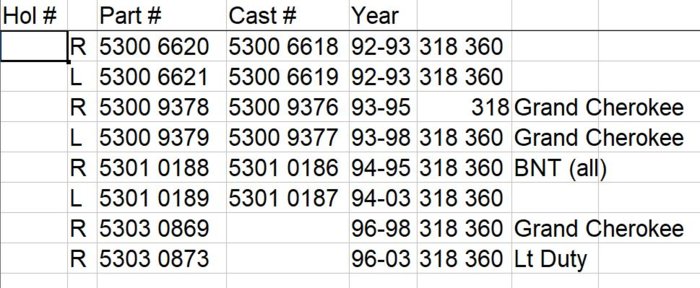

To help, here is the Magnum part numbers and casting numbers (which is not the same):
The two blank spots on casting number - means they have a number but not sure what it is, yet.
Use part number if ordering from a dealership.
Use casting number for identification and/or purchasing used.
Some might consider as good news is the ’94-02 pickup/van/Dakota Magnum manifolds are (or were) still being re-popped – but the pickup manifolds just don’t fit . . .
I hadn’t seen any other options for the ’92-93 pickups or for Jeeps. Also, the only Jeeps to get 360’s were the HiPo ones (so not that many).
