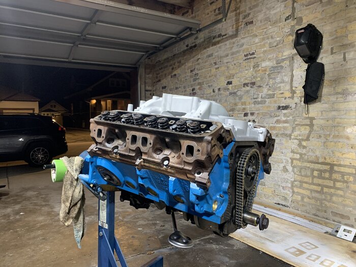

Have block painted, new brass freeze plugs in and center sump pick up installed. Deck and bottom are clean and ready for gaskets.
Still have to get timing kit on, disassemble heads and clean and paint them, reassemble them with new valve guide seals and get everything buttoned up.
Just looking at the Chrysler Corp blue block with shiny new brass freeze plugs and clean black oil pan mocked on it looked so much better. Just need to finish it and get it into the car so I can enjoy the extra 105HP.

God damn, the Pro Gear timing kit I used is tight. Went without the tensioner, wouldn’t have been able to get the chain on with it.

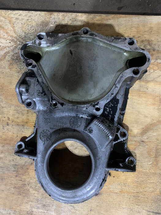

Got rockers pulled off. Will finish stripping heads down tomorrow and get them cleaned up and primed and painted. Was thinking about painting them aluminum/silver, but I do like that Chrysler Corp blue. Gotta finish degreasing and stripping my factory timing cover and get that ready for paint. Then I can get the oil pan all closed up and throw the top end all back together and call it done.
I go back to work Monday and wanted to get the engine in the car before then, but with a 6month old running around, I haven’t had the time that I thought I would.
Oh well, not like there’s anything wrong with the engine that’s in the car...doesn’t look half bad mocked up.
