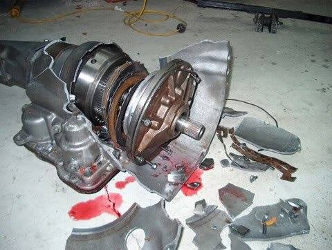

A good drum can help but they still let loose , a 727 can blow in the burnout box, on the hit and are dangerous to pedal.
I believe it's ATI that has a T400 case that bolts directly to a BBM, there are several companies who have a cut 400 case with a super bell. As you can see a 727 explosion is no joke and there's no power level that is safe, it can happen to a completly stock car. I'm going do the swap before my grandson starts running the Volare.

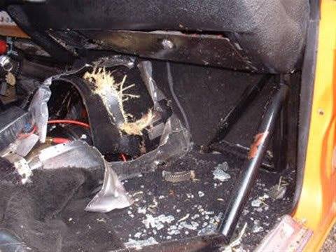

On the interior shot you can see the shredded trans blanket, the driver is lucky to have his feet.
View attachment 46764View attachment 46765

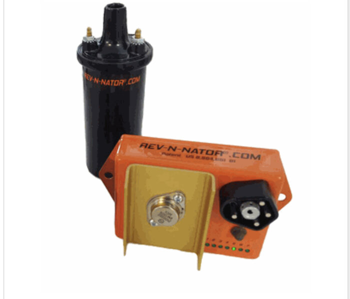

Good info. I’ve actually really wanted to get my hands on a, Rev-N-Ator (anyone hear of it or use one?) they’re a Mopar ignition module look a like with built in rev limiter and come with a matched coil to eliminate ballast resistor use (I know there’s other means of getting rid of the ballast resistor) however they haven’t been available since the start of Covid. Will likely just end up going with a MSD box purely for availability factor.
