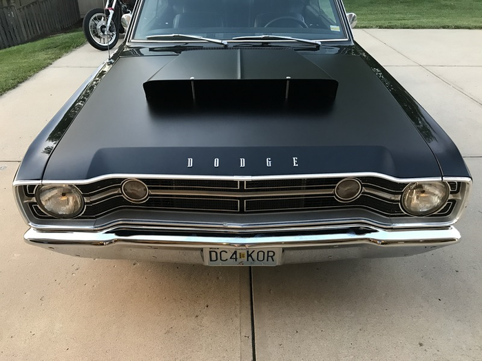

I’ve been looking at a tall version of the Maxwedge hood scoop or a hemi hood scoop.
I think either or would look pretty sweet on that big flat center of the hood.
