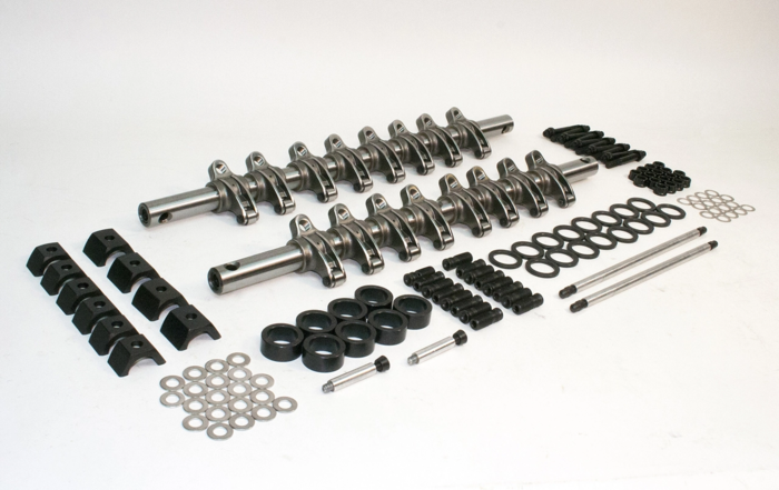

Hey Guys, Building a 408 magnum block. I would like to stay with shaft rockers. Any thoughts on a reliable way to oil the shaft rockers?
5,691
1,885
Rib Mountain (Wausau) WI
Hollow pushrods with oiling holes might work but, I am unsure if that would be sufficient to oil the rocker to shaft surface or not. It works for stud mounted rockers, shaft mounted maybe not?
The Magnum blocks have the oil passage bosses but they aren't drilled (from what I've read). Drilling them would work but some mods to the cam and bearings would be needed to allow oil to pass through.

It seems that Harland Sharp makes rockers that oil through the pushrods but that is another 900 bucks. I already have the la style through shaft oiling H S rocker setup. Hoping to use those.
5,691
1,885
Just dawned on me the pushrod cups int he rockers don't have oil holes, which would allow oil to get to the pivots. I was going to suggest PRW stainless alloy rocker set up. Less than HS but still $600+. I've got them on my BB and they work great (and also are a shame to hide them under a valve cover) but when I bought them, the whole rocker kit was only $290, 15 years ago. It says they're needle bearing in the description but they're actually bushed, which is better for street use.

Talked to Harland Sharp today, I can take them my rockers and they can change the adjusters and drill the rockers for through the push rod oiling, or I can run a line in the lifter valley from the the lifter galley to the block deck to where the head oiling port is located.
