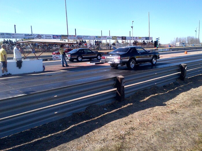

i had 28/9/15 slicks. with the 8% slippage i was over 6000 rpm at the top end with the 3.55 gear.
my R/T in right lane
