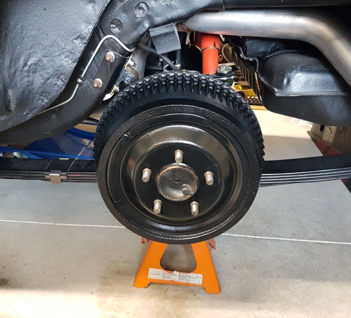

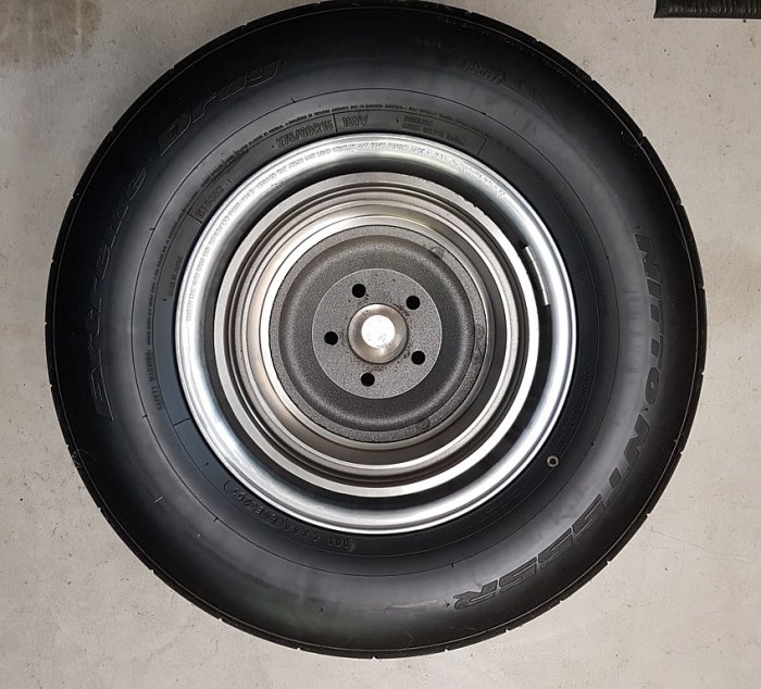

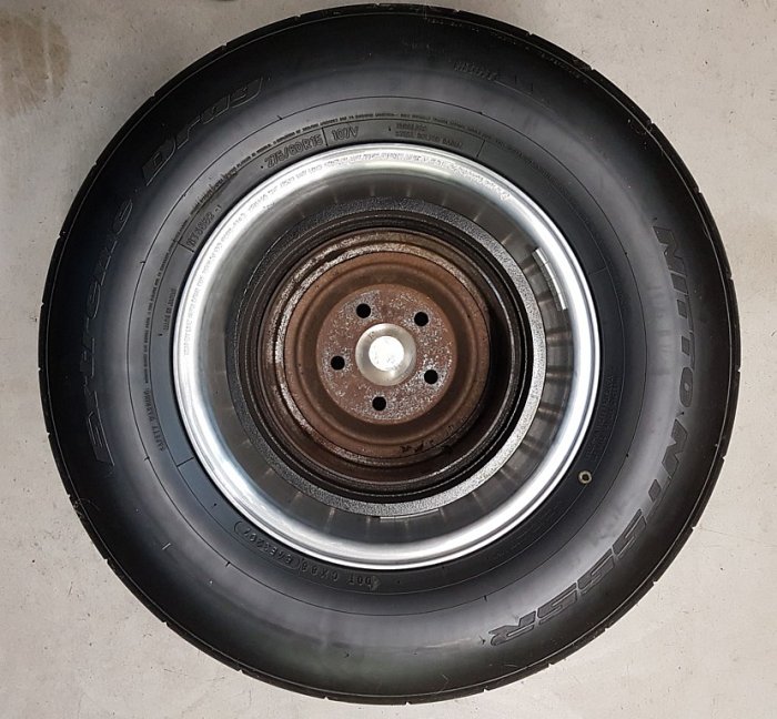

So it looks like I should be able to get the Coupe back on the road sometime next weekend...yikes...what a slacker I have become!!! LOL
The 10" to 11" drum upgrade is finally done...here are a few pics. Nothing fancy other than the clean hardware. Heck, I can't even take credit for this seeing as I had bought the assembled 11" backing plate & hardware combo.
For what it's worth, I am posting two photos of the 10" drum and 11' drum located in a 15" wheel...sure not much space is left on the larger 11" drum.
