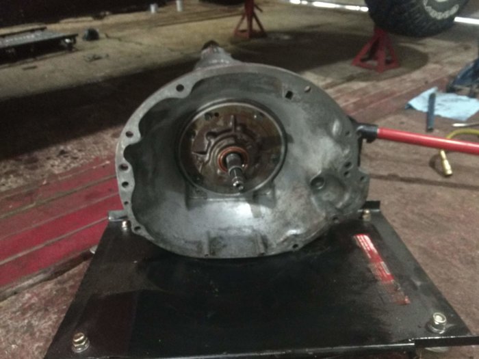

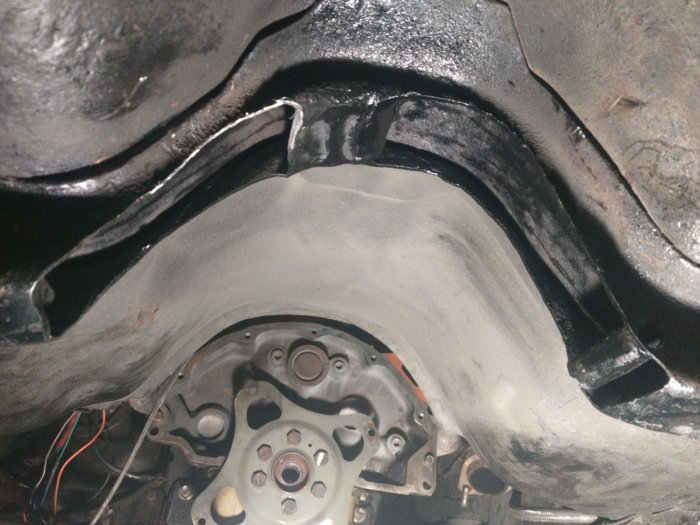

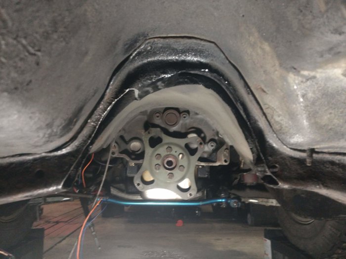

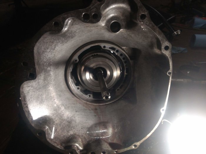

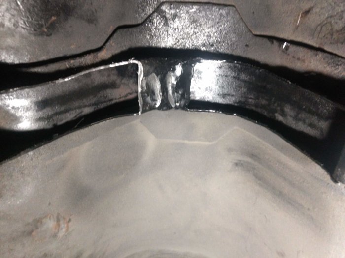

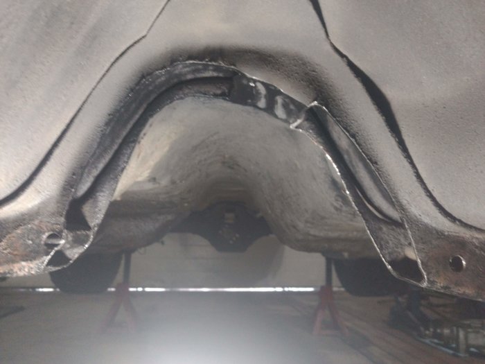

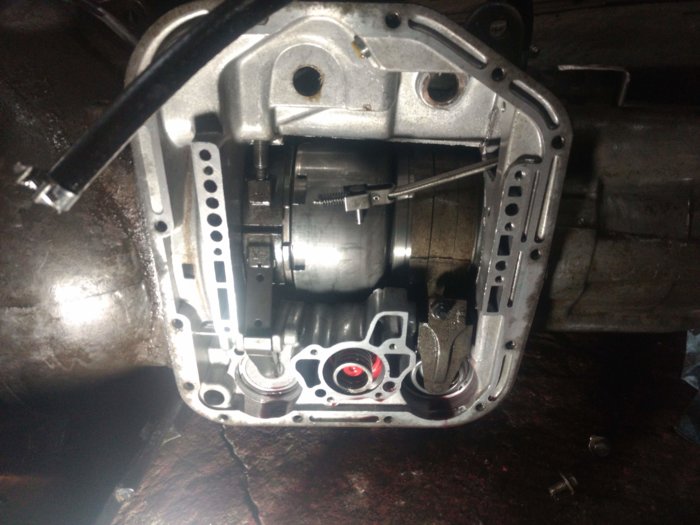

    More pictures of the trans tunnel since unfortunately it had to come back down to fix a front seal leak.

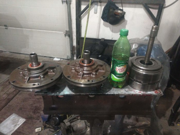

    Installed a 5 clutch drum and associated parts from my A999 while I had it down.
