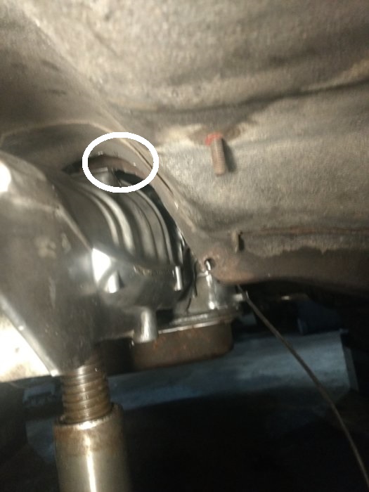

That doesn’t look too hard to modify the lower transmission crossmember.
What about the upper crossmember (the one welded to floorpan)? Any changes made to it?

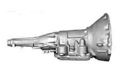

The transmission you have in your 5th Ave looks like the first one below, and is called A999 (which is mostly the same as A904, A998, or newer versions of same transmission is called 30RH, 31RH, 32RH).
The newer versions, the first digit is the number of speeds (3), second digit is the strength (0, 1, 2 ~ 9), third digit is which direction in vehicle (in this case North to South) and forth digit is Hydraulic vs Electronic (n this case Hydraulic).

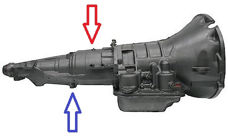

The four speed version is called A500 (or newer versions are called 40RH, 42RH, 40RE, 42RE & 44RE) and looks like this:
The red arrow is where the overdrive is located at. The blue arrow is where the different transmission mount attaches.

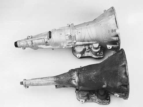

The heavy duty transmissions called A727 (or 36RH or 37RH) for 3-speed, or 4-speed version is called A518 (or A618, 46RH, 46RE, 47RH or 47RE), and looks like:
The A518 is top, 727 is bottom.

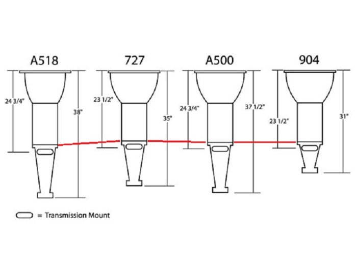

This chart was taken from that site and modified a bit. The distance from engine to case/tailhousing flange (red line) is the same on all A904, A998, A999, A727, A500 and A518’s.
The same also applies to engine to transmission mount on A904, A998, A999 and A727 – but is different on 4-speeds (A500 and A518).

I know the transmission crossmember has to be modified for the overdrive transmission to fit (which pictures in above posts show that).
I don’t seen any notes in this thread about modifying the floorpan or the upper part of transmission crossmember (welded to frame) – but it appears the upper crossmember might have been trimmed or cut to allow for the larger diameter tailhousing to fit, possibly (but could be mistaken).
This area is not a high stress area, like the older Chryslers are – so some trimming of parts shouldn’t matter a lot. That said, if trimming/cutting is required – it would be nice to mention that in the post – for other members here who is thinking about doing the same thing.
I like overdrives – especially ones that are a direct bolt in. That way you have a decent differential gear (for take-off power) as well as decent (better?) fuel mileage.
Zero problems with floorpan clearance on our cars (2 door F body's at least) but the upper crossmember needed to be cut/grinded significantly to allow the tailshaft to sit in the correct position. I would say probably about 3/4 of it needed to come out, the piece I left that you can see in the picture is about 1/2" of crossmember that I left in to keep the floorpan braced.
