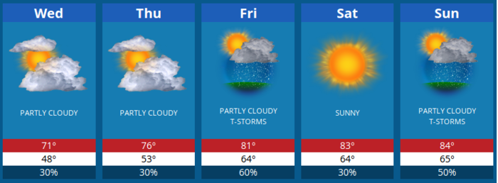

Yep, here we go again. Thunderstorms Friday night. That should cancel the cruise in again. I just can not get Darth-Car out into the world for people to see him. :( If they can not see him, they can not realize they want to buy him.
