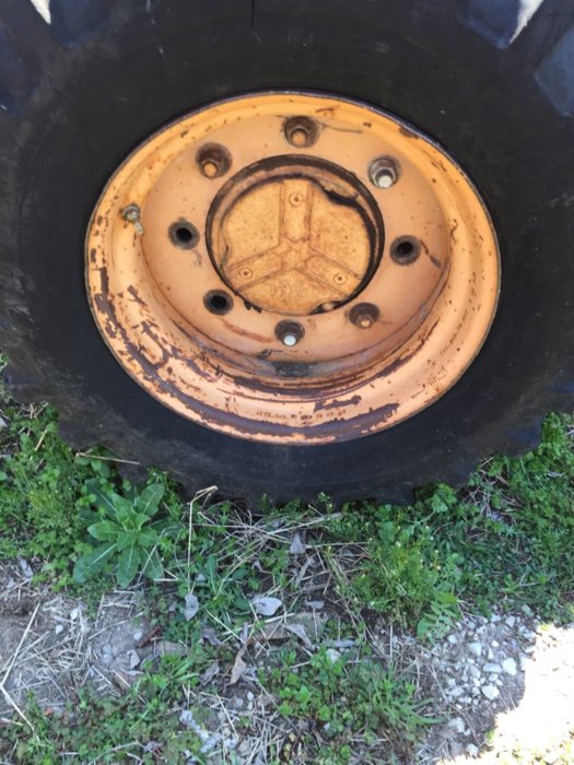

    I was looking at the backhoe watching the green coolant drain out of the bottom of the engine and started chuckling...
    The rim on the driverside is missing 3 (count em-- three) studs and lugnuts.
    JW
  8. Oldiron440
    Oldiron440 Well-Known Member
    2,279
    440
    Three out of 5 or 6?:)
  9. Justwondering
    2,744
    619
    3 of 8 are missing.
    I could just move some from the rim on the other side and fix it right up!
    (but wait, that's an Aggie joke or a Dumb Blonde joke isn't it?)
    JW

  10. Justwondering

    Maybe the pack rats took them over the winter?
