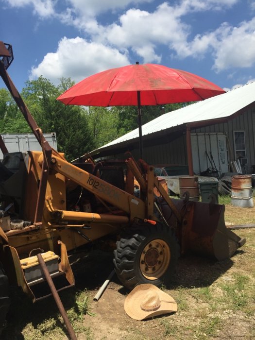

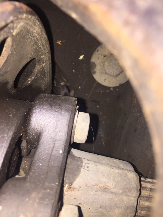

Three hours into the battle.
None of the recommendations was working for me so I figured out my own plan.
Loosen the shroud over the intercooler and radiator. Tip the shroud forward so I can remove the radiator and it’s hoses
Take the belt loose
Take the fan shroud off
Take the fan off.
The process requires you to drop 31 items (nuts bolts locking washers sockets ratchets cheater bars). Doesn’t seem to matter what combination just drop assorted things and pick them up for three hours while you search for tools.
Use two 16mm wrenches. One to hold the second bolt to keep the coupler from moving. And one to actually use with a cheater bar to loosen the bolt on the coupler
Same bolt everyone said was finger tight and comes off easy. Not.
Then just as you get the first of four bolts to loosen reach up to swat a red wasp away from your face, accidently nudge the cheater bar, watch helplessly as one of the 16mm wrenches falls into the housing, and realize you can no longer turn the coupler to get to the other three bolts
And
You can’t fit your hand in the housing
And
Your nifty magnet can’t pick it up cause it’s on a string and adheres to everything closer than the wrench in the housing.
No victory
No success
I’m thinking stalemate at this time
Other than removing 15 gallons of hydraulic fluid and pulling the front hydraulic pump I don’t have any sort of idea what to do next
JW

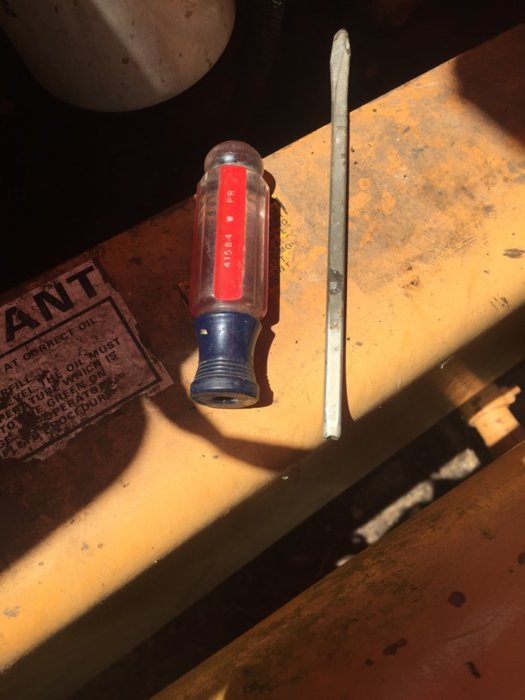

Now 5 1/2 hours into the belt removal and I have two bolts loosened, one casualty of war (screwdriver), and temp in shade is 92. So I’m calling it for today
Will try again on Friday
Work area
Objective
Casualty
JW
