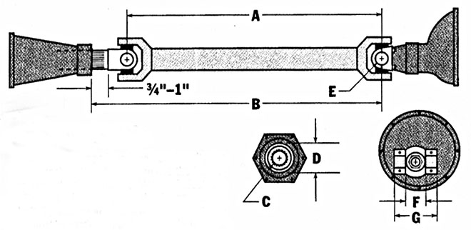

Hi Guys,
Ok I am getting closer to doing this swap so I can give my 360 a bit of angry without the fear of the 7.25" diff exploding its guts out all over the road!
So I will need to get my driveshaft altered, is it as simple as looking at this here
http://www.crankshaftcoalition.com/wiki/images/2/21/Mopar_rear_axle_dimensions.jpg
and getting my drive shaft shortened by 1.6 inches? (11.69" - 10.09")

It is almost that simple. The best way to calculate drive shaft length is to get the new rear installed and setting on its wheels. Then install your slip yoke and measure the center to center for the u-joints. If my memory isn't to foggy, the slip yoke is suppose to have about half an inch exposed behind the trans seals boot, but I will look that up.

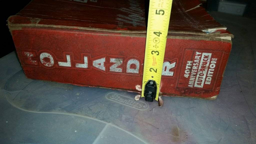

An old Hollander would list drive shaft lengths that were available. 904 with an 8.25 was common. I will see if I can get to the local libraries collection. Probably some time this evening.

Local library sold their damn Hollander interchange books. So I had a buddy measure a couple of shafts he had and both are 52.5" center to center.

Measurements of shaft are Center of Universal Joint (or U-Joint in short) to Center of U-Joint on the other side, sometimes referred to center eye to center eye or C.E. to C.E. Tube diameter can make a difference as well as U-joint size (in your case a “7260” which is standard (only option) for your car.

There are lists of shaft lengths out there, but I hadn’t seen a list online for ’75 and up cars – except for an interchange company by the name of Hollander, which sells (massive size and expensive) books and software that will tell you just about anything you want to know.
I have a well-used book for vehicles made from 1964-74. Later year books are three times as thick, then it became available in digital format only.
In this case, I would measure your existing propeller shaft and I expect it to be about 1.6 inches longer than 52.5 inches. If so, then get yours cut down to 52.5 inches (or 1.6 inches shorter) and you should be where you want to be at.
When shaft is back, insert it into transmission as far as it will go (frontward), and you should have about one full inch before it seats into the rear yoke.
