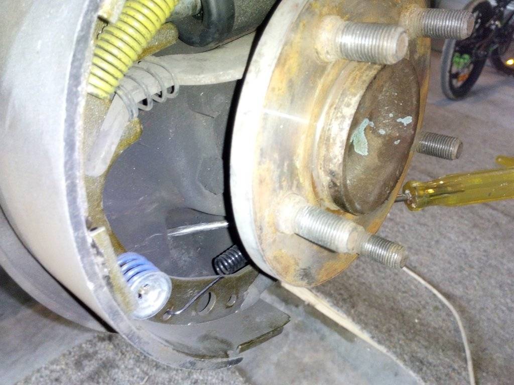

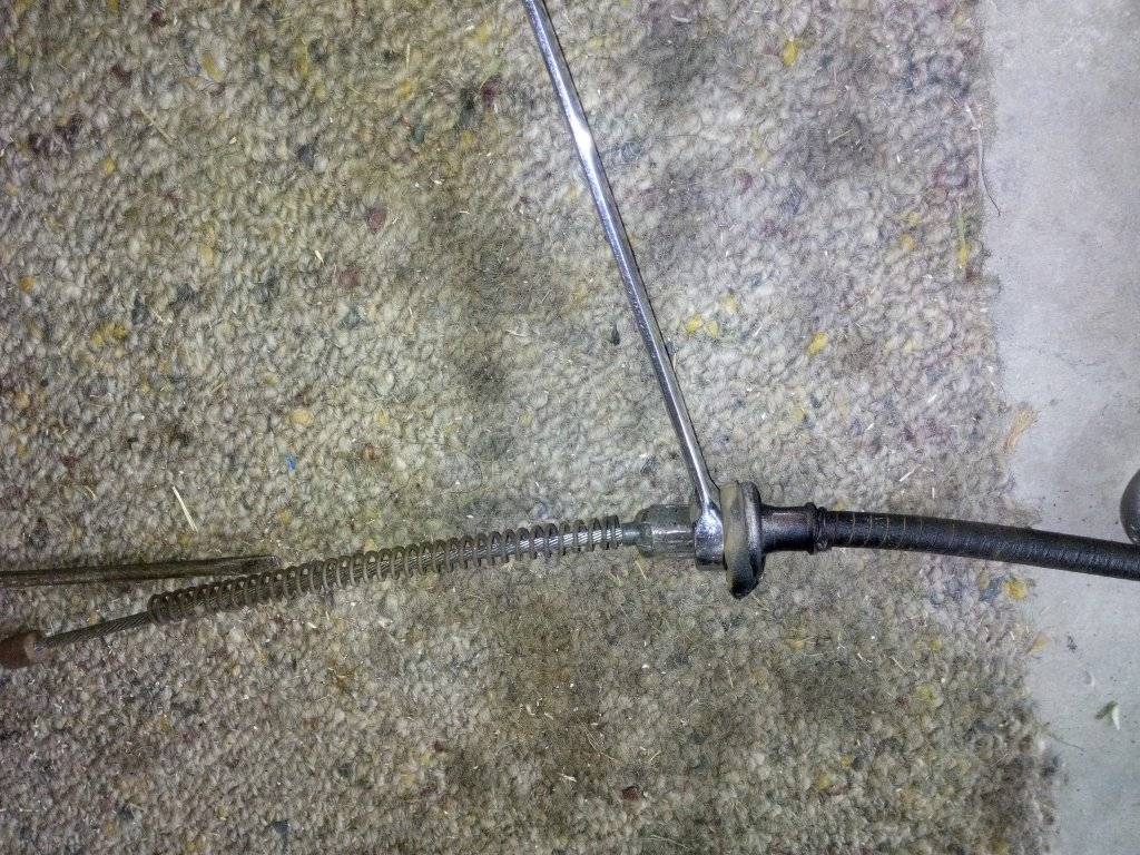

Rear end is in!! Found and easy way to get those clips off the park brake. Take bottom spring off, take auto adjust cable off adjuster, drop adjuster, open shoes at bottom a little, get pliers in there and pull spring back, get finger in there and push it out of the lock, slip a 14mm ring over the clip then, tap the ring spanner on with a screw driver, then there is a we cut out in the cable holder you can put your screw driver on and tap tap and its out, easy as total of 5 mins but took me to the 3rd time to work this out :)

Here are some pics, you can see the screw driver has good access, then how 14mm ring fits perfect, then where you can locate driver to tap out. Very easy and quick.
