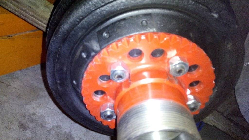

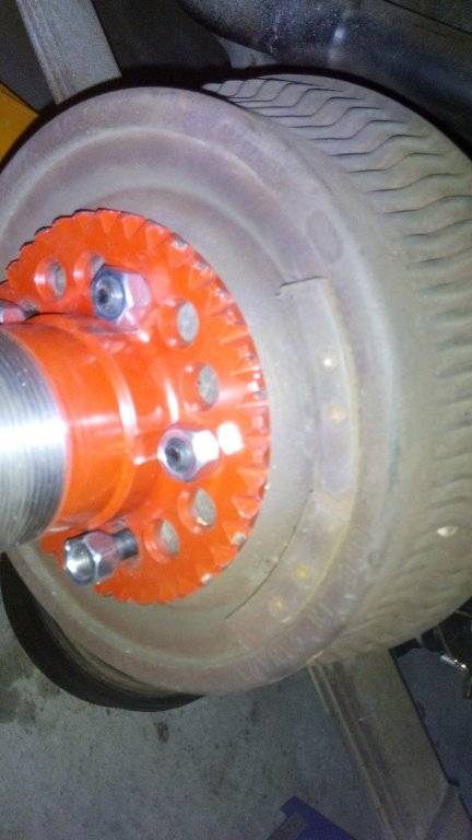

Results - Ok, I have been out for a drive! Its a completely different car! Its got a lot more get up and go and the jelly ride rear end has gone, still have the addco front bar to fit (still have the factory one on at the moment) Sits much flatter on the corners now!! Its starting to go real nice! So all these things are starting all come together, it sits on the road quite nice now!!! I will take a video at some point and up load it for you guys, will do an unofficial 0-60 run as well, hmmm that might be hard since speedo is pinned all the time! oh in drive under full acceleration it chirps the tires from 1st to 2nd, that's pretty good :) Just have a few things to iron out, my knock on wheels are not bolting on tight I think they are fowling on the balance weight on the drum, will look into that another day as I didn't notice it straight away so hope I haven't damaged the adapter.

ok changed the drums off the 7.25 onto the 8.25 which seem to be better anyway, they have fins on them and are quite a bit larger all round, set up the shoes so just touching and adjusted the park brake while I was at it and now it works nicely! But 10pm now so bed time, been a busy but productive day on the car front! Test drive tomorrow all going well :)
8.25 with adapter, note how close balance weight is to teeth
7.25" drum on 8.25" rear now, note balance weights miles away and below the adapter
