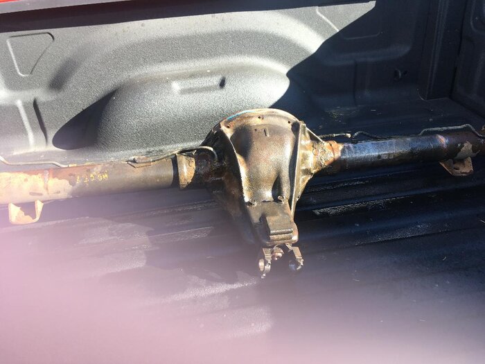

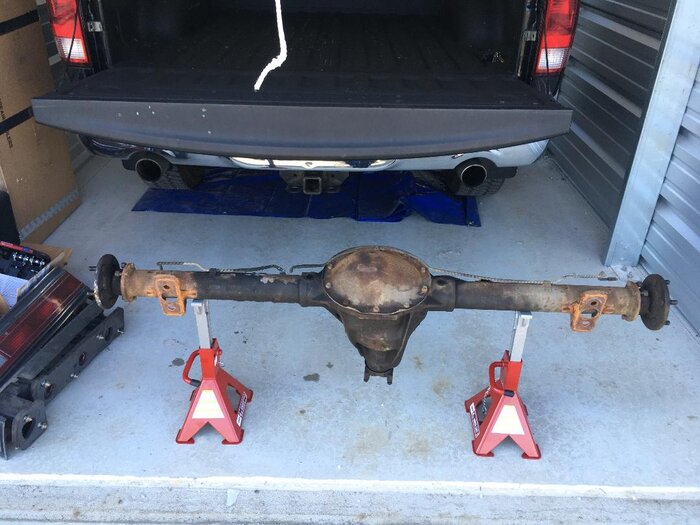

Please forgive me if this topic has been discussed to death, but I have an 8.24 rear end with 2.45 gears out of a late 70s Volare or Aspen coupe for my 88 Fifth Ave. I want to upgrade to 2.94 gears for better city performance, while keeping this an open diff, if possible. The issue I've run into at this point is finding an empty carrier case for this upgrade, so my question would be to those of you familiar with the 7.25 to 8.25 upgrade, can this upgrade be completed while keeping this diff open? I see universal empty carriers available and plenty of limited slip/posi, even a couple lockers available. I appreciate the advice and recommendations.

does this one need a new carrier to change the gears? my understanding is the ring gear just bolts on. are there different size carriers for the 8.25?
From what I've read online there's a carrier for 2.71 gears and up and another carrier for the the others, although I also read the 2.45s have their own carrier and no other gear ration will work. That said, by 2.71 and up, I'm assuming they're referring to the numerical value, rather than high or low ratio. Today I did find a carrier, but for 29 splines, rather than 27, and thinking maybe that's the route to go.
Yes, and I believe all other 8.25s from 1997 on. I haven't looked much into those because it may be more work than necessary to apply to my car. For now, my main concern is finding a carrier that will work with this unit and 2.94 gearing and work from there.
On the 8-1/4" differential, there is a break on gear ratios. The 2.2 and 2.4 ratio gears use one carrier and 2.7 and lower (higher number) use a different carrier. The pinion gear is so large diameter, they have to have the ring gear attaching flange so far from the pinion gear center-line on the 2.2/2.4 ratio gear sets.
With that said, the '68-96 use one axle spline (27) and the '97 and newer use a different axle spline (29). The "open" carriers are the same so a person can use 27-spline spider gears in a 29-spline case if needed. On limited slip carriers - you are out of luck on spline count.
