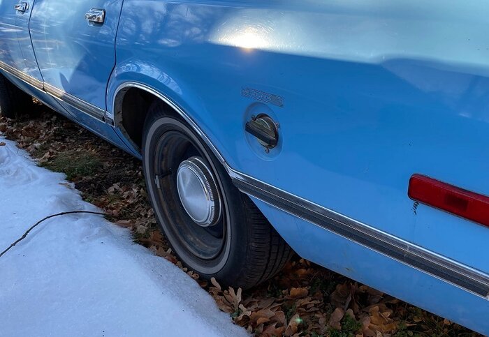

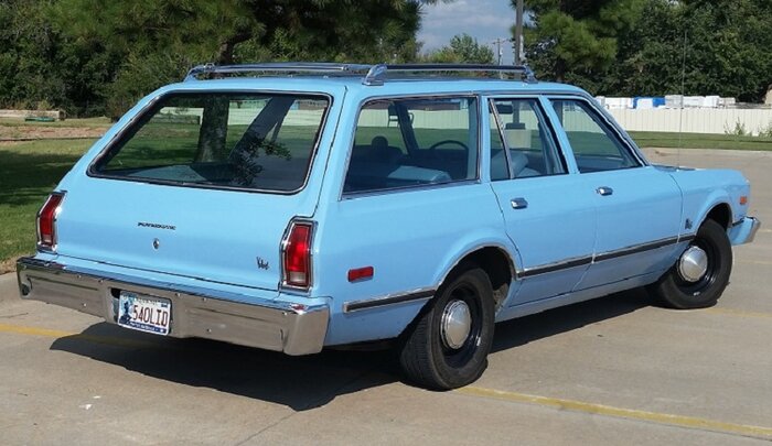

This is not a great shot but you can see the rear wheels could come out more.
This using the factory 14" wheels and 195/?r14 tires (not sure of the second number). The car currently has M-body 15" factory steel wheels and 215/70r15 tires (not pictured) - but there is very little difference on the look. The tires, above, are too short for the car, but takeoff performance was great (and speedometer was off, a tad). The 215/70r15's are a tad too tall for the car (and speedometer is off, the other direction) - but both cars share the same tire (and wheel) now.

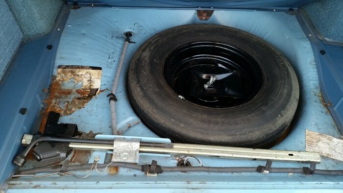

My wagon has the hump gas tank and different trunk pan - so I can't get a full size spare (215/70r15) to fit. The original 14" Firestone Firehawk polyester belt tire fits just fine (hehe) with its 5 inch wide wheel (which is only 45 years old).
I need to update the trunk pan so I can fit a 15x8" wheel in it - by using a '78 and up trunk pan (and fuel tank).

This is using a 215/70r15 on M-body 15x6.5 inch wheel (which came with the same vehicle using wire hubcaps as used in post # 22).
The '80 and up FMJ differential will be 1/2 inch wider per side as this (or in your case 1/2 inch narrower).
