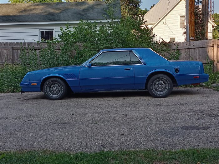

I just spent my weekend trying to get my aftermarket oil pressure gauge to work corry, turns out the dash speaker was causing it to misbehave.......now I'm waiting on parts to make the wipers work........ I should have just put the new torsion bars in and forgot the rest
80mirada
Sep 3, 2012
1,618
653
Wisconsin, Fort Atkinson

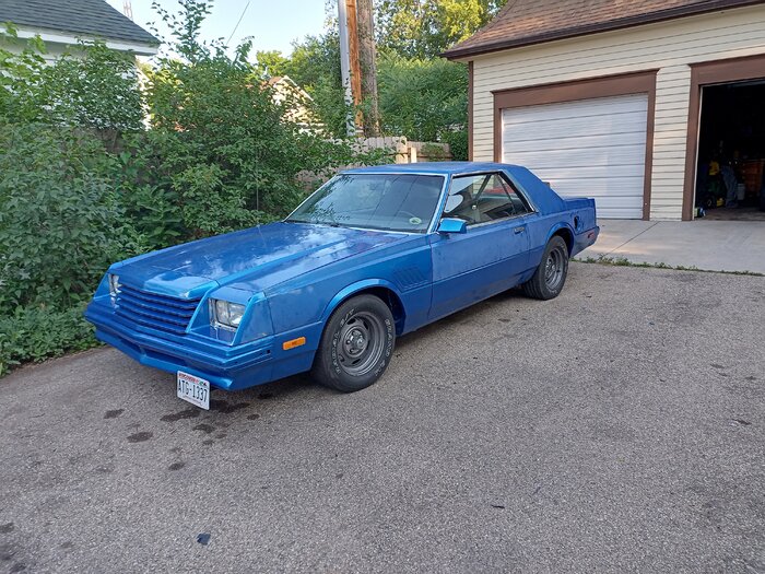

T-bars are in, Left rear tire going down.

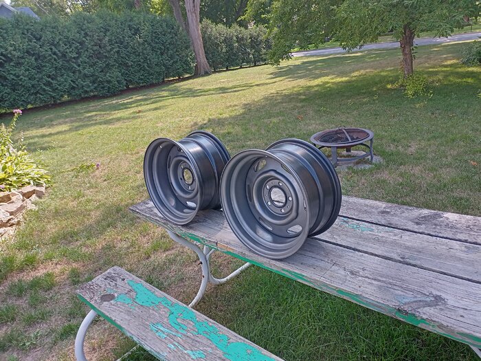

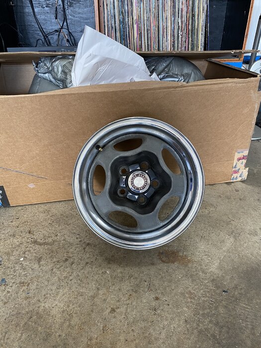

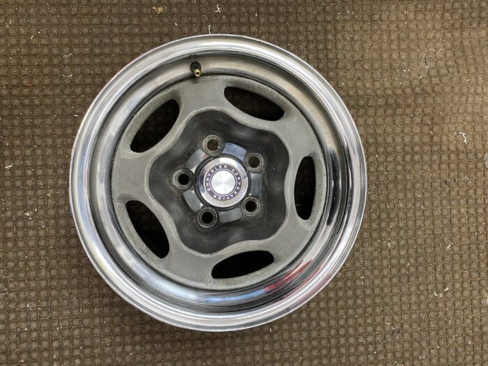

Is that dark textured argent on your wheels?
DCAspen
Sep 27, 2011
1,442
357
ct.
Thanks,looking for the right color to paint my Spyder Motor Wheels

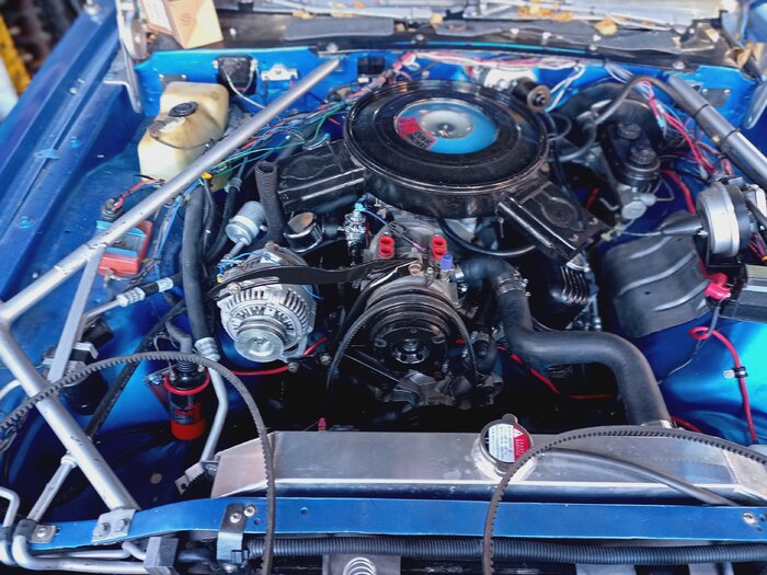

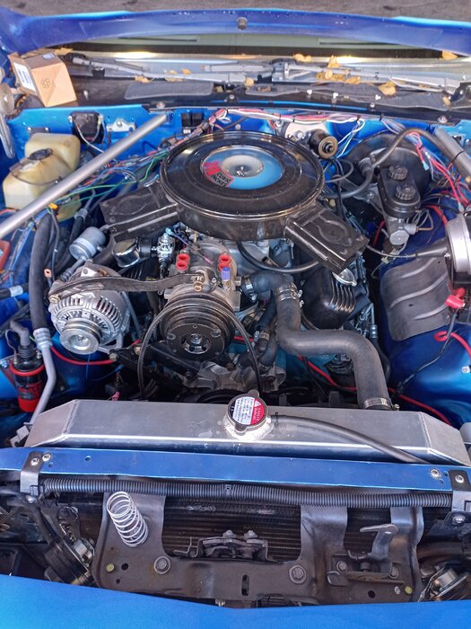

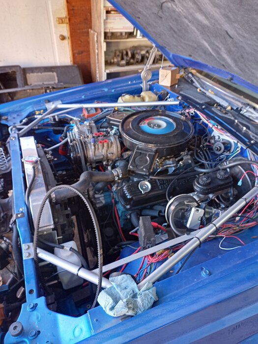

I spent two days chasing my wiring for the Overdrive. Finally got it working right, shifts automatically or with the kick of a switch. I just need to get the Overdrive kickdown figured out...
1,806
1,014
Does yours have lockup? Gets a little more complicated, but not bad. I have kickdown setup with a pressure switch on the trans and an adjustable vacuum switch under the hood. This setup will also hold 4th gear upshifts until a predetermined speed.
80mirada
Sep 3, 2012
1,618
653
I don't have the lockup, I just need to get the vacuum switch. I also need to adjust my speedometer a little more, seems to be about 5mph slow
1,806
1,014
Looks like it could have rolled off the line with that motor in it.
