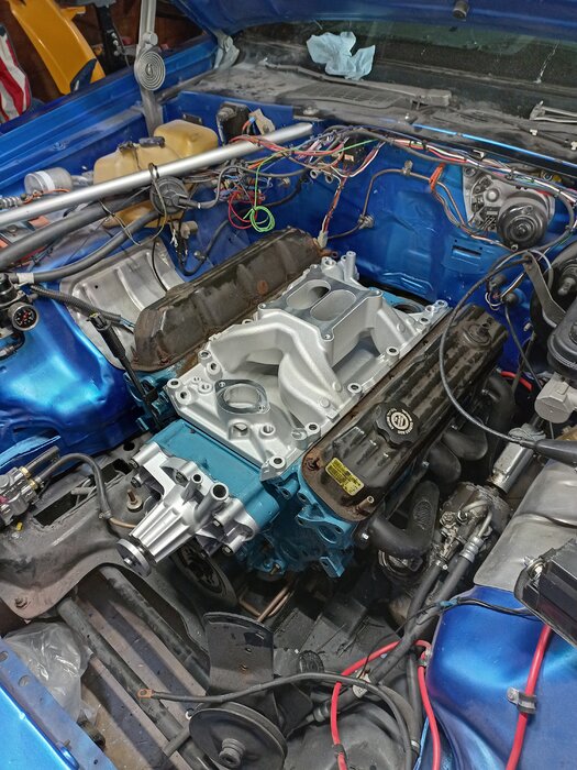

I installed a 90° adapter for the oil filter. The headers are so close to the frame rail I had to run an oil filter for my SRT4 inorder to get it in and out without removing the header..... damn it.
1,848
1,048
This is a bad photo for this, but you can see it on the side. Dad moved his oil filter up to the passenger side inner fender, where the vapor canister used to be. He made two of the brackets that the oil filter adapter is bolted to. I was going to do the same thing until I decided to go big block and the oil filter is on the driver's side.
If this looks like something you want to do I'll ship the bracket out to you for cost of the ride. Cheers.
